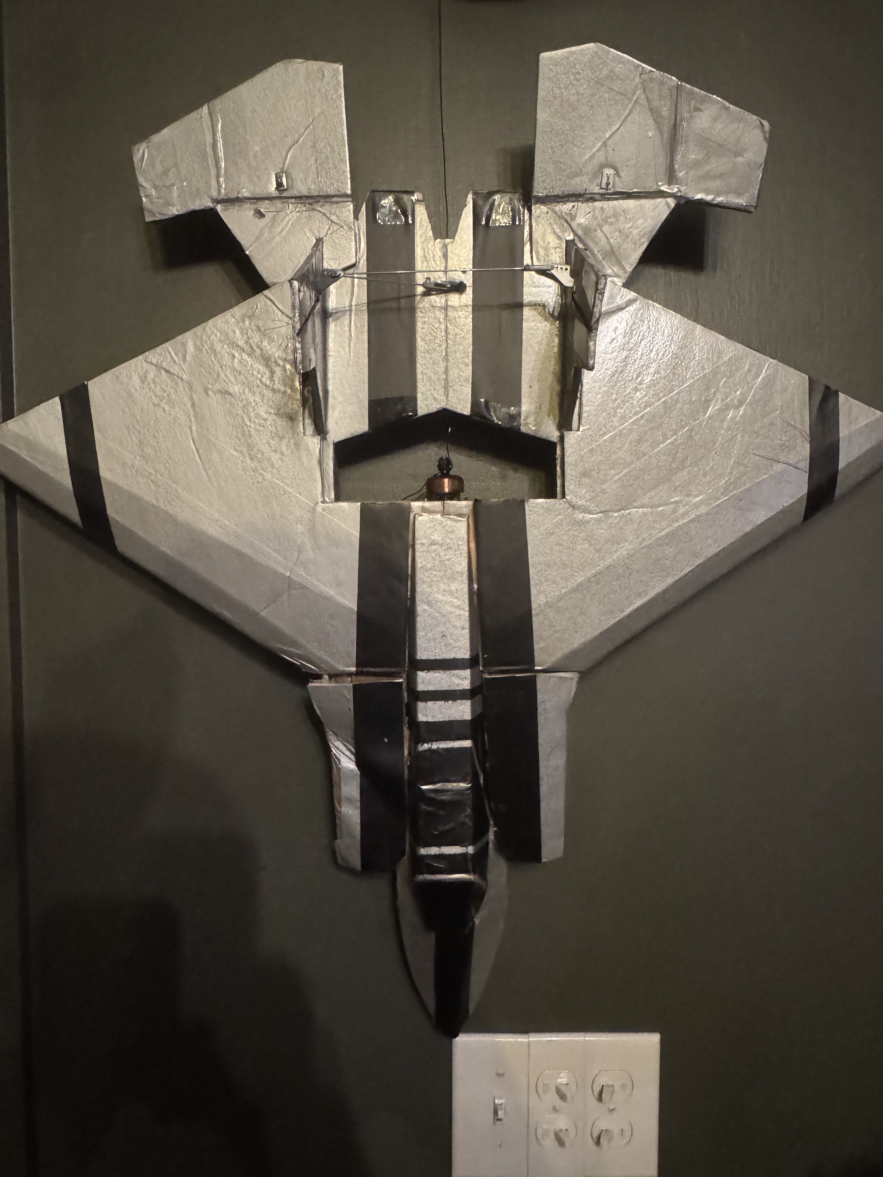

two updates:
one: lost another 2207 2750kv on 4s with a 5x50x3. this time i was pretty confused as i lost it immediately after launch, up, right hand u turn, over head, lift up right and it fell from the sky. i had to get a machete and cut thru about 200 linear feet of un passable over growth in a wooded area. i thought i lost telemetry, but when i found the plane the prop was 100% melted, all glue near mount was melted, the wood motor mount i built was burned, esc dead, graphene battery dead.
two: i am building an Alpha frame which which will be powered by a 2808 1950kv motor on a 5.2x60 with 3000 g of thrust. it will have modified wings to match Charlie with wing extensions removed (like in picture) and double layered all the way to trailing edge and wing tips. double layer vertical stabilizer, and double layer elevrons. i also built the motor mounts from wood. i honestly dont know what to expect, my hope is under run the motor while having enough headroom to cruise at 80/90 in hopes of not catching a plane on fire.

almost done with the 2808 plane.
this thing can run 4s-6s, my intentions were 4s, and I figured i would put on another 100 grams…holy crap i put on another extra 200 grams…thats all loaded up.
i have no clue what to expect on 4s as i can only find data for 6s.
the build is awesome, slick and clean, a solid wing, solid elevrons, solid vertical stabilozers.
still working out battery bay.

providing we get good weather tomorrow i am going to instal control rods and test.
loaded plane is 900 grams snd change, every other Alpha, Charlie, Bravo, Flerken i built was between 500-620 grams loaded. i thought i would land in the 750 gram range not just under 1000 grams.
however, see charts. i am going from roughly 1500 grams thrust to 2500+ grams of thrust. RPM is less on 2808 vs 2208, but hopefully there is so much torque the plane is just fixed in the air.
i was concerned running 4s would be a significant power drop, but it appears it will not be. first test will be on a 5.2x60 prop.
will get video snd a youtube channel soon.
so what do you all think? just judging of previous pics and info provided…is it gonna shred or be a tub…????
