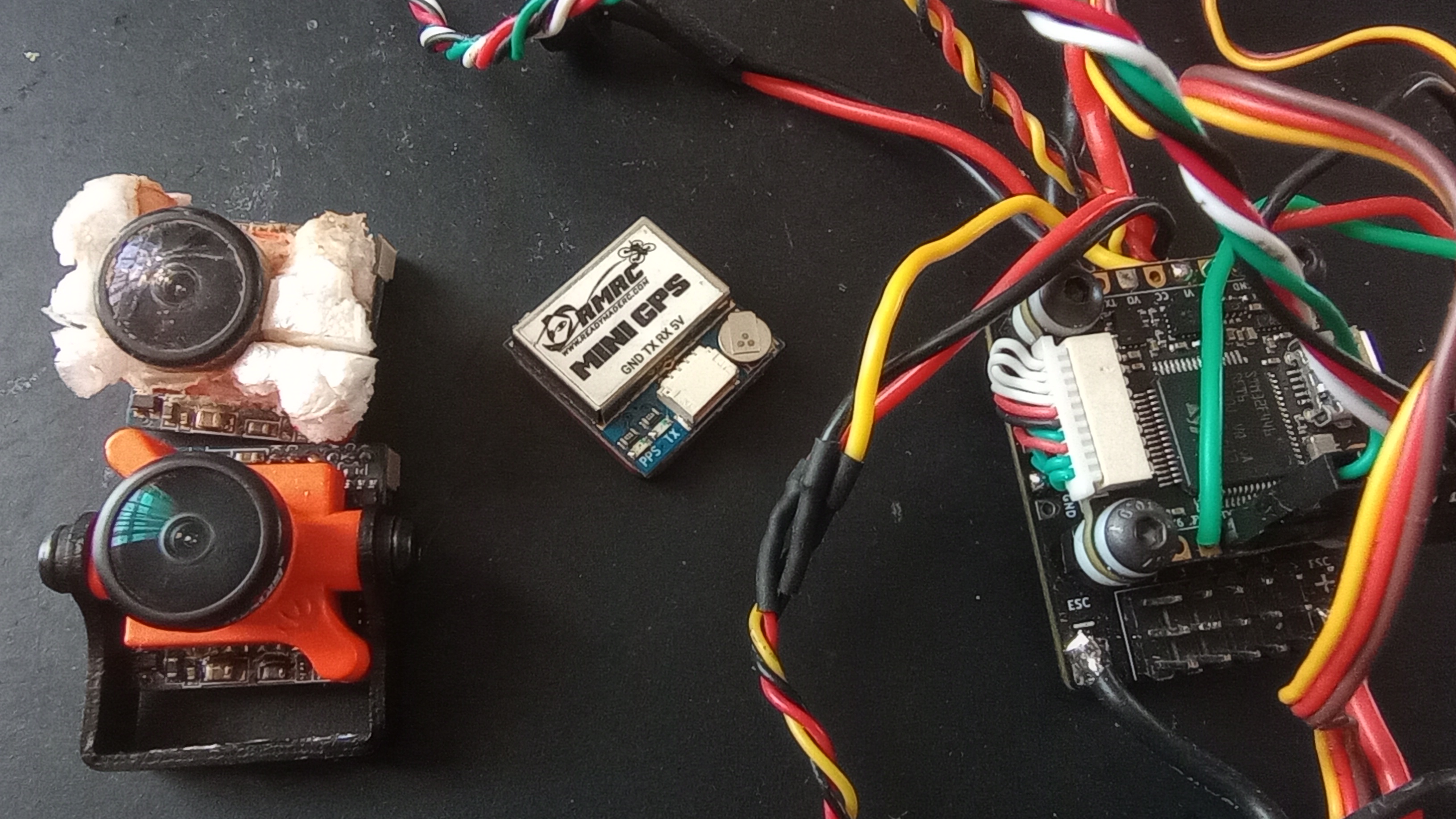

I have been a BIG fan of the Strix Nano goblin ever since it was released in 2017. I bought one of the original PNP birds when they became first available and flew it probably into the thousands of miles over the last seven years, Mostly FPV, till it's demise just before combat last year at Flite Fest. The original PNP versions were glued together at the factory, and whatever glue was used had begun to fail in various places. The final straw was when the control horns came loose and uneffective in a full speed dive.... No pulling out. Straight into a small rock, smashing the glass lens on the Runcam FPV camera, and obliterating the chassis. Having INAV, GPS, and Radio telemetry allowed me to punch the GPS coordinates in my phone, and walk back out to the point where it impacted to retrieve the electronics that I had missed when picking up the EZ 2 Find white pieces. i've actually flown the GPS and Flight controller in a ZOHD Drift since then.

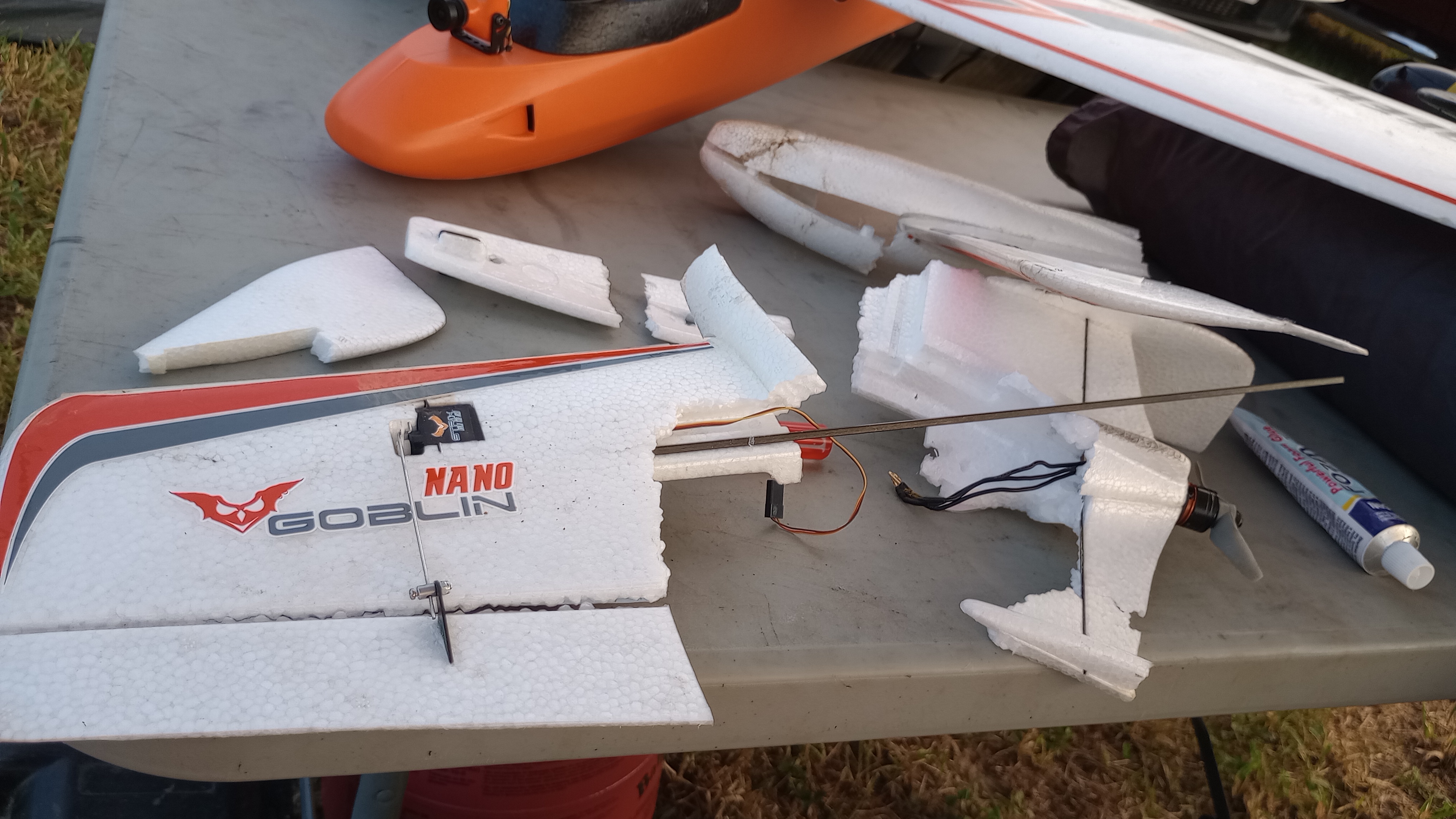

This was the OG pictured above after coverting it from a PWM reciever and AIO camera to a FC running INAV and component FPV gear. It was flying fine till I switched it in to AutoTune. At that point it locked up in a roll and the only control I had was the throttle. Just missed the parked cars and went into a fence post behind the field. I even started at 300ish ft which is more than three mistakes high, but could not regain control. The whole nose was knocked off into about 20 pieces. Glued it all back together and it flew another five years till last summer.

This was the OG pictured above after coverting it from a PWM reciever and AIO camera to a FC running INAV and component FPV gear. It was flying fine till I switched it in to AutoTune. At that point it locked up in a roll and the only control I had was the throttle. Just missed the parked cars and went into a fence post behind the field. I even started at 400ish ft which is more than three mistakes high, but could not regain control. The whole nose was knocked off into about 20 pieces. Glued it all back together and it flew another five years till last summer.
I don’t understand any of this…
This I do.

I've test fit a few different Walksnail cameras. The Nano cameras (14mm) are a bit on the small size, and the Pro camera (19mm) is a perfect fit. Leaning tword the pro camera on a single antenna V3 VTX. That will give it native gryro stabilization and MUCH better low light capability.
