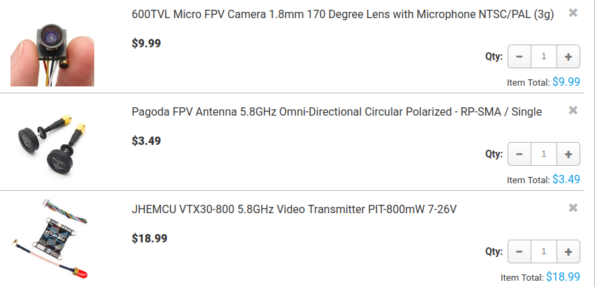

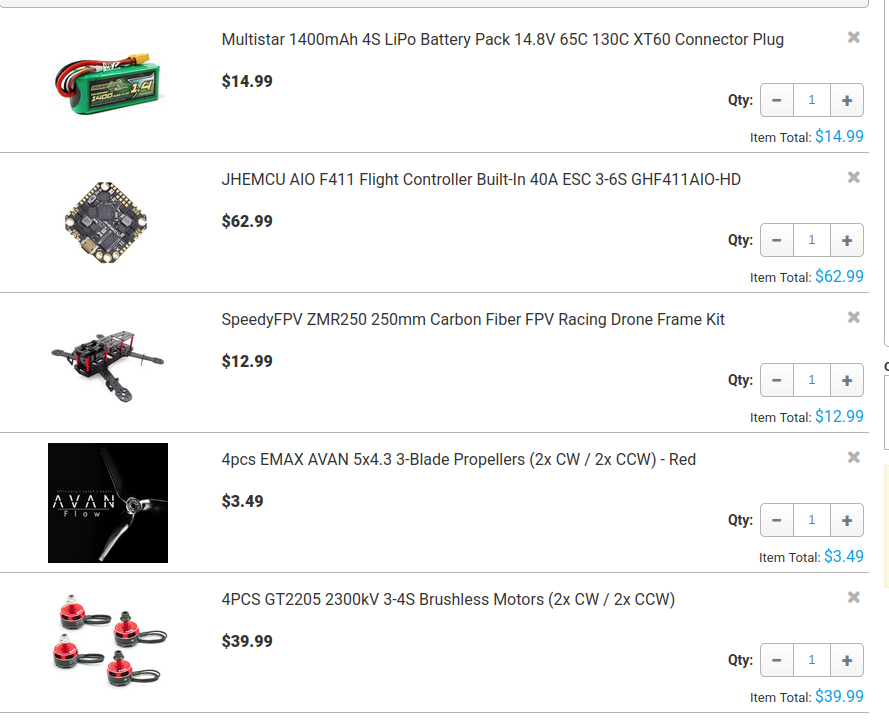

Here's my list so far. what do you guys think?

I don't know if that would work very well outside:unsure:unless you had zero wind
I’ve flown a friends Mob 7 outside in moderate wind and it was just fine. A Mob 8 would be better. I’ve been flying for a couple years and five inch drones still unnerve me. I wouldn’t have wanted to learn on one. Plus, being able to play and practice inside is a big benefit. Just a suggestion!
How fast do they go? (mobula) You can limit the throws on a 5" in betaflight right?
