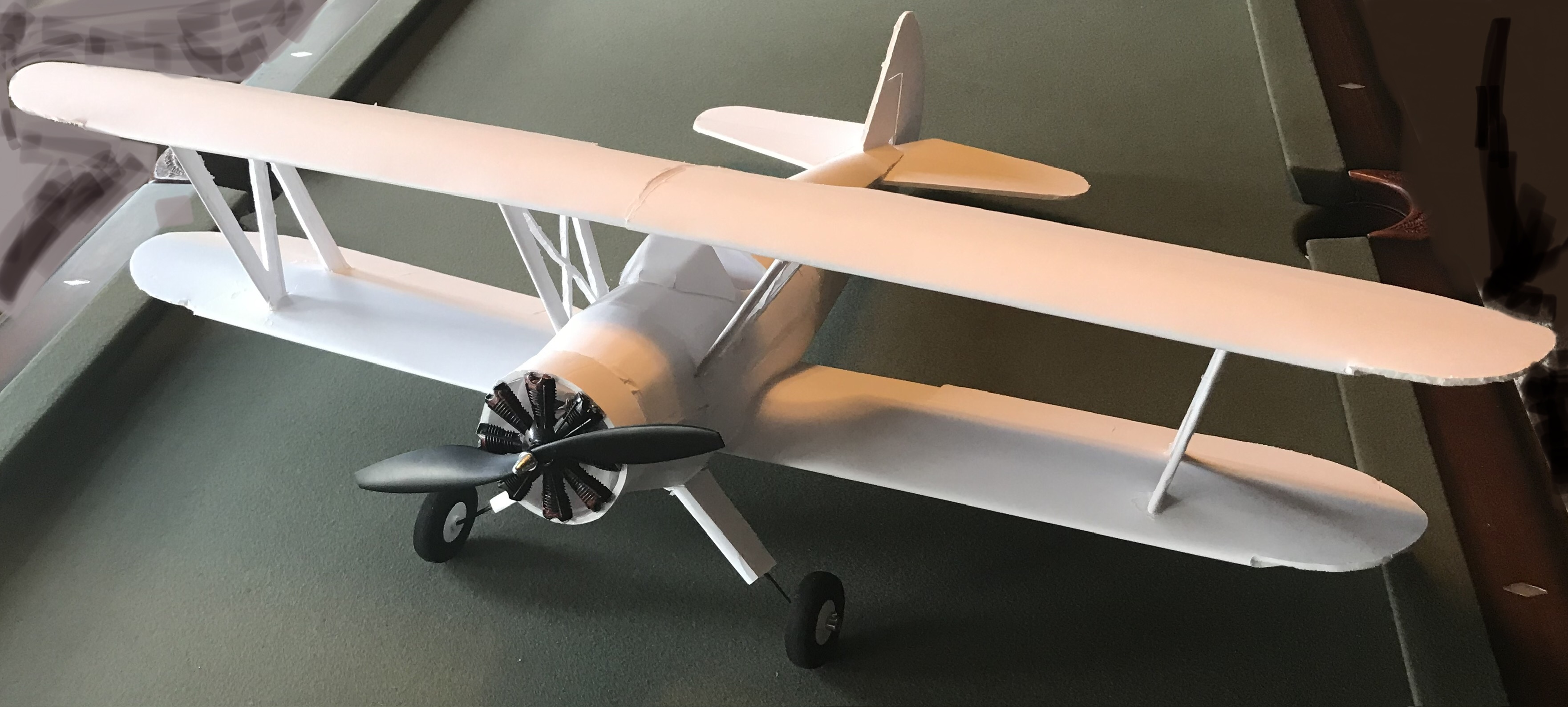

Glad I came and checked this thread. Just finishing mine and it is also very tail heavy but under weight, so I'll throw a bunch of lead into the nose. I thought I did something wrong.
Flying Farm Kid
Nope they are always just tail heavy on my next one I am going to make the battery compartment bigger so I can take advantage of that with a bigger battery and then longer flite time.
paradawks
I added a few ounces at the firewall and got it to neutral or maybe very slightly tail heavy with a 2200mah 3S pushed all the way to the front. Flew nicely, didn't even need trimming. For anyone else building one, I used a DYS 2836 1100kv motor, 40A ESC, and a 9x6 prop which I'll probably swap out for a 10x5.

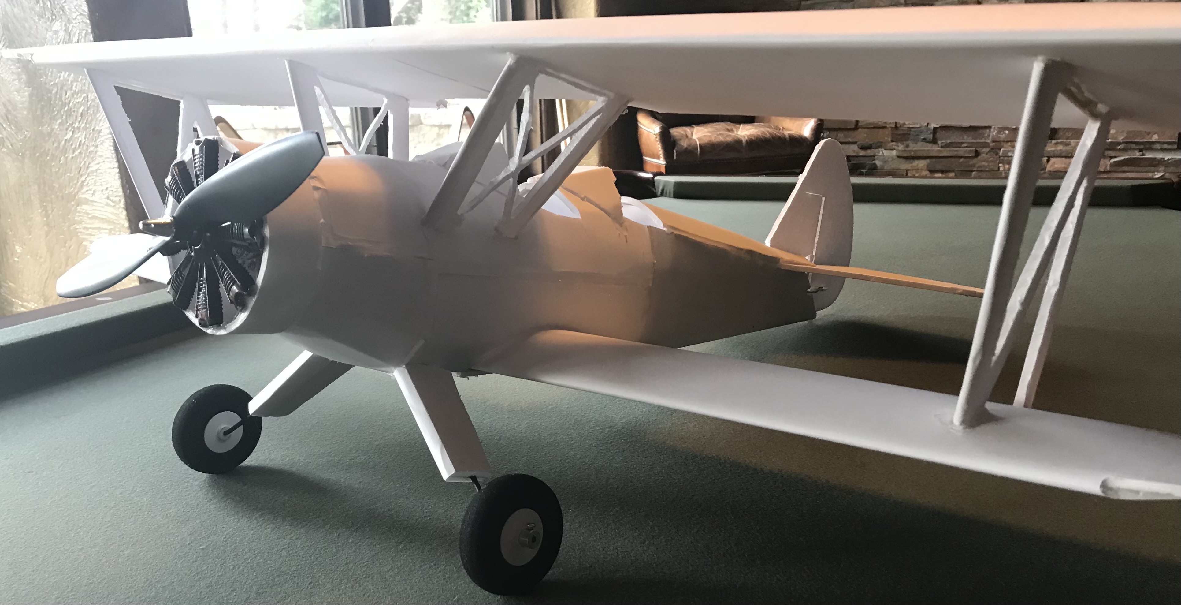

All done! Or sure if I’m gonna stick with that faux engine, but it works for now, decided to run a 2212 1450kv turning motor
Nice!! Now I want to build one:sneaky:
