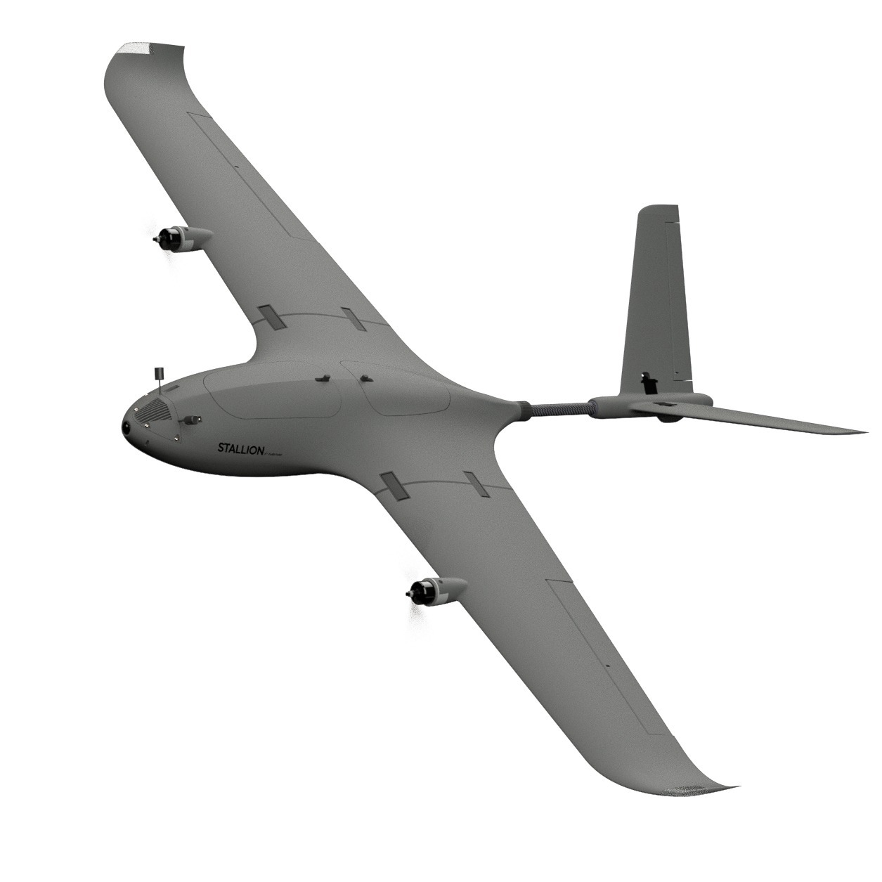

This is typical. I have several other unfinished 3d printed plane projects and here I am starting a new build.
This will be my first one from this company.

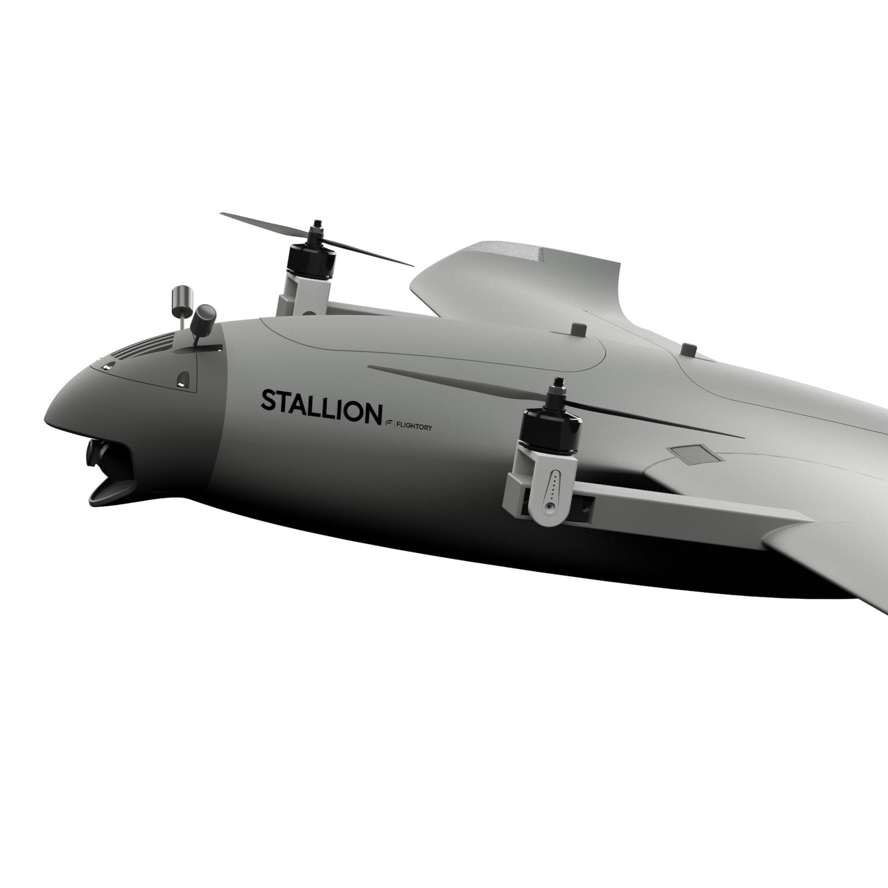

They have several fixed wing FPV designs but the one that caught my eye was their Stallion. They also recently came out with a kit to make it VTOL.
You have to have both kits if you want it to be VTOL but what I did is just buy the VTOL kit which was only about $9 with a 30% discount code that they published on social media. This consists of a new wing, booms and tilt motor mounts. I figured I'll print these first as it will allow me to dial in the slicer settings.
