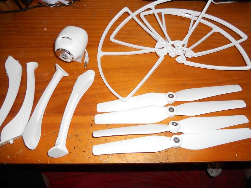

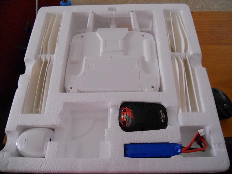

Inside the outer box is the typical molded polystyrene protection box with the new quadcopter taking up the place of honour, and a small box containing a power supply unit. Under the main quadcopter body are the four prop guards.
On the underside of the inner box are the transmitter, the props (8 in total), the landing gear, the charger, the battery, the camera and a small bag of screws with a small screwdriver, along with the other small parts.

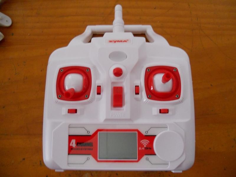

The transmitter is very similar to others of the Syma X5xx range of quadcopters, although it stands out in its white with red trim. It is comprised of the standard 2 gimbals, 2 shoulder buttons, the left to change from low to high rates and also to activate Headless mode, the right to activate the flip mode, and a bottom screen displaying information like what rates are activated and the state of the gimbals. One thing that this transmitter has which is a small detail but a huge bonus is the eyelet to catch on a transmitter neckstrap, making it a whole lot more comfortable to use out in the field.

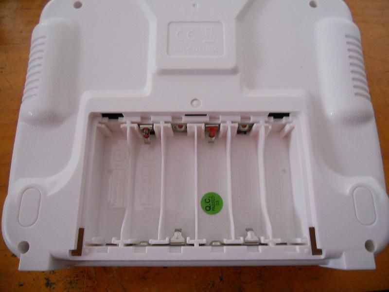

On the back of the transmitter you find the typical battery cover, and one curious thing is that there is space inside for 6 batteries, although the transmitter itself only uses 4 AA type batteries. It seems that the transmitter was originally designed to be used with more power hungry setups, and Syma just took advantage of the mold to use on this transmitter, removing the metal contacts from the 2 outer battery slots.

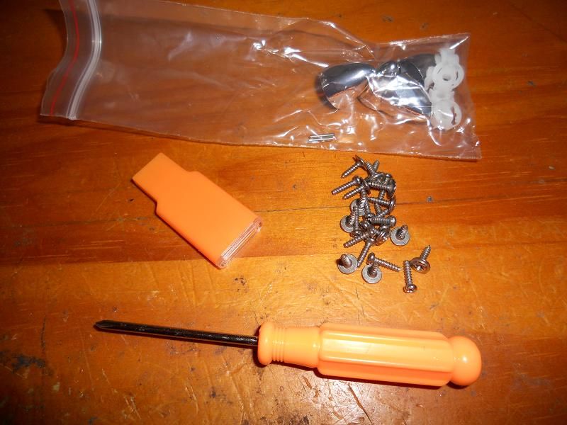

Inside the bag of small parts are all the screws needed for mounting the legs, prop guards and other things together, as well as plenty of spares of all these. There is also the small screwdriver for fitting it all together, as well as a USB microSD card reader which is something very useful and often missing from most models… something very much needed by people that are just starting out in the quadcopter world!!

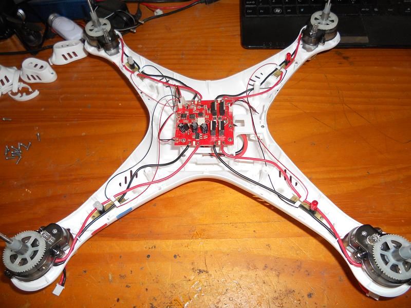

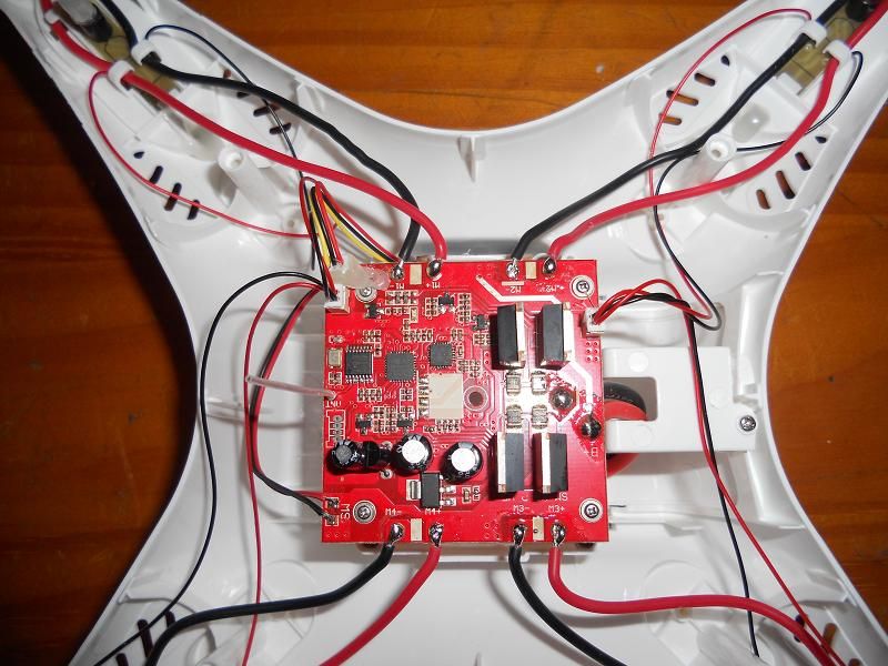

Before putting the quad together, I decided to take it all apart to see how the internal construction is. The plastic is very firm and rigid,and everything seems well placed inside to fit neatly in its place. There are a total of 16 screws holding the 2 halves together, but you must remember also to cut the stickers on the forward arms to separate the 2 halves. There are an aditional 4 pieces you have to remove to reach some of those screws, which are the motor covers, and each one of these is itself held on by another 2 screws. Inside everything seems well thought out with all the wiring neatly sorted into their places with good quality cable going to the motors, smaller gauge wire for the LED clusters on each arm, and all going to a central control board, which boasts a secondary board for the on-off button and the camera jack socket.
The board is a lot larger than the Syma X5SW board, although it comes with the same common elements. On top of the typical receiver, decoder and 6 axis stabilization circuits, it also has a 3.7V power regulation circuit to feed the camera with, which of course adds to the overall size of the board. The soldering points seem very well made and the components all appear to be pretty good too, with no obvious cold solder points or bad quality soldering.

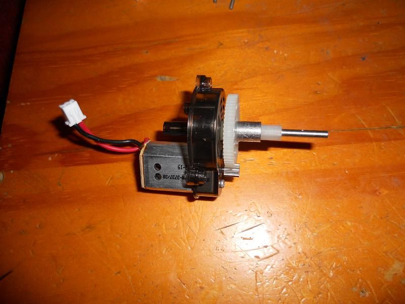

The motors are large and seem pretty good, using a very well designed and protected gearing system instead of a direct drive, allowing them to turn much larger props. The gears are well housed away from dust and dirt, yet still remain well refrigerated from the airflow from the props themselves. It seems someone took their time to design an efficient system to get the most from these brushed motors without sacrificing their lifespan. The motors themselves even come fitted with small SMD type capacitors to help filter out any parasitic noise from the wiring, so someone certainly did their homework!!
The motor mounting system has also been well designed not only for its general working but also for replacing parts should you need to change a motor. To change one of the motors you don’t even have to take the whole quad apart. Just remove the motor cover, unplug the motor from its base with the handy plug system it brings, remove 2 screws from the top side, and the motor slips out from its housing. This makes the whole system a real “plug and play” on the workbench!!

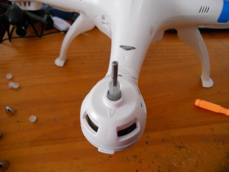

Once the 2 halves are back together, I proceeded to fit the lansing legs, which was a very easy system indeed, and the props… this is where I found it rather interesting. Instead of the normal “stab on” system of toy grades, or the screw caps of hobby grade, this system has a hexagonal part coming up from the gear which the prop fits onto very nicely. In the middle of this is a fixed metal spike with a hole going through it.
Once you have fitted the prop in its place, you have to add a small nylon piece on top, then a metal bar through the spike, then the nylon piece turns 90º to lock into place. Then you just have to put on the plastic cone ontop which is for aesthetic reasons more than anything, but this piece remains fixed, not like other quads where it turns with the prop. It is quite a curious system they have devised here for this quad, and it works very well. The small nylon pieces and the bars are easy to lose, so a complete spare set comes in the plastic bag together with the screws.
The prop guards also have an interesting mounting system, as each arm has a resort in the side for it to slip into and fix into place with 2 screws from underneath. If you decide to not use prop guards, rather than just leaving the slot open for dust to get into, and leaving it rather ugly, Syma have included some small covers that slip into the slots to cover them up and give the quad a nice finish. It’s a nice little detail they thought of here.

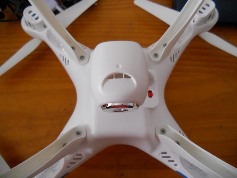

Finally, the only thing left is to fit the camera in the slot under the belly of the aircraft, and plyg in the 3.5mm jack that comes with it, a very different system than what comes on the other Syma models.

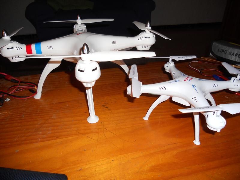

I compared it to its smaller sibling, the X5SW, and as you can see most of the things are the same, just scalled up enormously. But even details like the battery compartment and the general design have been kept constant in this larger model. When I got the X5SW it didn’t seem like a small quad at all, but now I see it next to the X8C it seems tiny in comparisson!
I weighed the X8C complete without the battery and no prop guards, and it weighs in at 483g (just over 17oz), which with the battery added brings it to a total weight in flight of 588g (20.74oz), making it the heaviest quad in my collection so far, and I really have high hopes for this quad, that its brushed motors really live up to the quads needs. People say it’s capable of lifting a GoPro, and if this is true, then it really is impressive for these motors on a quad with this weight to lift all that. It’s a shame I can’t put that to the test as I still don’t have anything in the lines of a sports cam :(

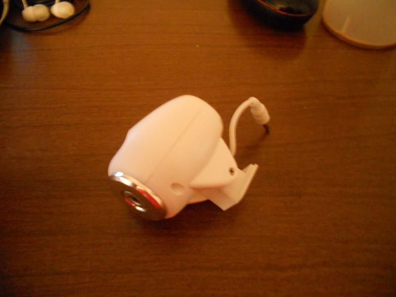

The camera on the outside seems pretty spherical, with a big chrome coloured bezel on the front with the red lens in the middle of this… seeing it in that way, it’s like a mix of the spaceship Discovery along with its onboard computer HAL from the movie “2001”!! The shape means it is quite easy to change the capturing angle without changing the actual aerodynamics of the quad. The sphere has a mounting hardpoint that’s pivoted on the top, and respiration vents on the top and bottom.
Opening the sphere up, we find inside the real camera, which is non other than the standard X5C-1 camera with a change of plug to a 3.5mm stereo jack. The camera is the typical 2mp one you usually expect, and also comes with its own set of refrigeration vents on it, as it can get a little hot when in use. I have hopes for this camera, as it is very similar on the indise, and the same on the outside as the DM007 one, and that camera gave quite good results considering its simplicity and resolution limitations. It might be possible to use the new DM007 5mp camera on this with either a change of plug, or making a 1.25 Molex to 3.5mm jack adapter which would be pretty easy to homebrew, and you wouldn’t even see it as it can be hidden inside the sphere part. If this is so, then you can probably get similar to 808 #16 camera images without any increase in weight or anything, meaning almost 10 minutes of aerial imagery
The interior main camera is held into place by the lens ring on the front, and the actual shape of the camera itself on the back, leaving the microSD card slot on the back with easy access when the sphere is back together. The camera also came with a 4gb microSD card included, which is great meaning you can take images straight out of the box!!

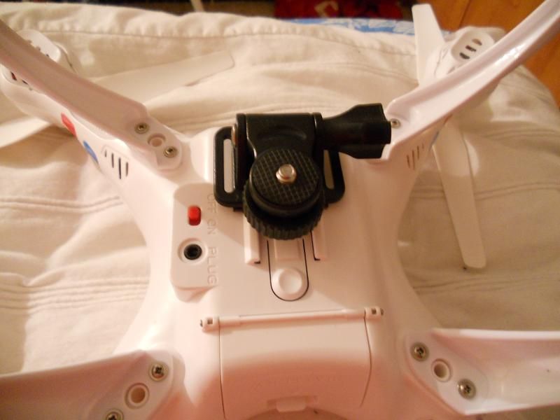

Actioncam support
The first "mod" I made was to include a support for various models of action cam, making it posible to use a higher quality camera than the 2mp one that comes with it. I found the support on Ebay, which originally comes with 2 straps to hold it onto a helmet or something like that, but if you remove the straps, it also has a double sided sticky silicone piece to stick it to anything, and it sticks REALLY well. The main base plate comes with grooves to cut it down to size where needed, so I just cut it down to fit in front of the camera support that’s built into the quad. Then I cleaned the plastic of the quad with a little alcohol, and stuck the base plate into place. Once you have it in place, the screw part of the support, the same system that tripods use (and the same size, so it’s OK to use on almost any camera) falls just on the centre of gravity.
The new support allows you to mount your ctioncam upside down, and you just flip the image in the software which most allow you to do. The main support can slide free from the base plate leaving it free to be used with the original camera should you wish to, and all you have to do is take the support foot off the original camera and mount it back into place backwards, so the end tabs are on the back rather than on the front, and then you can slide it into its correct position from the back, and the original retaining tab serves to hold it into place under pressure rather than a clip now, but it doesn’t come free at all.
The adapter is available on several Ebay online retailers at around €3, so it’s definitely worth getting as it tuens your quad into a much more useful AP platform for very little money!!
