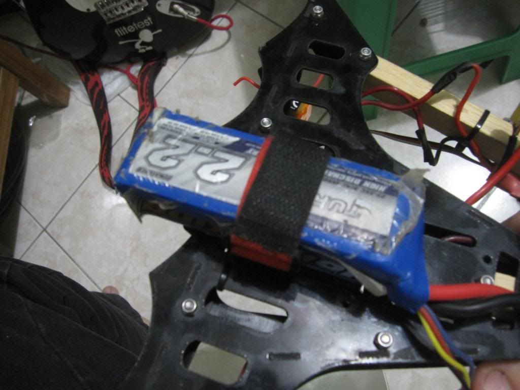

Specifically for the Bat Bone and a 2200mAh battery this is how I mount my battery.
As you can see it's not the way you would expect to mount it, but it solves the problem with no mixing. At least for me it does :)
