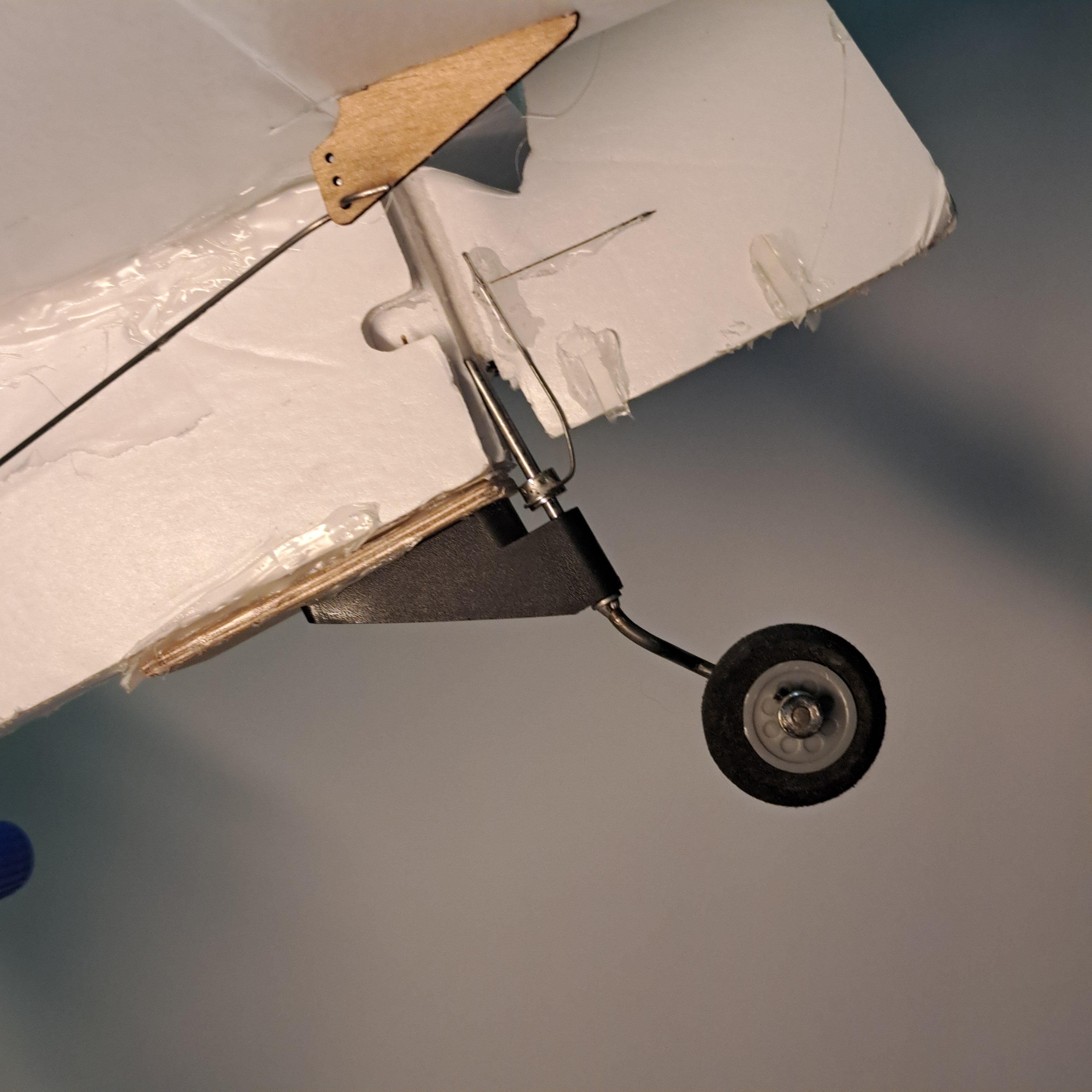

This was my Tailwheel solution on Tutor. It is still operation, though it is currently on the bench as I had to glue the plywood firewall back together after it delaminated in a crash. o_O
I cut a triangle of hobby aircraft plywood, I think 1/8", and solidly glued that under the tail. Then I screwed the tailwheel to that with the supplied wood screws. There's a small washer soldiered to the wheel shaft if you look close to act as a nice smooth pad that never digs into the plastic over time. I soldiered a piece of very thin wire (I think it's a piece of guitar string) to the retaining collar, bent it the way I wanted, and hot glued to the tail. I experimented with having it trapped in two rubber bands (see the leftover hot glue?) but that didn't work as well.
This arrangement works pretty good, and I can taxi pretty well. Occasionally I have to adjust it slightly so that it taxis straight without input, but since it's tied to that collar, that's easy to do. Just loosen the collar and move the wheel a hair. It doesn't have as much ground handling authority as I would like - crosswinds are an issue - but it works, and it was cheap. I don't remember where I bought that tailwheel thing, but probably Amazon during a sale. I got two, at the time, I think, looking for Mini Guinea nose wheel solutions.

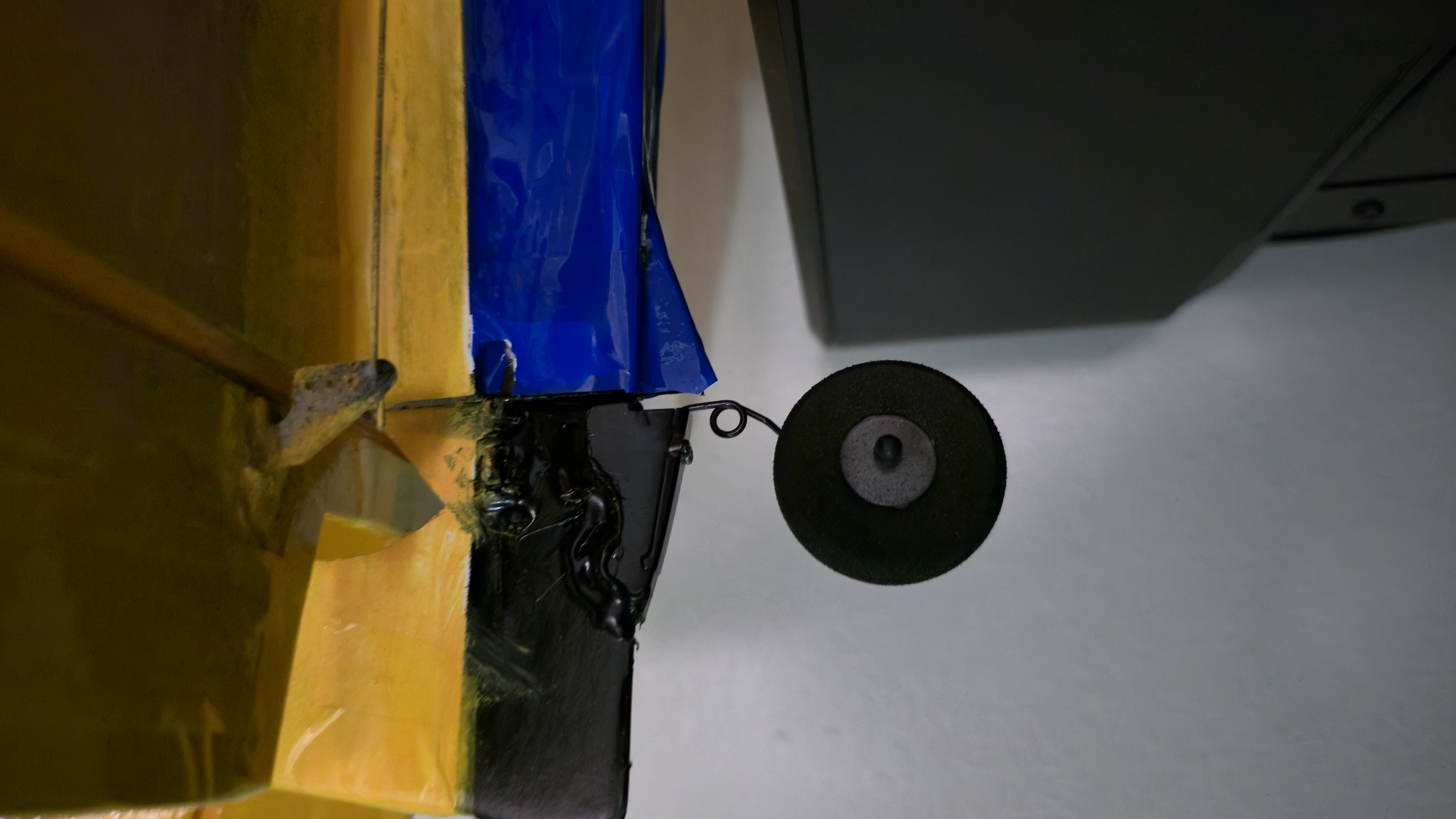

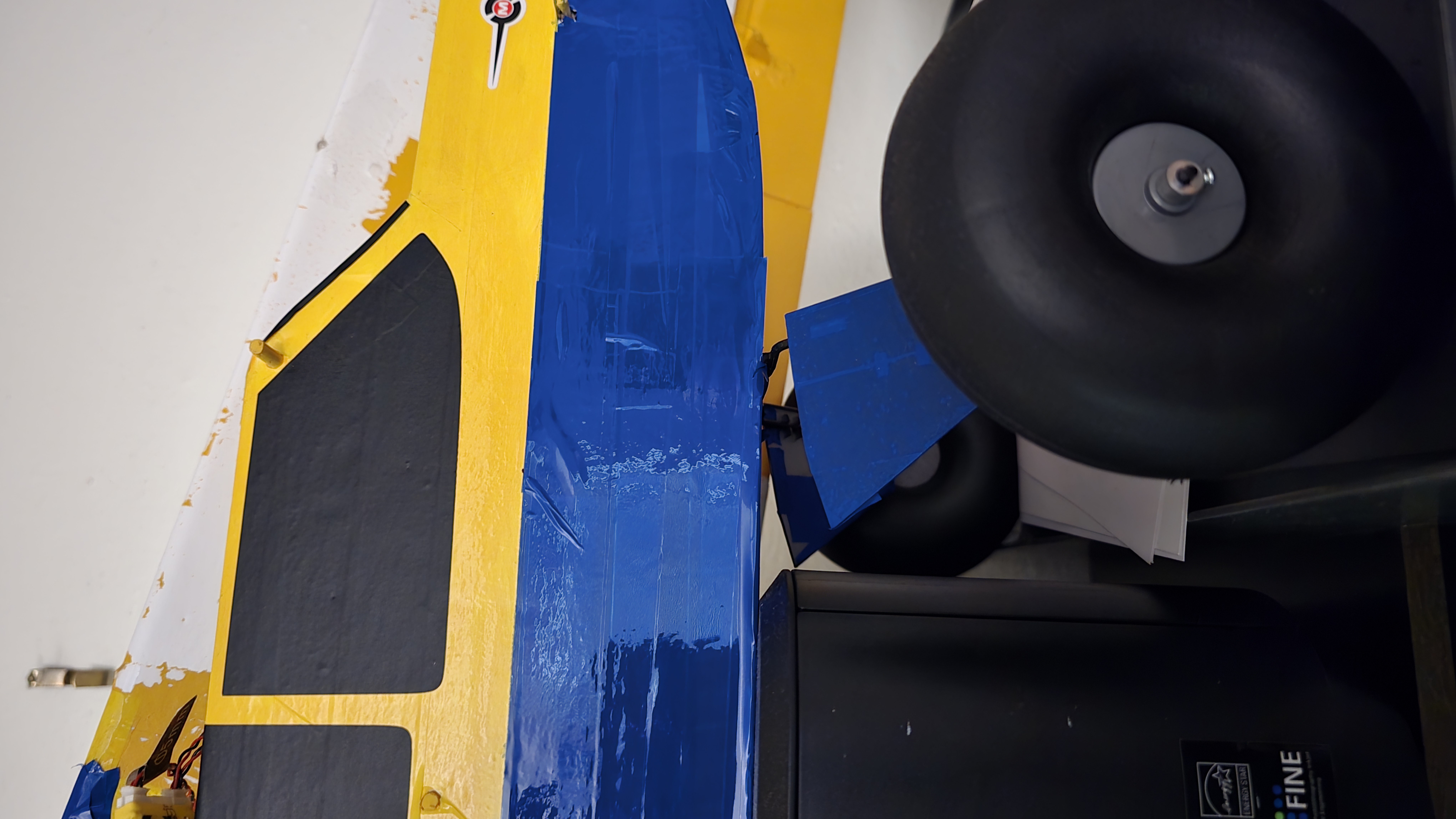

I went with the carbon Cub gear and it's very strong. Tail wheel is awesome too.

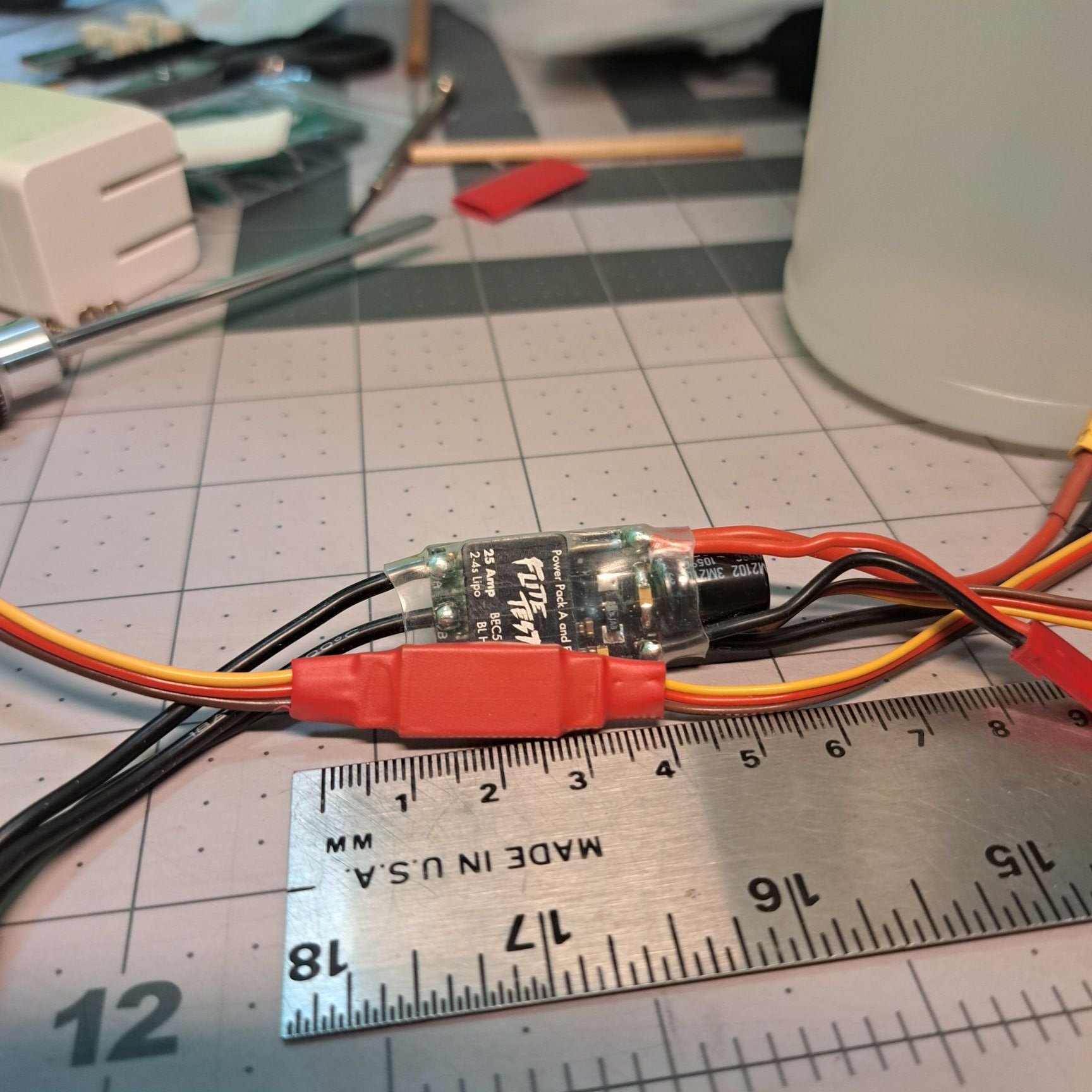

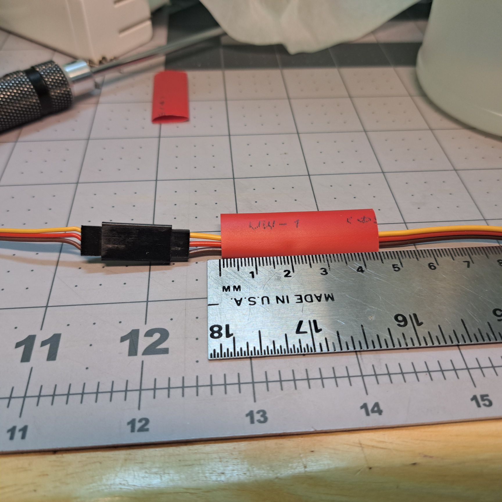

Here is a Fishbone's Air Quick Tip, which is neater and less bulky. It also takes up less cable, which might be important in some setups.
Take 4.5 cm of Heatshrink tubing that is just big enough to go around your connectors. The stuff I'm using said 08/4 on it. I bought it from the nice guys at the TGK connectors tent at Flightfest 2023 in a multiple sizes bag, and still haven't run out, but hopefully that helps with the size.
Slide it over the connectors, shrink it down, and I've yet to have one come apart. I'm, ah, not considered to be "gentle" with my aircraft, lol. Click on thumbnails if you want the large pictures. These are especially useful for servo extensions trapped inside of wings, where things are tight, and pulling the connection through you don't want it catching on things.
Capt Fishbones
