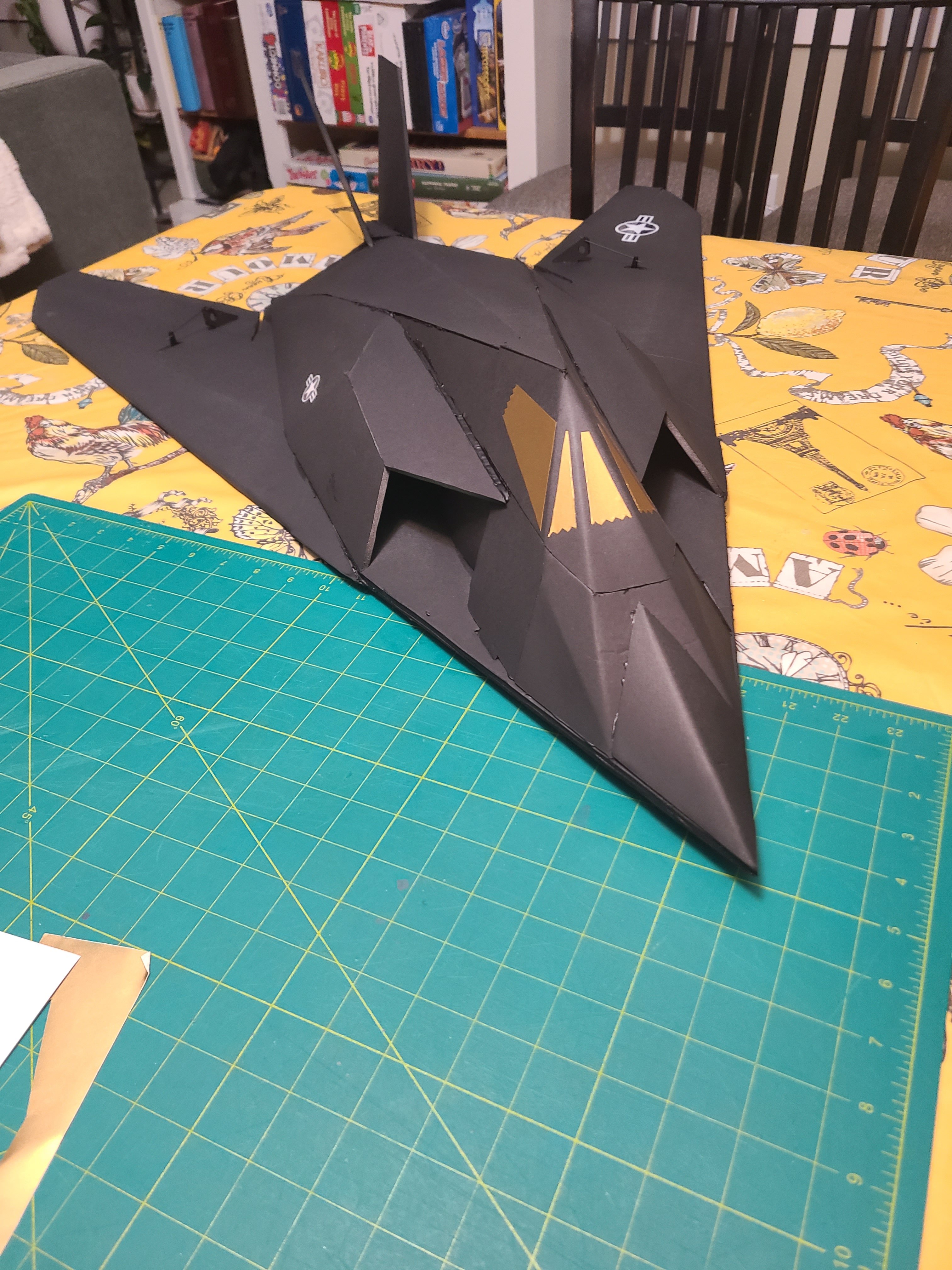

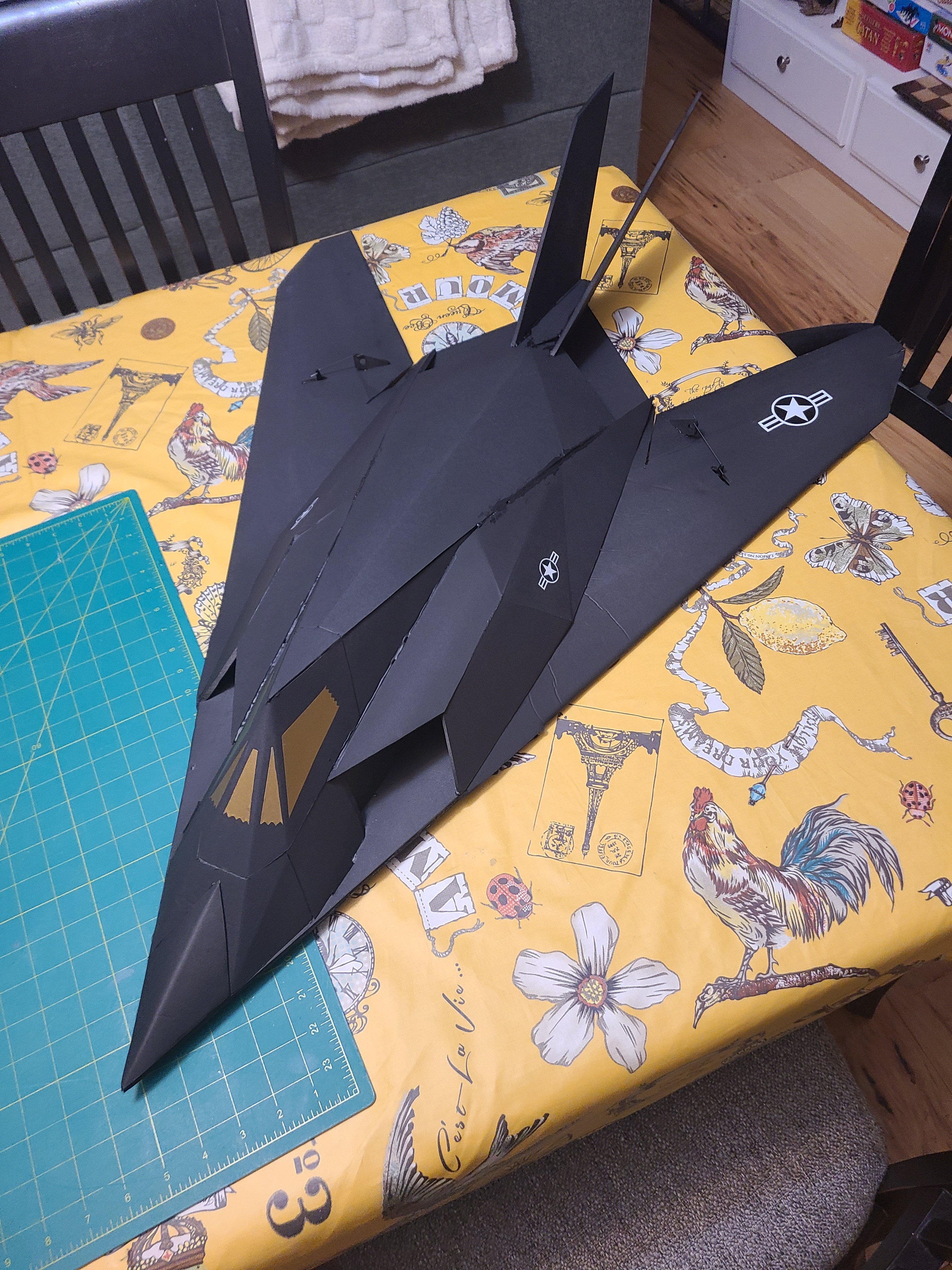

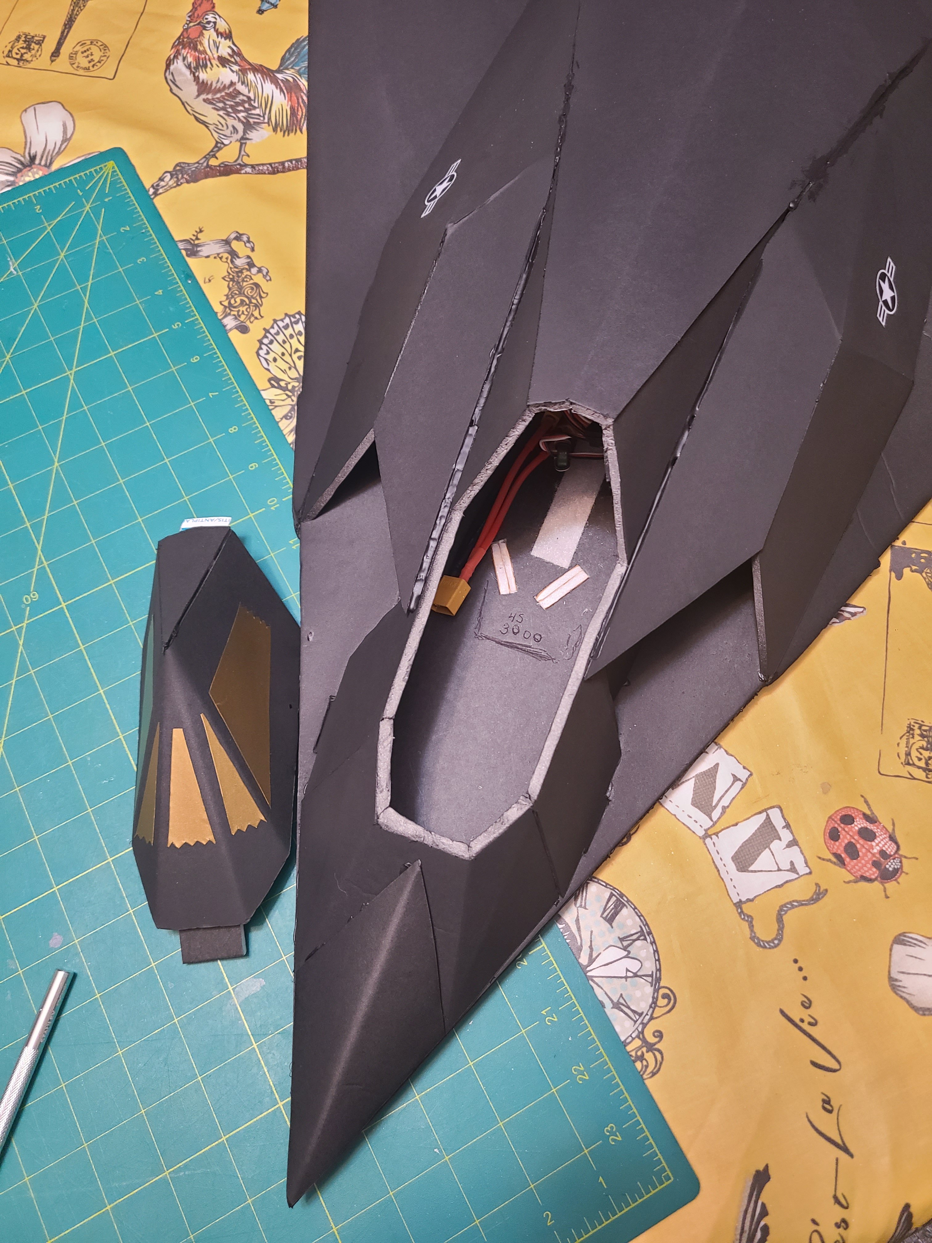

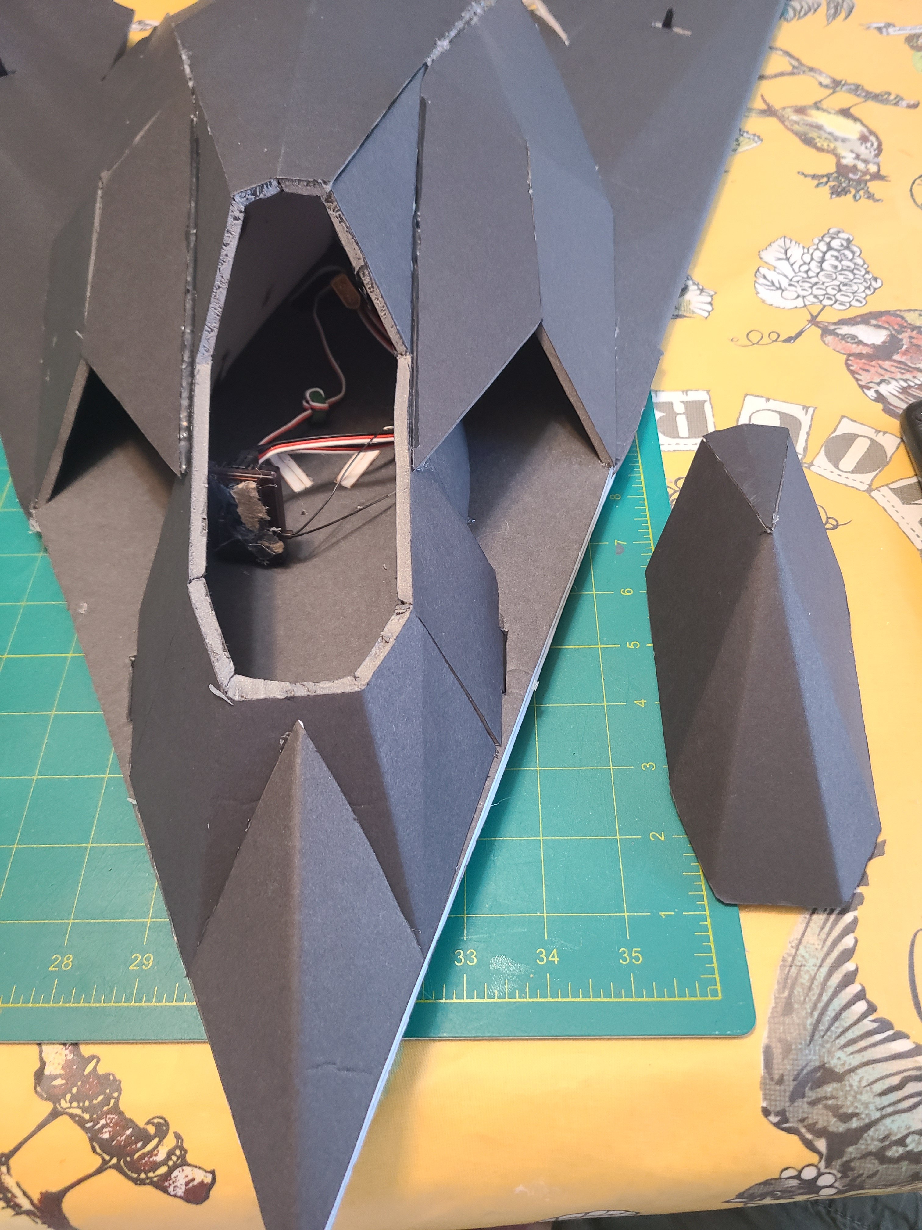

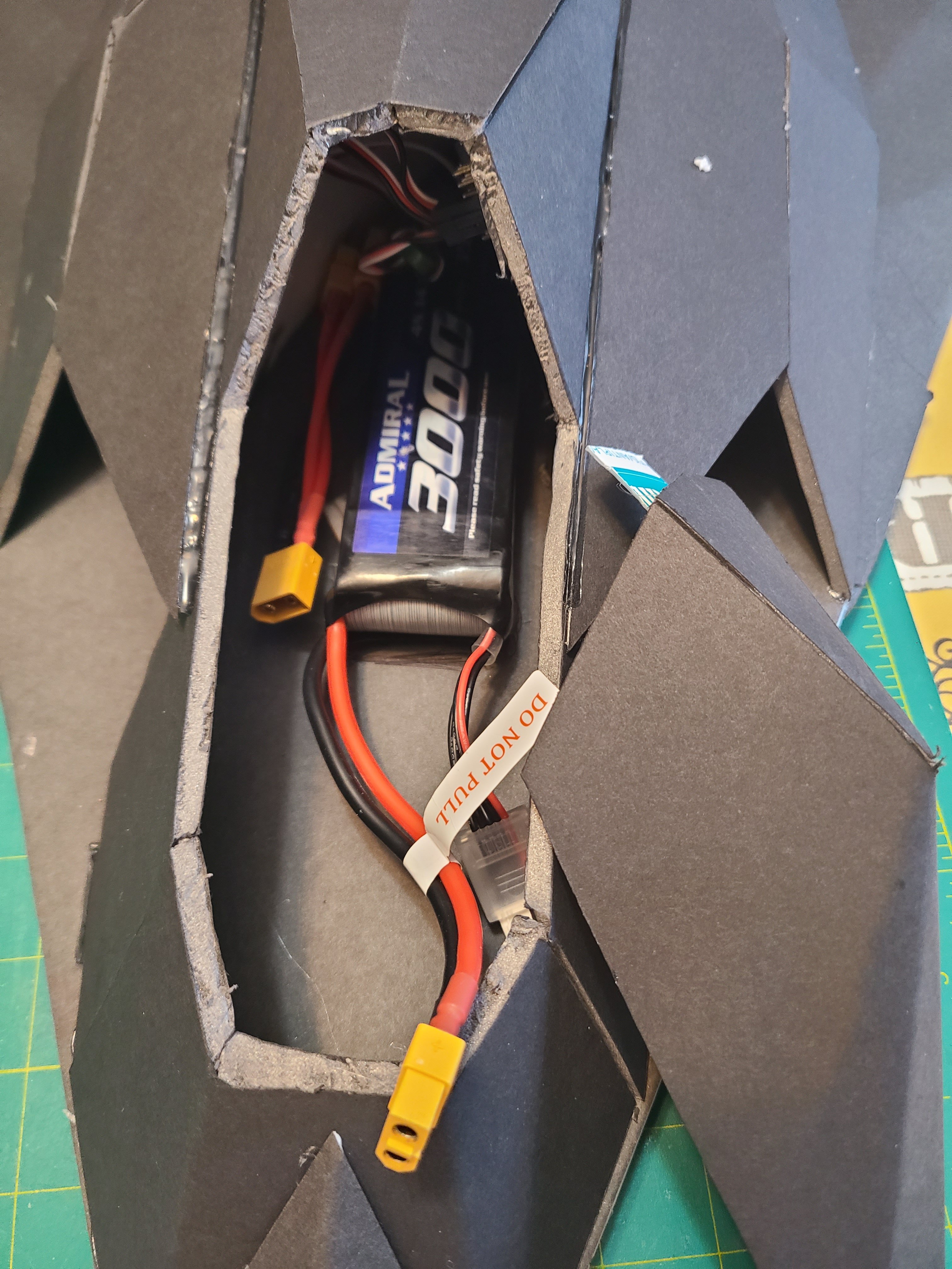

Here's my effort. Seems to balance at the recommended CG (17 9/16" back) with a 4S 3000 battery in the back of the space. I'll try to get footage of the maiden.
Suggest when you come in for a landing, keep the power on until almost there. With a 4S 3000 battery and a small area, watch for a stall in a turn if the speed is too slow. I used a 3s 2200 with a 5 bladed 64 and it flared nicely.
Don't know about your thrust/weight ratio, if low, think about using landing gear where your can gather speed to help get it airborne rather than chucking.
CrshNBrn
I took it out for a quick maiden this morning and the trickiest part was finding a good handhold for chucking. After a sketchy launch, it flew pretty well for not being dialed in very well. I did notice it dropped a lot during turns- speed is your friend with this one.
