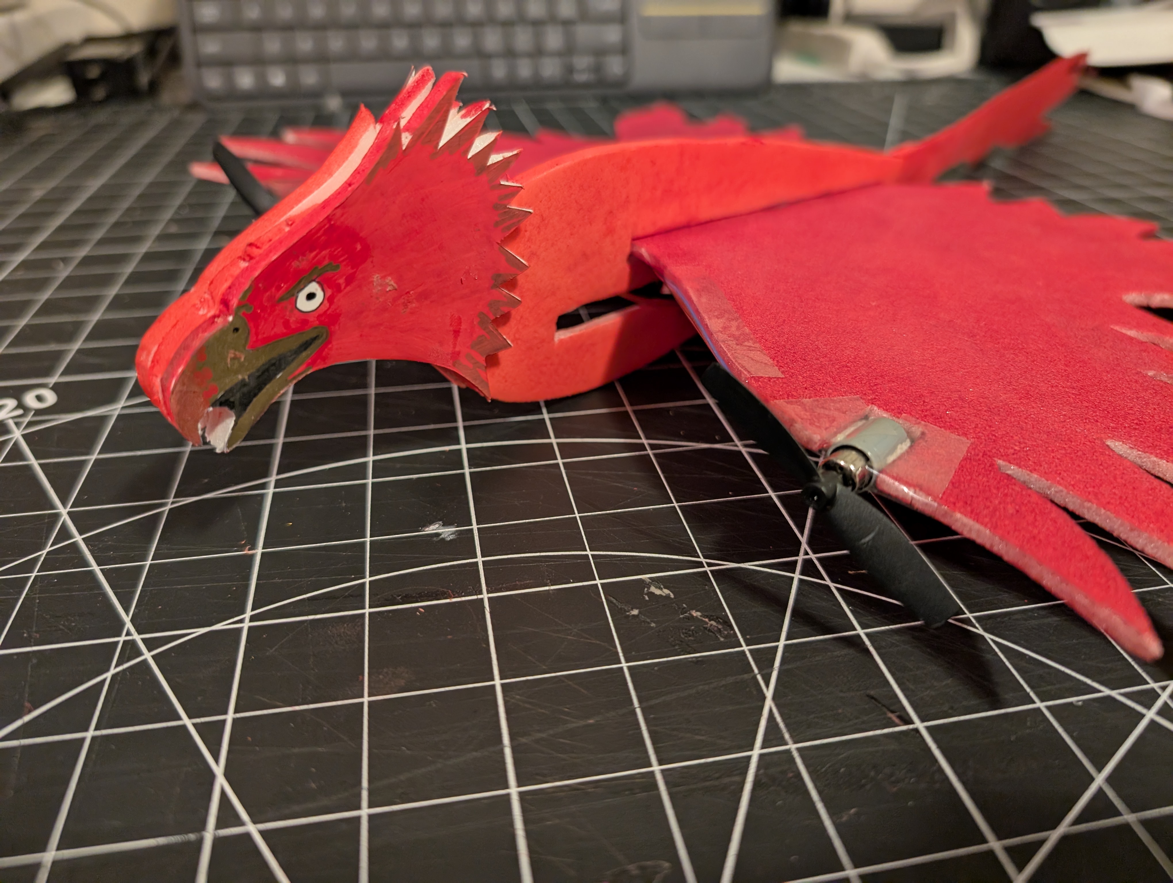

February 21, 2025:
- Built and decorated the FT EZ Pheonix. Was a fun build, I like the floppy tail.
Inserted the electronics.
Will maiden when the wind dies down!
