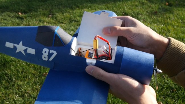

The Mighty Mini Corsair relies heavily on the use of poster board. This may seem complicated, but it is not! The internal foam board former makes building both quick and easy. It even makes a battery hatch possible. The final result is a simple little plane that is heavy on detail and features, but light and nimble in the air.

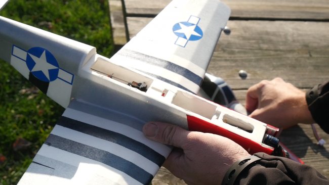

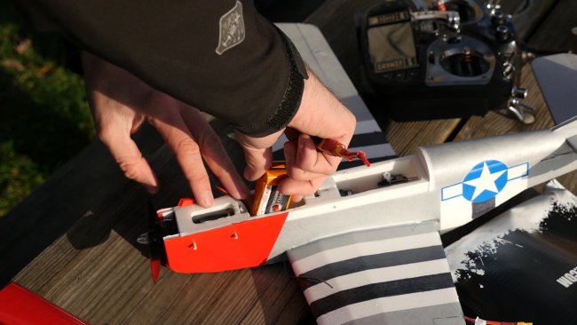

The Mighty mini mustang carries the same fun flight characteristics as its larger FT Swappable brother. We took what we learned from the larger design and applied it to the mini. The Mighty Mini P-51 features a rigid hatch that gives access to the servos, battery bay, and all the electronics. Both the Corsair and the Mustang fly great on a 2204 2300kv motor. This motor is available in our F Power Pack, or can be purchased separately. It's the same motor used in many race quadcopters flown today.
The speed and characteristics of the Mustang and the corsair can be changed by simply changing the cell count of the battery. A 2 cell battery yields 8.4 volts and makes for a fun and relaxing back yard flyer. A 3 cell setup will give vertical capabilities and bring speeds up to 54 mph (87 km/h). Install a 4 cell and you can expect to hit above 64 mph (103 km/h). That is, if the wind is in your favor! Be sure to match the proper prop with your battery choice. As the cell count goes up, your prop diameter goes down.

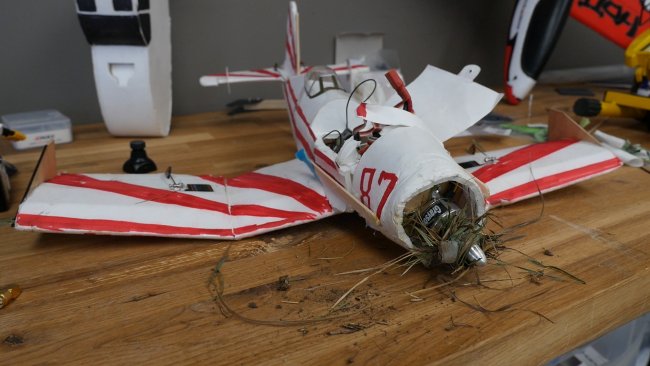

Peter decided to go big on cell count and small on wings. The final result was more useful as a gardening tool.
So Peter went back to his roots! Two big rocket motors and a fuse… Check!!!!
With about five seconds of fuse and our health insurance paid up, we lit and launched Peter's Rocket Corsair
The sound and the sight where very exciting! But the top speed will never be known. At least we were able to find the wreckage and also test the strength of the wing. Although you may not put rockets on it, we hope you will find tons of enjoyment building and flying these fun little warbirds. Remember. Planes are better when they fly together. And so are people!
