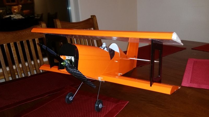

Finally got my Baby Blender finished yesterday. It's been sitting mostly done for a month waiting for paint. Decided it just needed some packing tape instead. Turned out pretty darn well for tape.
It's using one of my spare multirotor motors. A multistar 2213 935kv, 20amp ESC, 11x6 carbon fiber prop, & 1300mah 3s lipo.

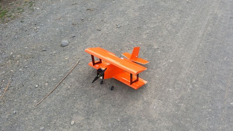

This thing is amazingly stable, took right off, and with a few clicks of trim I was able to fly hands off. Get a bit of altitude, hands off the controls, and it will slowly circle with no input. Roll rate doesn't compare to the duster, but this thing handles loops, rolls, inverted flight, whatever you throw at it. I even get 9-10min flight times before my voltage alarm sounds. I am very pleased with this one.
