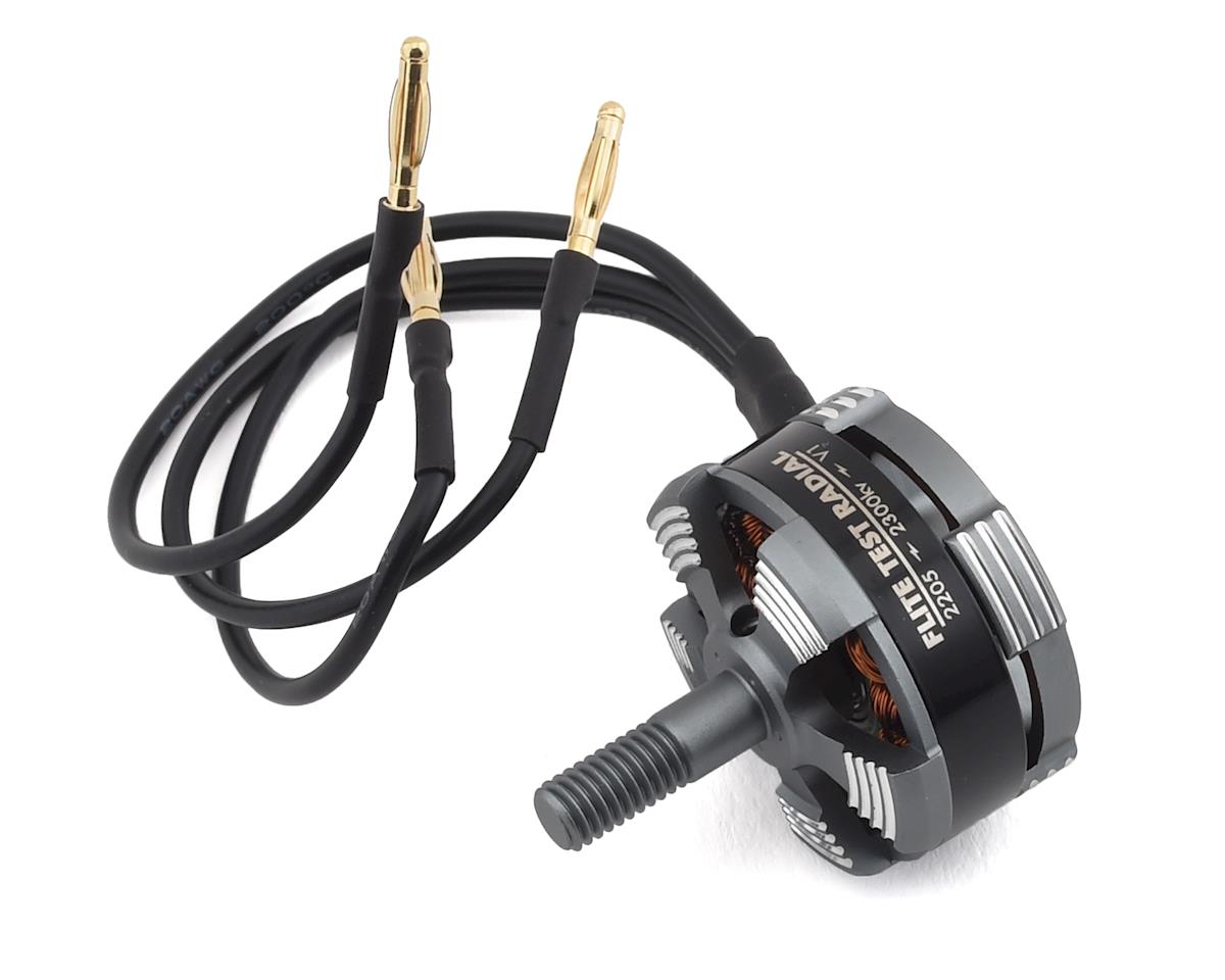

I am currently building my own plane from scratch using the Flite Test Radial 2205-2300 V1 motor. I lost most of the screws that came with it to mount it onto a firewall. Would anyone know the thread pitch, diameter, and length for these screws? Additionally, I was wondering if there is a diagram or sketch that shows the distances between the mounting holes for the back of the motor.

I apply transparent plastic to the engine, drill a hole and screw in the screw.Then I drill the next hole and screw in the screw. 2 more drills...As a result, I get a ready-made template for marking up for this engine. Your propeller is 6040, 5040 , you can take a 3-bladed 4040,5040. The landing diameter is 3 mm.
