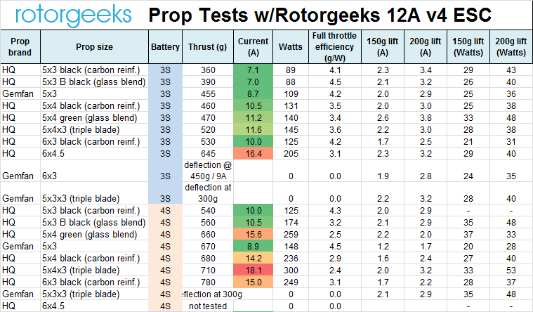

How do the 1806s do on watt and amp draw with 6x4 props? I think 6x4 are on the upper end of watt/amp range for those motors. Are they hot after a flight?
Found testing data here on Emax 1806
