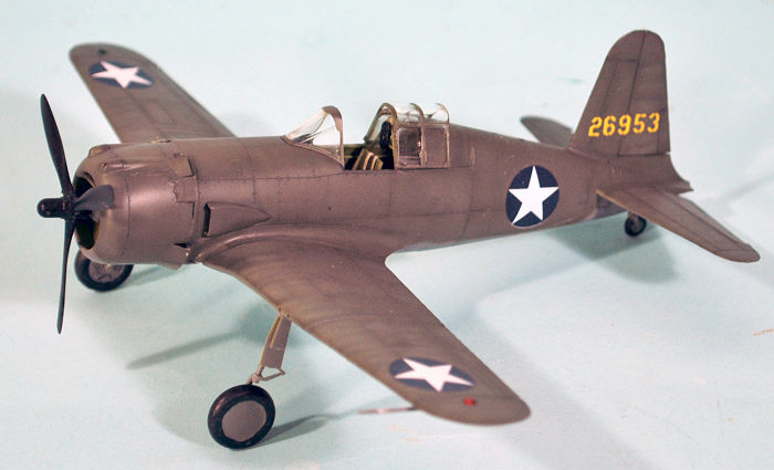

  • Vultee XP54/XP68
  • Vultee P66 Vanguard
  • P40E (Resurrection of plans started in the aftermath of my P36)

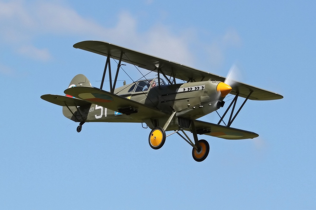

  • Avia B534

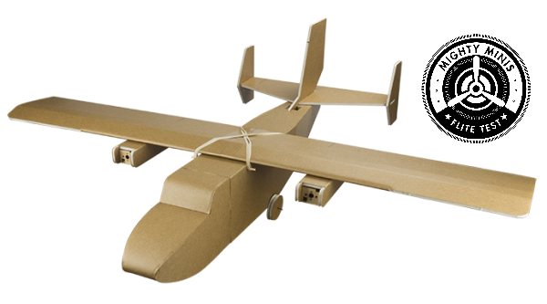

FT Mini Guinea
Link to plans: https://forum.flitetest.com/index.php?resources/ft-mini-guinea.169/
Link to FT build video:
I cut one of these out for my son to build last year and wanted to build one for myself! He built it but has yet to finish it - so perhaps if I get going on it, he might be motivated to finish it (finger crossed!) It would be fun to both fly the same plane at the same time - different paint schemes of course 😁
Feb 2 - Starting on the Mini Guinea 9:28PM
Ready for electronics 10:30PM
This build is a normal next-step Flite Test build. It has a few curves that are good for the new builder to try something different and build a new skill. I chose not to put the drop bay in the back and just simply build it plane Jane 4 channel. I have not done anything with differential thrust although I do have several twin engine builds (Bronco, Sea Duck, and Mini B17). I've done enough builds I didn't watch the buil video here either. Just a quick peek to see about installing the battery tray. I did oversize the cutouts in the rear for 9g servos as I've got a good quantity of them. Just be patient with the nose and be sure to pre-form the foam! Even with cutting things out this is really a nice and easy one evening build.
As I have never flown one of these (that's changing very soon) I can't yet rate the Pilot Skill...
Build Skill = 1.5-2.0 (1.75?) - this is a very simple straightforward build and were it not for the curves it'd be a 1 all day long.
The livery here is yet TBD - maybe a nice basic white. Perhaps I'll call it "Plane Jane" - how about some nose art?
I might put electronics in it tonight, I might not. I'm distracted right now so we'll see.

XP68/XP54 plans are rewinding to an almost start-over. I like the lines of the 68 better but the 54 vertical stabs are cooler. The booms on the 54 may be a little easier to accomplish also (a bit larger). I was going to try to match the airfoils as much as I could but it's proving to be a miserable build. So trashing what I had and beginning again. I may take this as an opportunity to fast-track this design and not try to do anything else beyond the four that I've committed to. But then again, that decision will for sure change in about 20 minutes...
