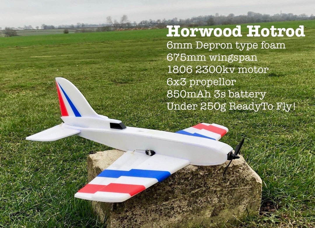

The Fopster
Insulation foam works well - although you need to build slightly differently designed planes. This stuff from B&Q works well:
Try designing something like this:
With a little imagination you can build all sorts of designs that will be very lightweight and fly well.
Good luck!
