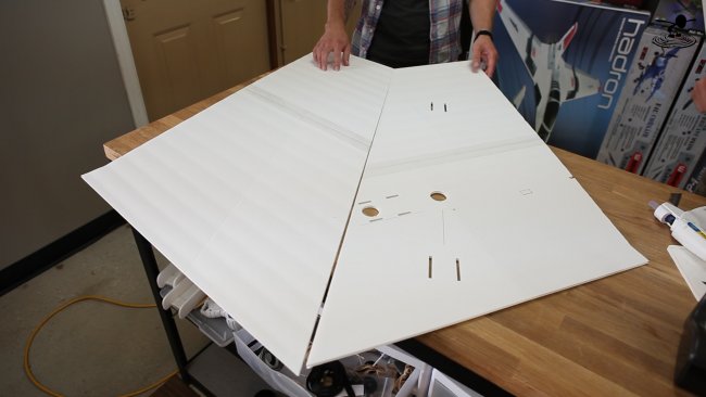

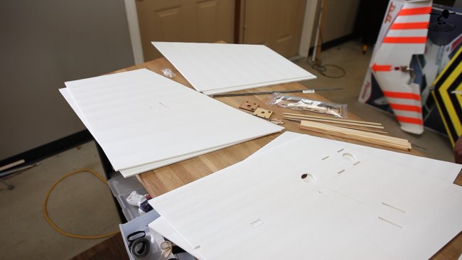

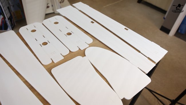

This kit is so big that it wouldn't even fit in one screenshot. The Speed Build Kit will be available sometime early August.

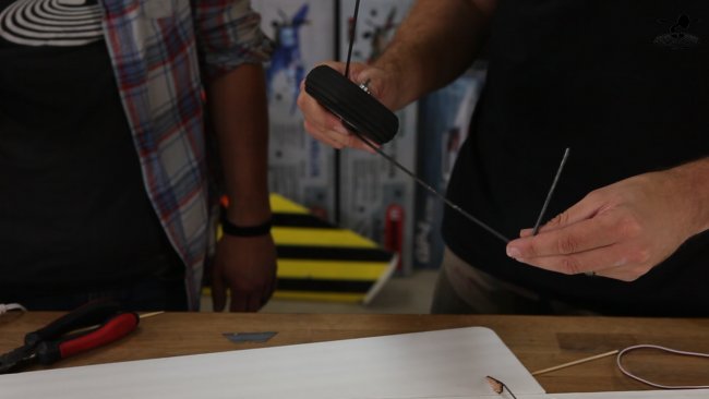

Measurements for landing gear wire
18" long x 1/8" thick (45cm long x 3.18mm thick)
Bends are 2" (5cm) and 6" (16cm)

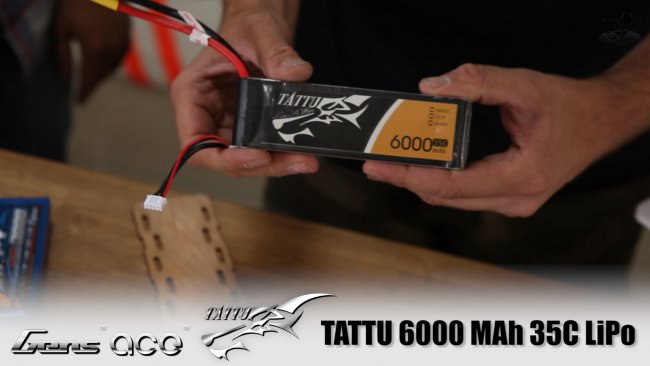

A big ol' wing needs a big ol' battery!
We've been using this 6000MAh made by Gens ace. This can get you close to a half-hour of flight time and is impressively light for its size.

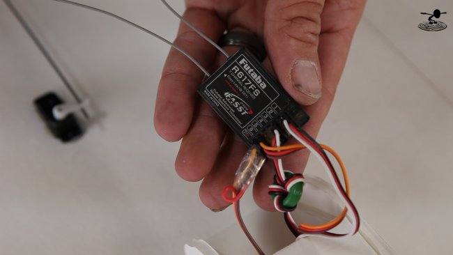

RECOMMENDED ELECTRONICS
  • Motor: 2x Suppo 2217/7 1250kv Brushless Outrunner
  • ESC: 2x Suppo 30A Brushless ESC
  • Servo: 2x GS-9025MG Micro Analog 11g Metal-Gear
  • Prop: 2x APC 10x4.7 Slow-Fly
  • Battery: 2200 - 6000 mAH 3s
  • 4x 12" Servo Extensions
