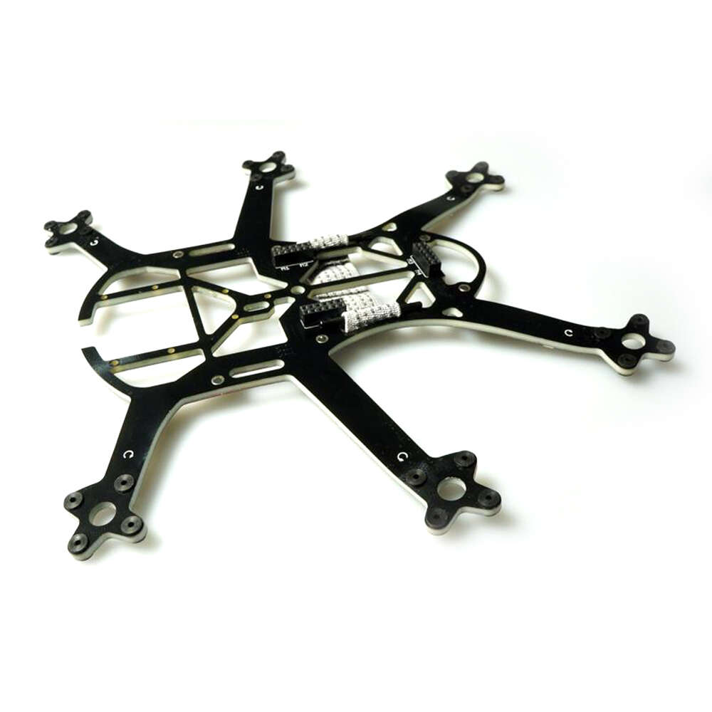

. Even one of the more radical looking mini, the TBS Gemini hex, is cut plate at its core.
Just have to point out....the Gemini not only isn't CF it's not just cut plate. It's a formed piece of G10 that makes up the main frame and arms. It's not flat - there are twists integrated into the design.
It's not a full 3D layup but it's far from just flat plate. Heck it even has circuit traces integrated into it (which is part of why it's G10 and not CF, lot harder to embed circuits into a conductive base like CF!) Even so they managed to keep the cost of the base frame at $40.
I'm tempted to agree that prices are somewhat inflated on some of the high end frames. But having been involved in helping Twitchity with his frames I know first hand how difficult it is to source high quality CF at a decent price...and how much expense goes into development. With that knowledge I have a very hard time considering a frame like a warp or blackout to be overpriced. It's hard to find equal quality raw materials at the same price. Add in the costs of tooling in the machining process (even if you're "just cutting plate" CF tears through cutting tools fast and if you want quality cuts you have to replace them frequently) and in the material used in developing a quality design....yeah...I really can't fault them for their prices.
Now guys who just duplicate an existing design and don't worry about top quality materials...there's no reason for that stuff to be expensive. But you definitely do get what you pay for. I've learned first hand what can happen if you end up with a bad batch of CF.
