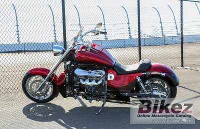

Tench745
You can build a motorcycle with a 357 chevy engine in it, but no sane person would ride it.
Off topic, but apparently you've never heard of the Boss Hog?
