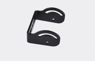

Any thoughts on adding a camera side plate option for the runcam swift with the angle adjustment screw?
I don't have access to a RunCam Swift at the moment, but to be thoroughly honest, space is at such a high premium, I don't expect the mounting tabs on the Swift would clear the PDB/FC stack.
I did re-design the camera mount to shift the cam forward after some of my testers were noting that HS1177 cameras with the connector on top were having clearance issues at full tilt. In my own builds, I hadn't even noticed that issue because I had been using cameras with the connector on the bottom.
With the new mount, the camera is about as far forward as it can go and still clear the props. The 200mm layout is one of the limiting factors in this space constraint.
Camera mounting is one thing that could definitely use some more refinement. It works as is, but it would be better if I could fix it more rigidly to prevent tilt changes. One of the things I am working on already is an optional printed camera mount which will have a fixed angle. I already made one pass at that but I need to make a few tweaks to make the camera fit properly. Then I am going to have a couple of those printed out of TPU.
