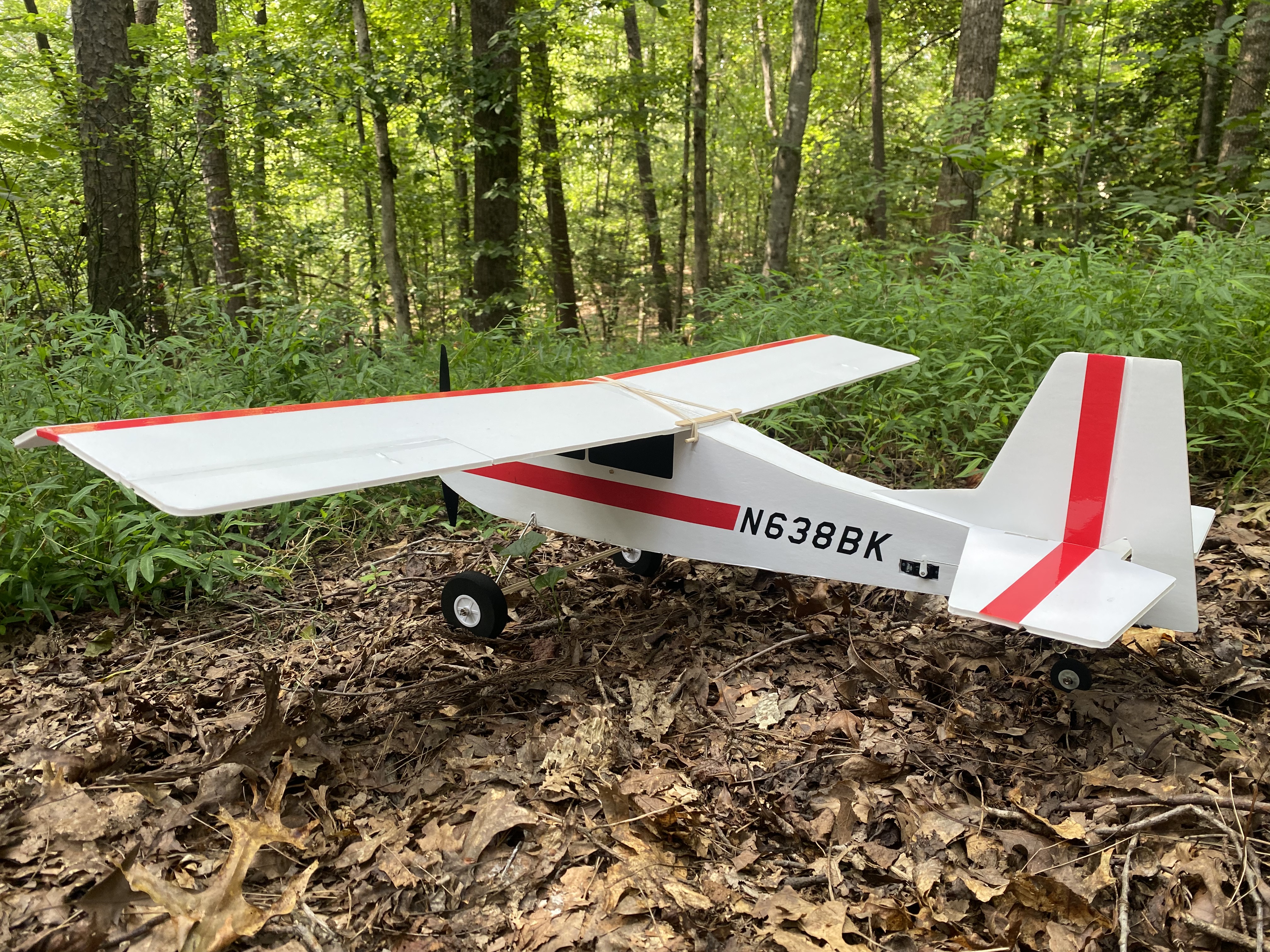

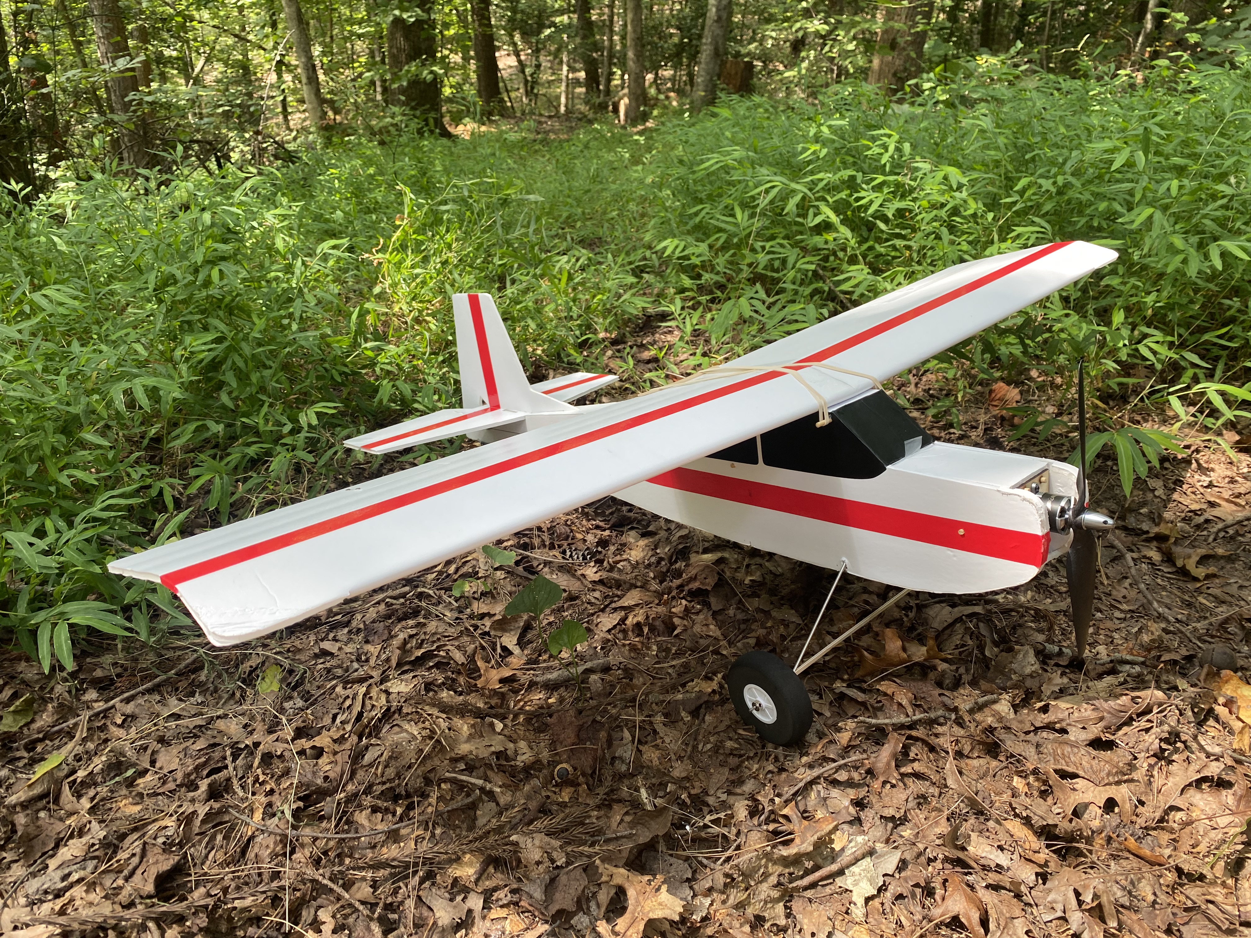

I finally got mine built! It took longer than I would care admit, but it’s finished. I added an internal tooth lock washer to the propeller nut, I found sudden throttle changes could collectively unthread the nut when throttling up. Also included in the photo is my MicroAces Scrappee Bipe, a really neat shop that makes micro scale historical aircraft as well as some nice trainers, my Scrappee took an unexpected flight and a gust caused a nose dive bending prop shaft, and a small crack in the wing. The pic made me want to try a buddy launch/parasite fighter thing. Anyway, enjoy the Tutor, and I’ve been able to pull some donuts with it on the ground!
