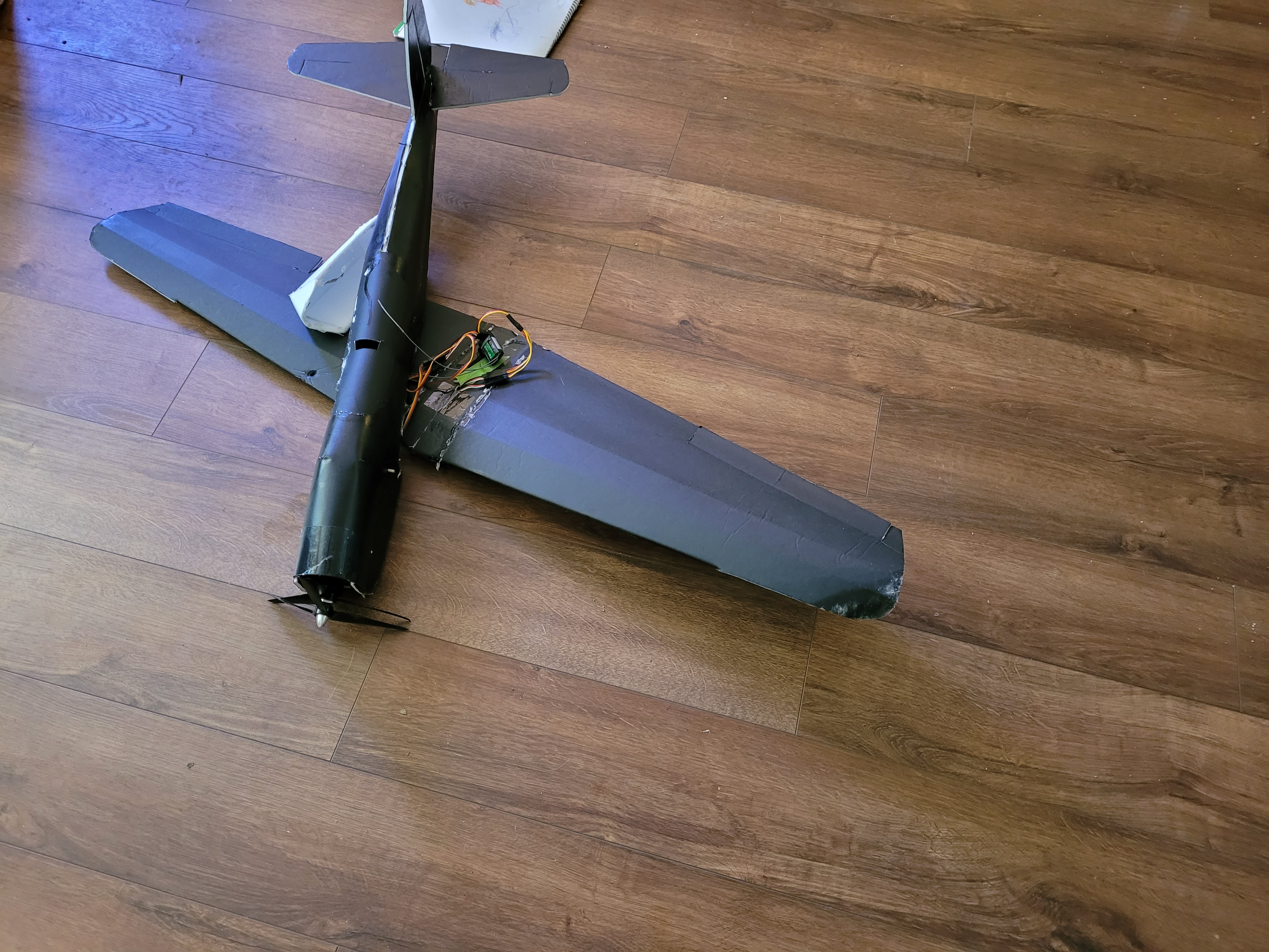

It had to much roll authority (even with 30% expo and 70% rates on roll, it was very touchy on roll) and really anemic pitch authority. I suspect that I had my CG to far forward, as it took quite a bit of up elevetor to keep it flying level, even at some appreciable speed. Managed the first turn after launch (straight out into the field, needed to turn to not hit the far field trees), but when I went to turn it around to come back to us, I got it nose down somehow [no video to be sure exactly what happened] and even full up didn't get it to pitch back up and it was throttled up as it went down.

Wow I really thought you had that plane dialed in, you put a lot of thought into that one . I have nothing to offer as to what problem could be , almost seems as you describe that somehow the CG shifted in flight?
I had it at the highest static margin recommended (fairly far forward) I don't think the battery shifted as it ripped out the 3d printed thing that I made to hold the battery strap. It was rather windy, so I might have set the CG incorrectly from wing messing with the balance.

I glued it back together (including a few new bits of foam) and marked out 15%, 10%, 5% MAC static margin positions for the battery. With it at 7.5%, it handled glide tests fairly well - as best as I can test something like this. So I need to get it airborne and tested again.

second maiden with the CG moved back to only 7.5% MAC... Still something off, crashed same cause, got nose down and couldn't pull up to get out of the dive. I also noticed when rewatching the video that I was high alpha near the ground and it took a bit before it started getting enough lift to actually get 'up' even at that level of high alpha. I think the wing (all together, drag from kfm, Coefficent of lift, etc) just needed more speed then I was getting out of that prop/motor combo to really keep it under control and I was flying to close to the stall speed even at 75% or so throttle.
