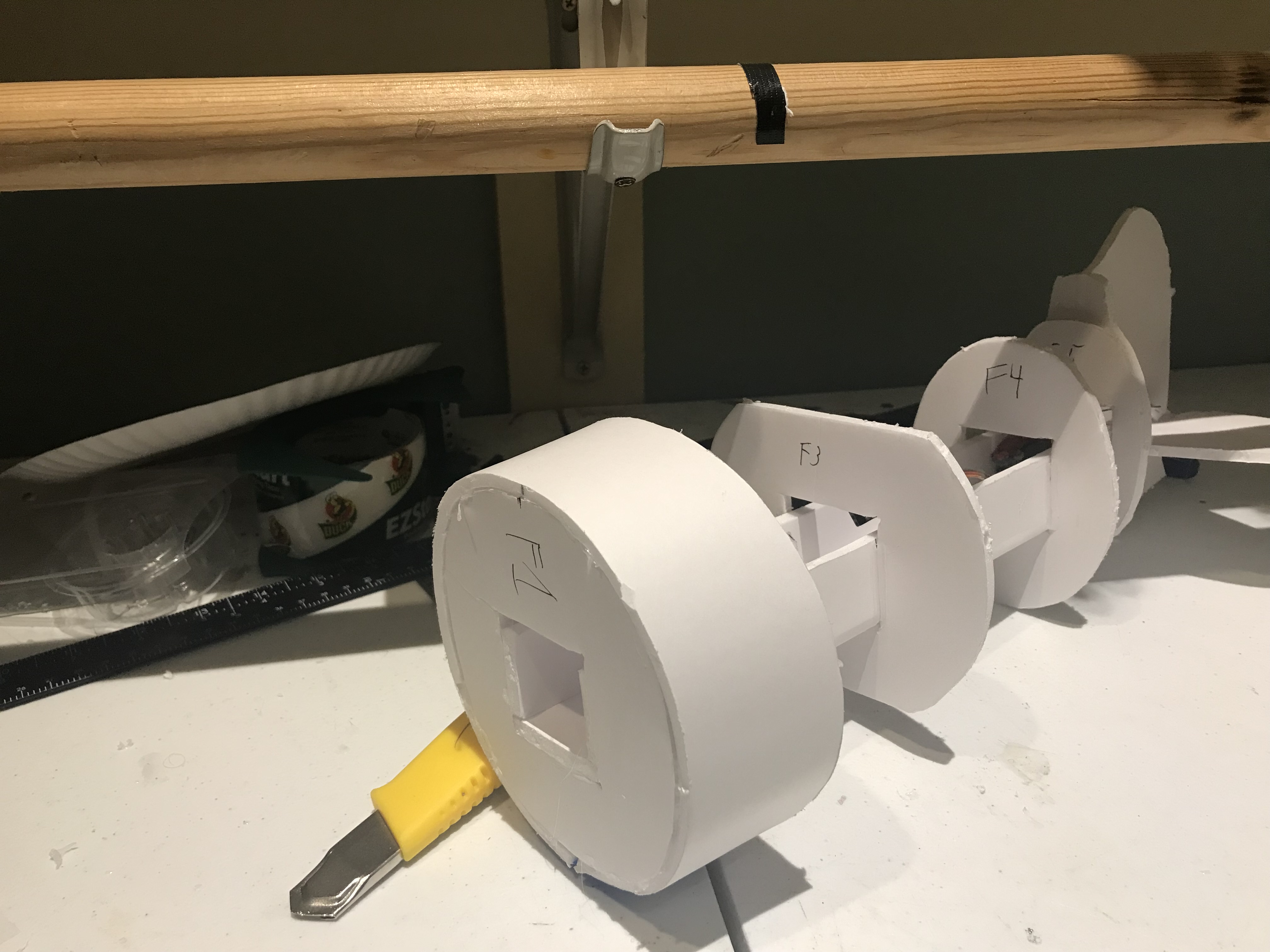

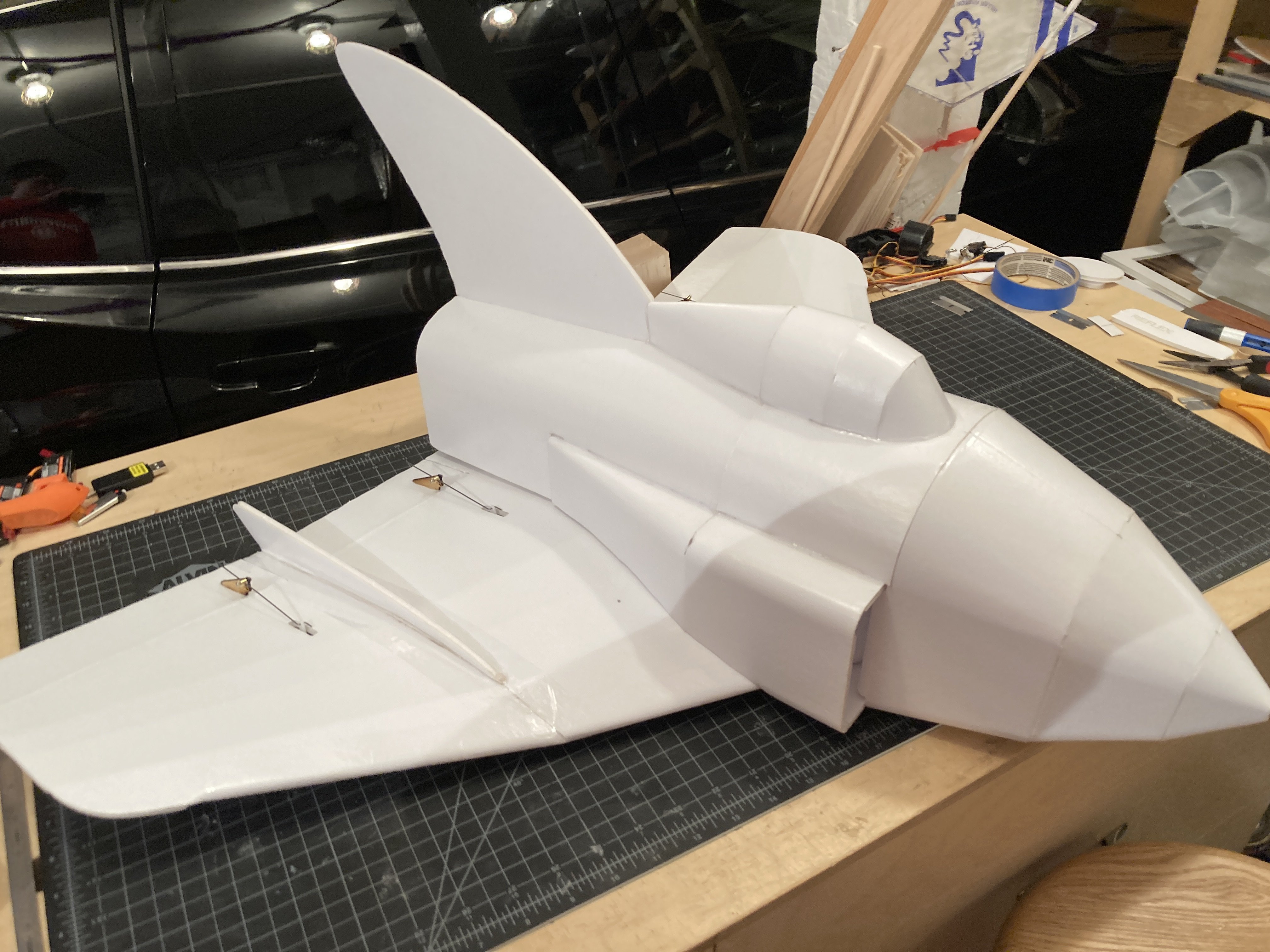

Flyingshark
I've been getting back to the Retro Rocket SBK I started a few months ago recently; did a lot of work on the wing tonight, so all that's left are the motor and wing mounts and the internals! :D
More progress today! I really like this wing mounting system so far—it sure looks solid, so hopefully it’ll survive lots of belly landings.
