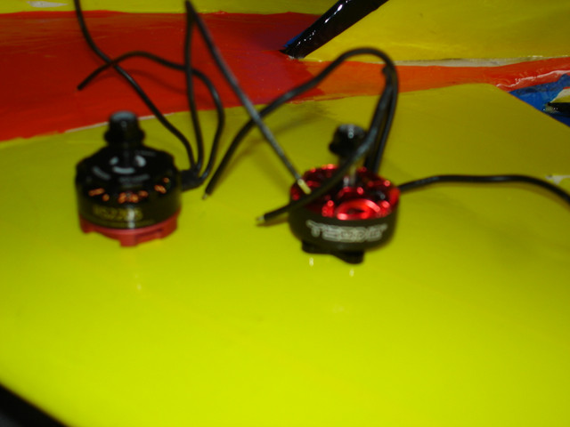

I promised to assemble a model - I have assembled it. But this project is constantly accompanied by failures: a package with servomechanisms was lost, a package with different engines arrived (I ordered 2 CW + CCW engines of the same brand) from different manufacturers and different capacities. Now I have to order a pair of the received engines from another seller in China..The first flight of the model is still a month away.
I plan to install 2 engines (CW+CCW) with a 5045 three-bladed propeller ( https://aliexpress.ru/item/1005004019322874.html?sku_id=12000029353985150 ) on the exhaust pipes of the model. The total thrust of the engines should be more than 1200 grams with a flight weight of a model with a 2200 mA 3S battery -760 grams.
