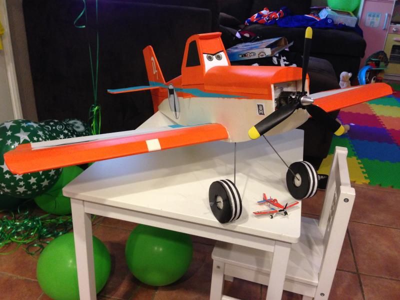

36" wingspan FT Dusty
Well, it's pretty much done. Not air worthy yet (stinkin aileron servo detached from the wing, now I have to make a hole to reglue it in...guess that's what these pics are for to look at it all pretty still). Took some pics of it in progress and final result next to my 3 y/o daughter's toy I based the paint scheme on. Will let you know how it maidened, when I get the chance...then I may just hang it up if it survives.
canopy done, ready for orange paint on the rest
first color down
paint done, had to remake the landing gear
final result.

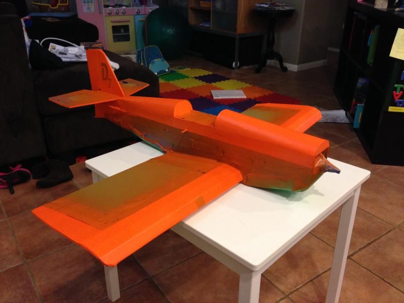

Well after my spray painting disaster with minwax, I ended up tearing a lot of the paper off the foam board and have been using duct tape to give it a skin and a paint job. I've heard that duct tape isn't the best kind of tape to stick to foam but it seems to be doing a good job. So far I am pretty happy with how it is going. It will be a little heavier with all the tape but I don't expect it will be a problem.
