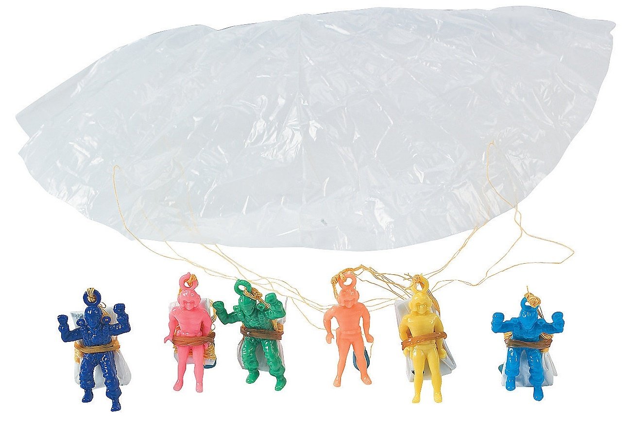

I like dropping "paper helicopters" cheap and easy and you can put a ton of them in there. Just a pain to clean up after
