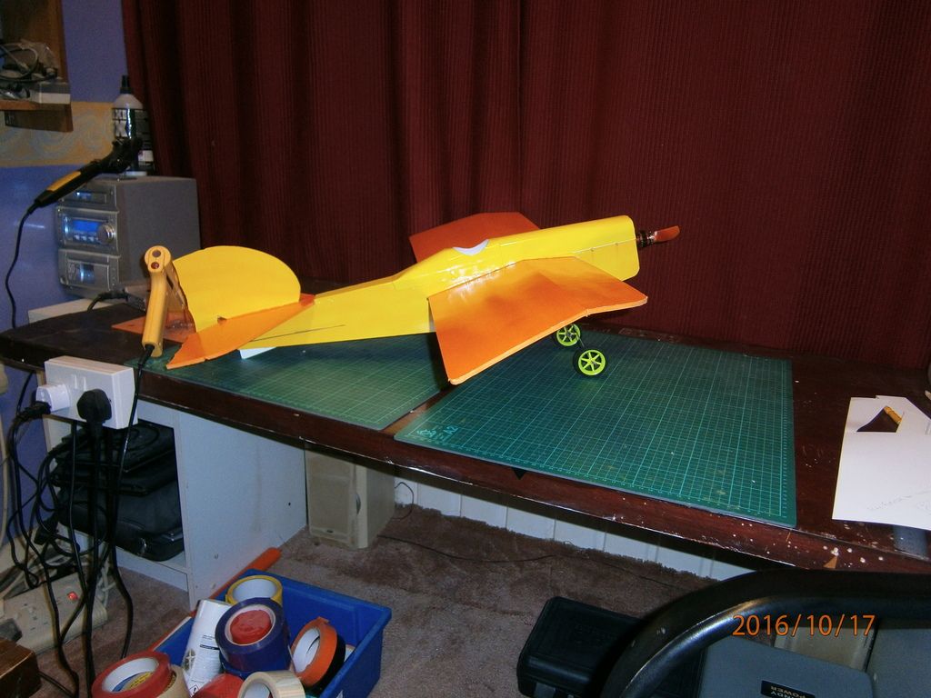

Hi Guys first of all thankyou for the inspiration to go fly a plane:) I have recently retired and been learning to build and fly quads with my grandson. I have watched the videos on your foamboard builds and just thought this this tip may be helpful to anyone outside of the States where the kit isn't available? After a lifetime in carpentry I'm a big fan of jigs for repeatability and speed. So I took a couple of hours to make the patterns out of 1/4" ply just one wing and a half fuselage gives perfect symmetry. The great thing is that using 1/4" ply and a pointed scalpel the ply guides the blade AND keeps the cut perpendicular giving great results. Additionally they give a permanent supply of repeatable spares See photo's and thanks again God bless FullSizeRender-1.jpg IMG_2731.JPG
