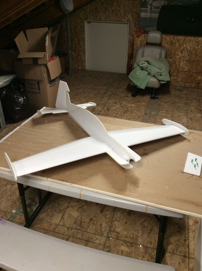

The 540 was so much fun on its maiden that I wanted a better one that did not twist and flex so much. So on a rainy Sunday I build a modified 540 with a symmetrical air foil wing with a 1/4" flat CF spar on edge and 4 corner gussets the full length of the fuselage. I will hide most of the wires in this space as well. It made it very rigid and only added about 25% of the empty weight. It currently has (2) coats of minwax poly, next it will get a light sanding and a high gloss paint job.
