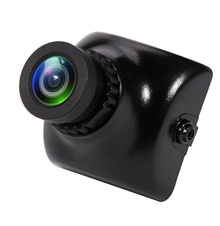

What is the popsicle on the wing top for?
Is there a reason for the HS1177 camera mount hole for other than what I stated? (it's always what I assumed it was for)

The popsicle stick is the spar, I forgot to put it in before I folded the wing:p
The hole in the front is temporary (I haven't built the nose cone yet)
