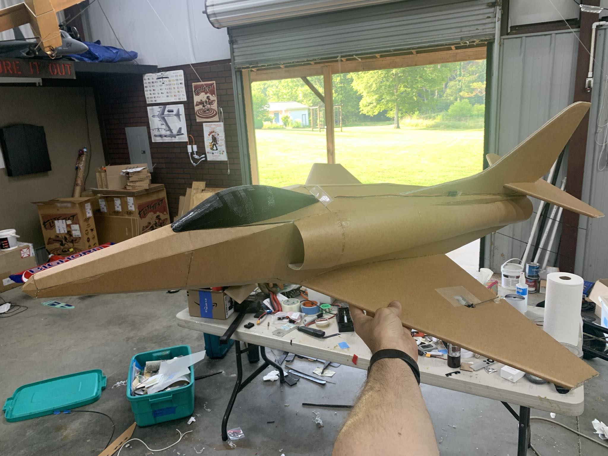

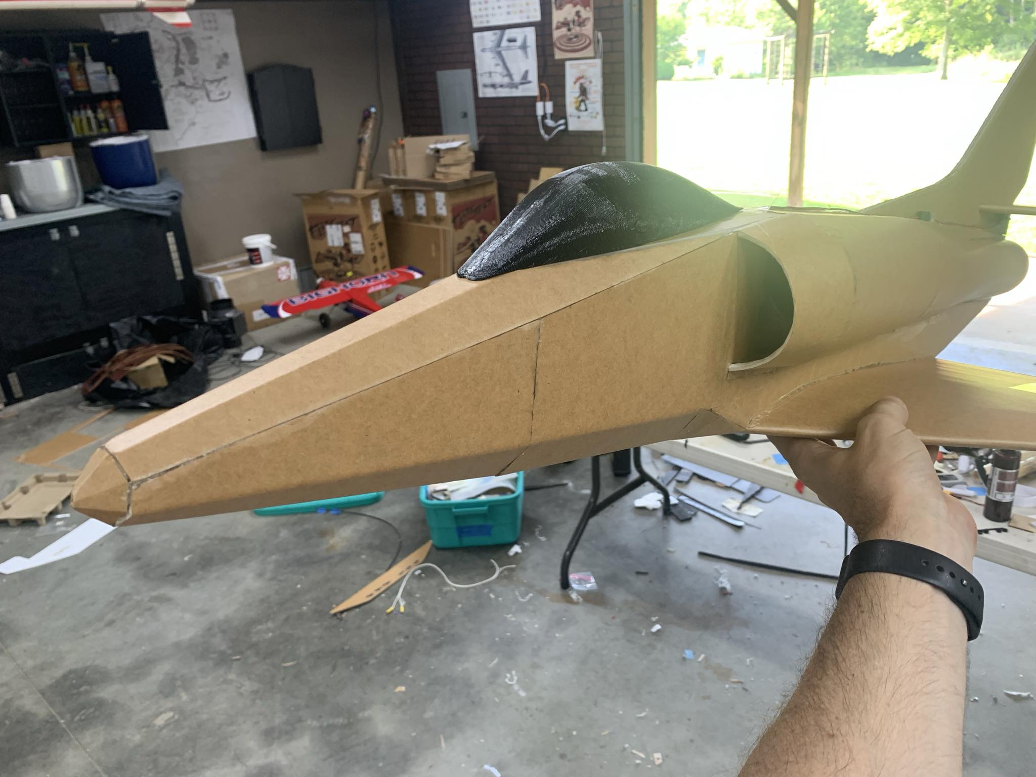

Plans UPDATE!
Latest plans are v11 and they are HERE! I updated the resource page as well, but I’m not sure it took right, and I can’t seem to update the version number from my phone so I wanted to post the latest plans right here in the thread as well.
One main change: the thrust tube is FOAMBOARD! It attaches directly to the EDF and the inlet/nacelle pieces attach to the thrust tube at the back - the square fuselage section at the rear is GONE. See the attached pictures. Let me know if you have any questions.
Enjoy!
Enjoy!
