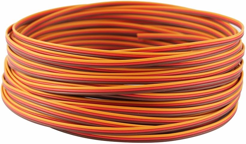

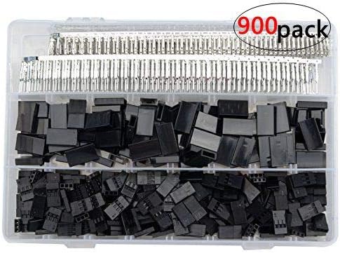

Still Alive! I'm back. Well I've officially finished the Mk-2, and tested it for power in the backyard. It is very much under powered. I used a 2200mah 3s Lipo for the test. Her glide was fine, but it does not have enough power to remain airborn. When at full throttle, it should be wanting to take my arm with it if I'm holding it straight up. I've considered what I've seen and I'm looking and three thing to remedy this issue. 1.) Try using a 4s battery. but it will add more weight forcing the motors to work harder. 2.) Upgrade to 70mm EDFs, which will require the bigger battery. And 3.) Reduce weight where I can. The fun there is not compromising the structural integrity of the plane and keeping it balanced while doing so. I may need to do all of the above. However this thing is beautiful.
On a different note I found some awesome stuff that helped in doing this things electronics. I found the parts to make me own custom servo extension cables on Amazon. A 900 pcs pack of connectors and 50ft of cable. Very useful!:D:cool:
