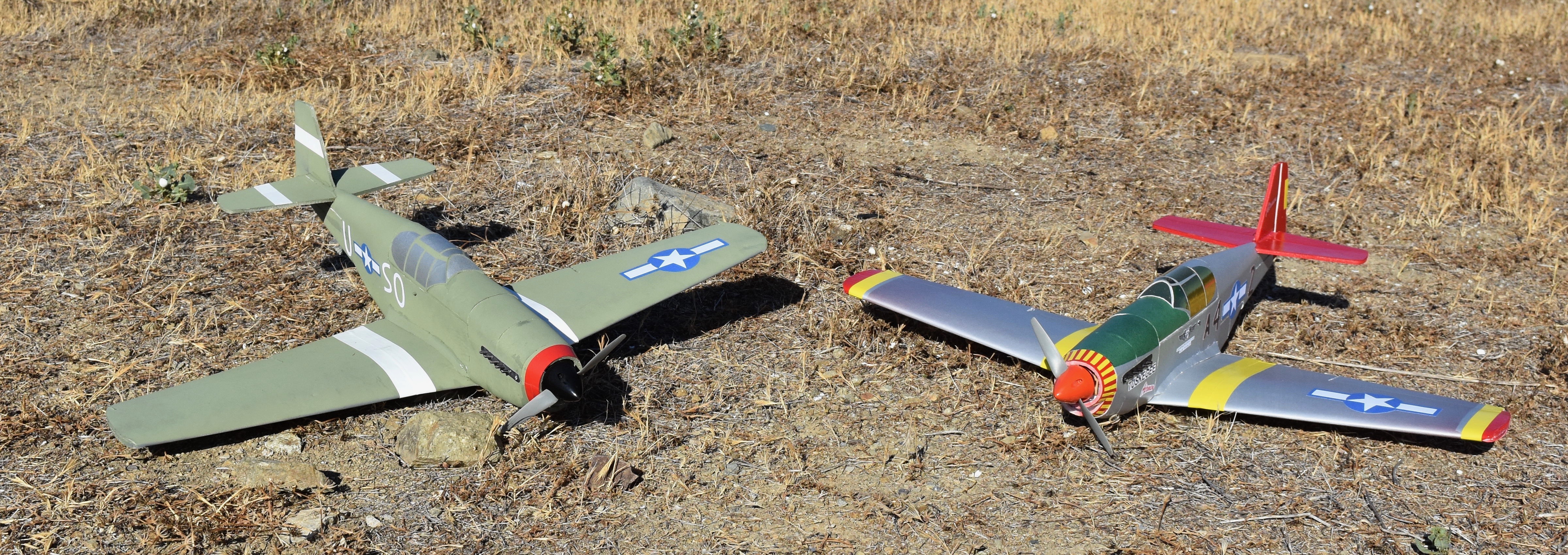

About six years ago, the build video of the original FliteTest Mighty Mini P-51D Mustang was released on Youtube as part of a challenge between Josh Bixler and Peter Sripol: how fast can you go with one sheet of foamboard? Among other influences from the hobby community, this challenge inspired the inception of a long series of smaller DIY (do-it-yourself) swappable warbirds that have since dominated several flying fields across this nation.
Personally speaking, that build video was the principal inspiration for me to step with both feet into this unique hobby. After several years of working with the FT community and making wonderful friends at my local flying fields, I'm happy to present a small token of gratitude: a DIY 29"-span Mighty Mini P-51B Razorback Mustang, with publicly available free plans!
To obtain a quick taste of this Mustang in the air, check out the test flight of the first prototype, embedded below.

The key to success for models as small as this one is patience. When sanding the trailing edge of the wing or molding the nose region together, it may be tempting to rush the process to save time! As experienced builders would attest, however, taking time and paying attention to each square inch of the pieces being glued together will contribute significantly toward the aesthetic appeal of the final product.

Once the wing and hatch are secured, the battery strapped in, and the recommended center of gravity (listed on the plans document) confirmed, you are ready to fly your Mini P-51B! Launching this model is a no-brainer. Simply hold the fuselage from the top or the bottom, apply 50% – 75% throttle, and give it a firm toss at about 30 degrees above horizontal. The Mustang should climb out in less than a few seconds and settle into a comfortable cruising attitude.
Once all the controls are trimmed, the P-51 will become a docile bird with a wide speed envelope. Before pushing the throttle stick all the way forward, try experimenting at the lower end. The 29" wingspan coupled with the relatively high-lift airfoils render a pleasant slow-flight experience with ample roll control.
The same proves to be true at the higher end. With the stock FliteTest F-pack setup, the Mini P-51B can pull up into an unlimited vertical climb and perform loops, rolls, half Cuban eights and more! The generous surface area of the rudder should also allow for stunning knife-edges and point-rolls in the hands of an experienced pilot. This P-51B loves long lines and graceful maneuvers as opposed to abrupt turns, but the structural integrity of the wing allows the model to sustain high g-forces in both directions.
When it is finally time to land, point your Mustang into the wing and gradually reduce throttle. If necessary, the model can break into a gentle glide on its approach. If you do not install landing gear, it is preferable to land on grass to avoid damaging the paper underneath the nose of the airplane.
Once you are comfortable with the handling characteristics of the model, feel free to move to the next level and attempt streamer combat, formation flight, etc., and please do share your flight reviews online for the benefit of other builders!
