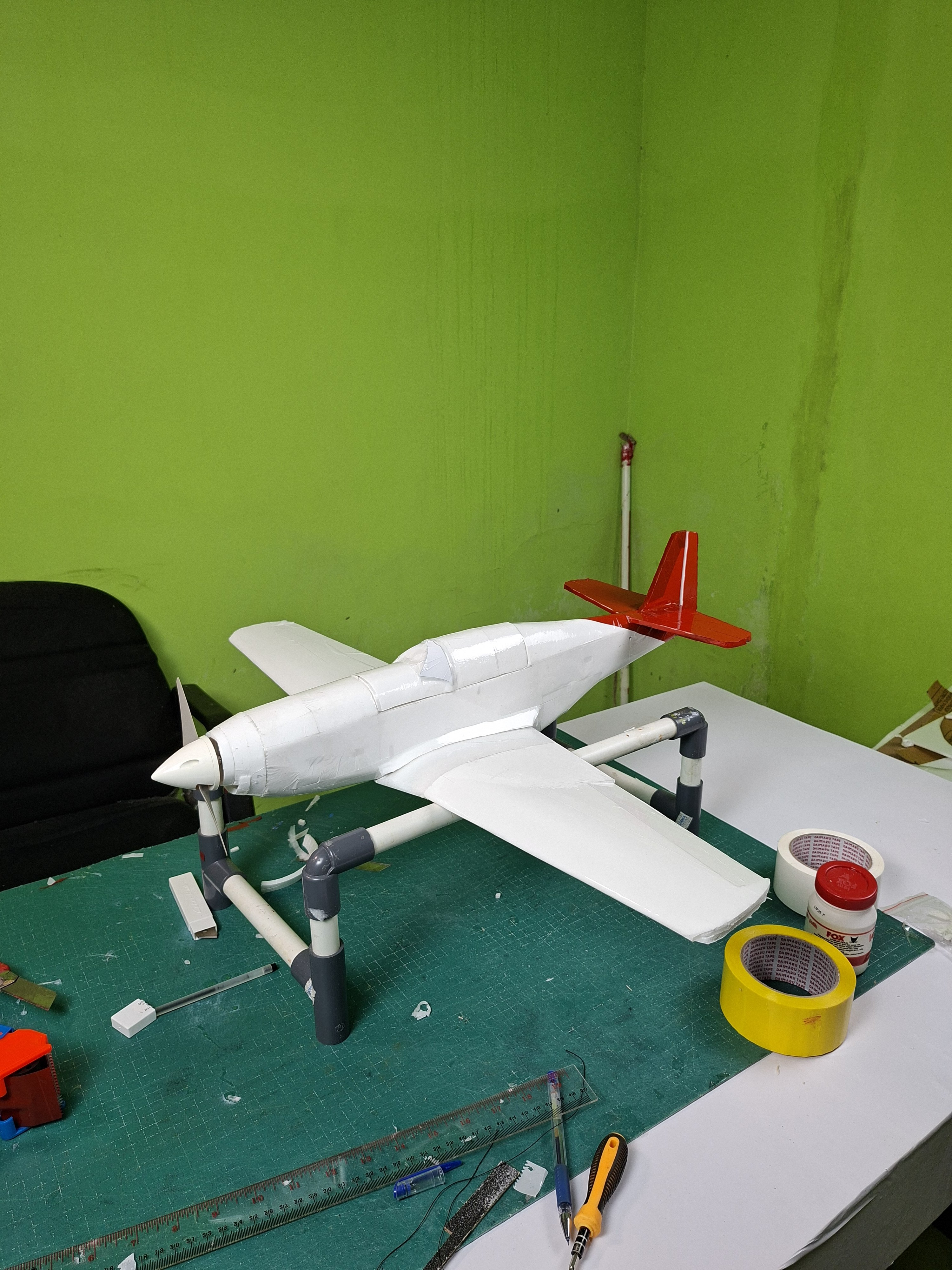

I built the P-51, this was very straight forward and a blast to build. I did 3D print the exhaust and it turned out great. finding the correct COG was a small struggle with batteries I had but I got it figured out. It flies great and looks awesome. Its not the cleanest build but my next one should be much smoother as I learned an a lot on this. Thank you so much to MiniacRC
Looks great!

@banknyank: Thanks so much for giving this design a go, your build looks real sweet! Love the color choice and the 3d printed accessory. In retrospect, I also find the foamboard molding a bit difficult to pull off when building at this scale. Glad yours flies well! :)
