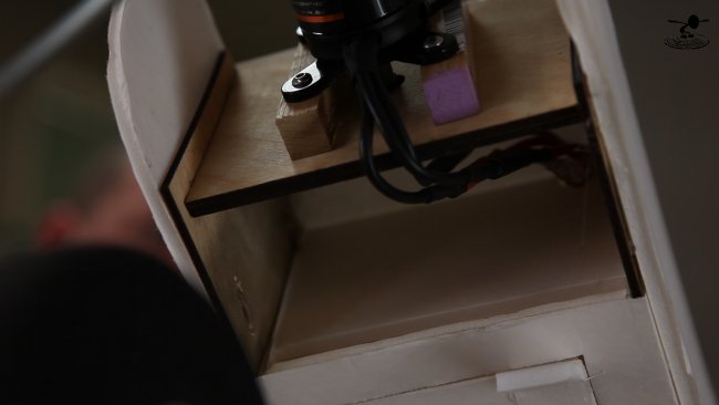

![monster-build-tips-6-jpg_1396472214.jpg](/proxy.php?image=http%3A%2F%2Fassets.flitetest.com%2Farticle_images%2Fmedium%2Fmonster-build-tips-6-jpg_1396472214.jpg&hash=d1fe2cd82244f04f83a71365c73ef7e3)
The motor mount was built from lauan plywood and LOTS of glue. Hot glue to be exact. CA glue didn't quite hold up to the vibrations from the motor and you can see the results below.

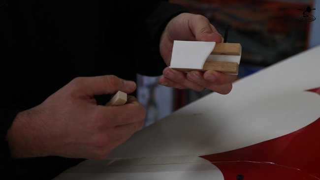

Here are the big fat control horns. The patterns for these are available in the Monster FT Cruiser Plans.

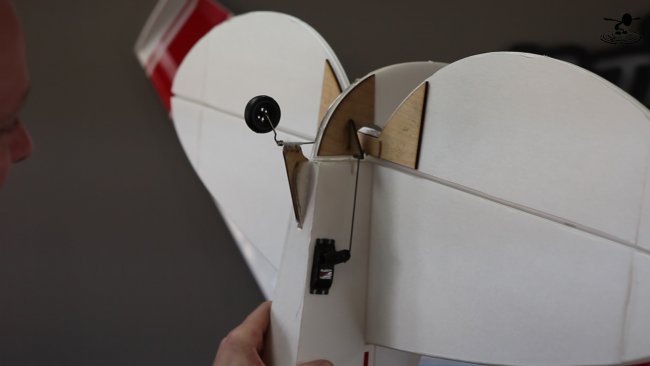

To keep the tail rudder strong Josh reinforced the mounts with a thin sheet of plywood.
