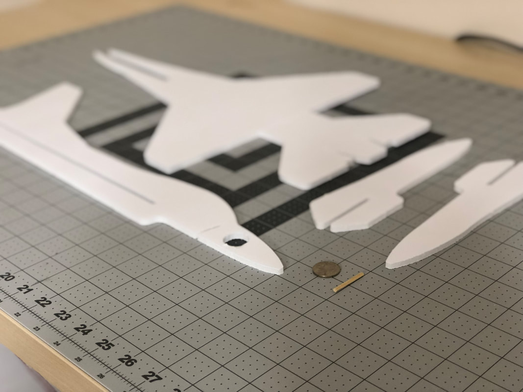

1. Cut out pieces. | ![]() |

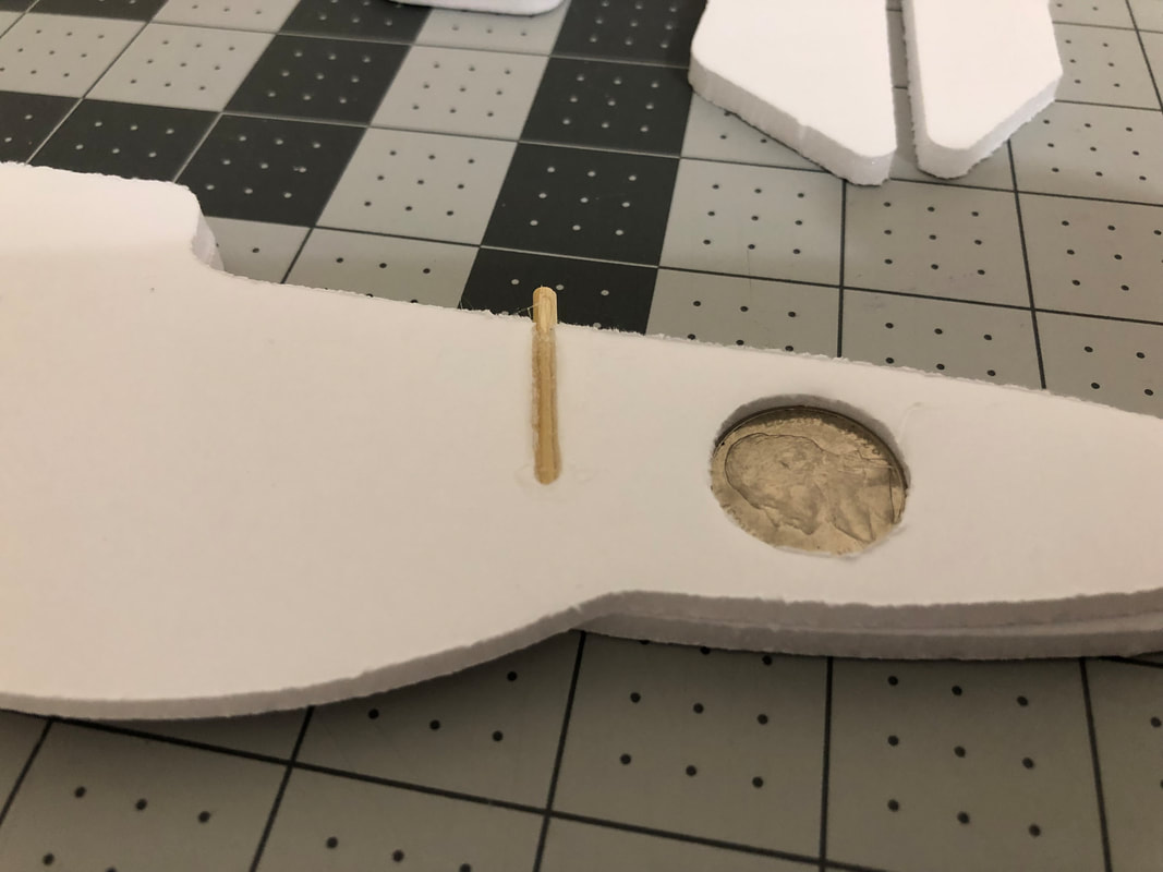

3. Glue in (1) USD Nickel and BBQ skewer in nose. NOTE: For my international friends, you need 5g of weight in the nose. | ![]() |

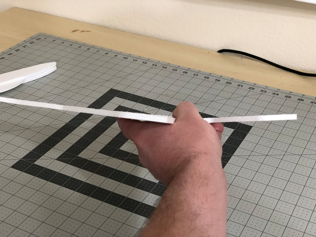

5. Crease wing/elevator. | ![]() |

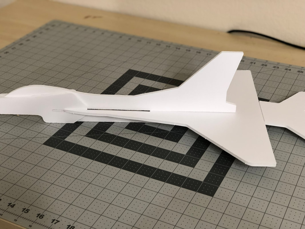

6. Slide wing in from the back and then glue. | ![]() |

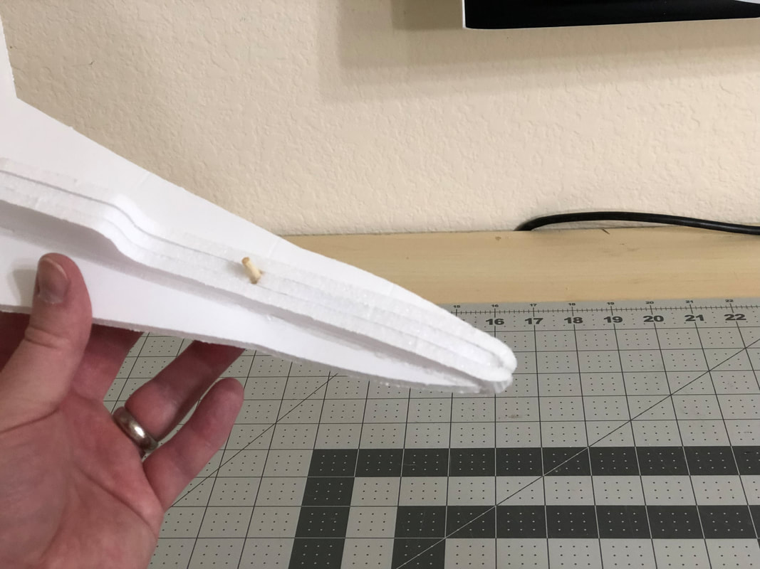

7. Glue nose and pinch to a point. | ![]() |

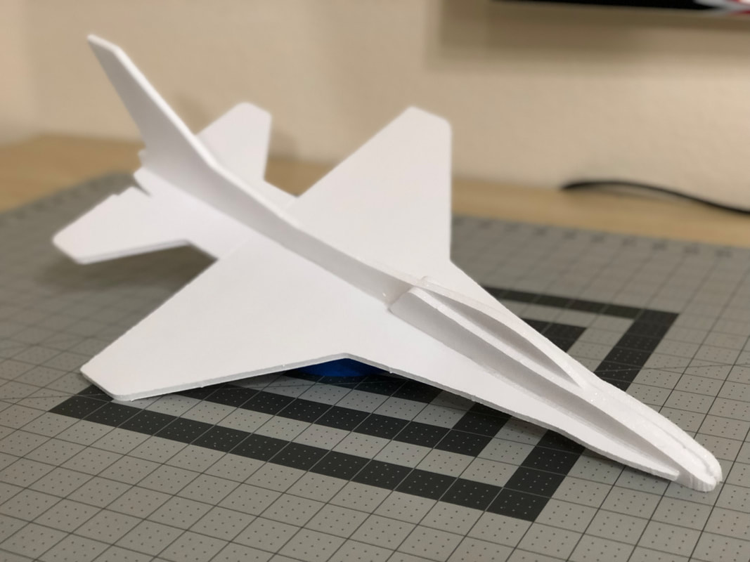

8. Go fly! | ![]() |
