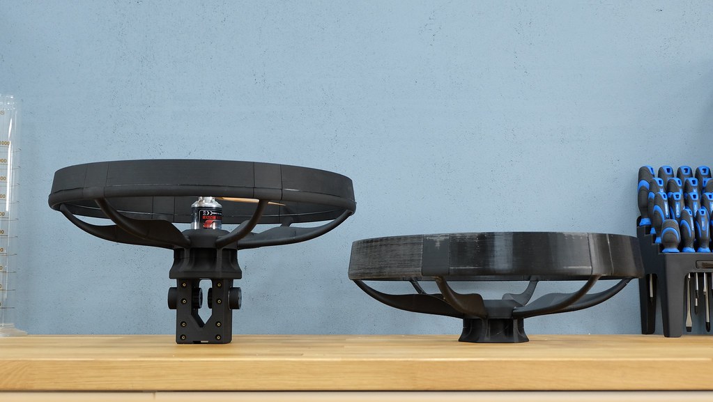

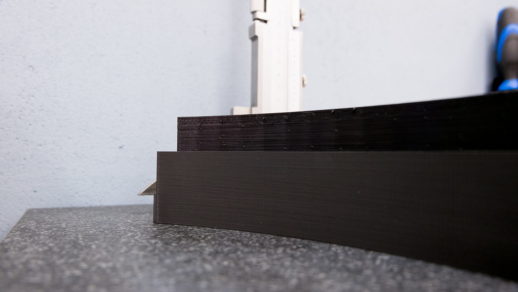

I printed all the parts for the paradrone a second time because of the enormous difference in quality, I will talk a bit more about that in the build topic. A sneak preview:

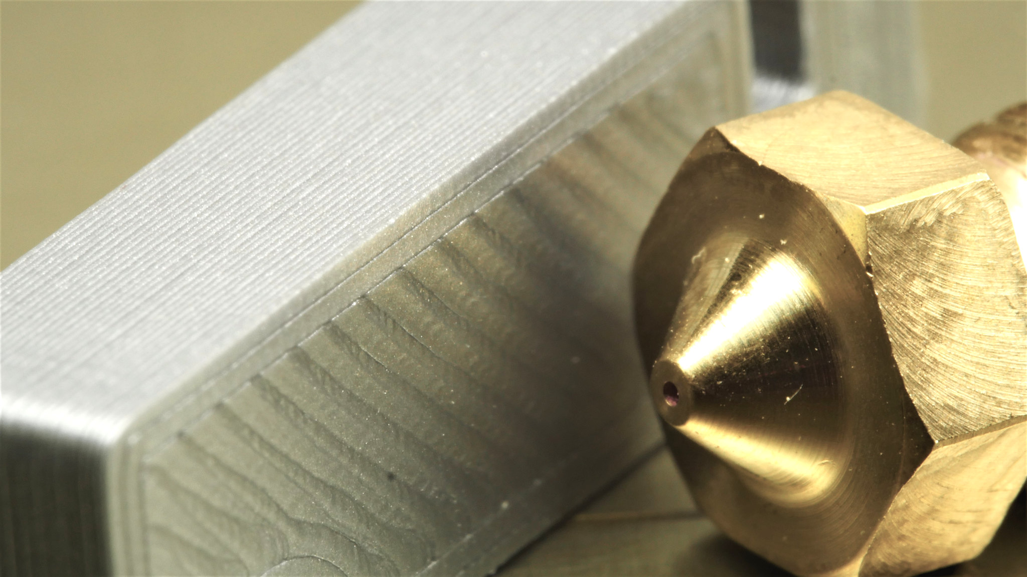

I also made a macro photo of the last CAM settings I used, for a better perspective I added a 0.4mm nozzle in the picture.
Quite nice right? I know I'm happy with the price/performance of the printer!
