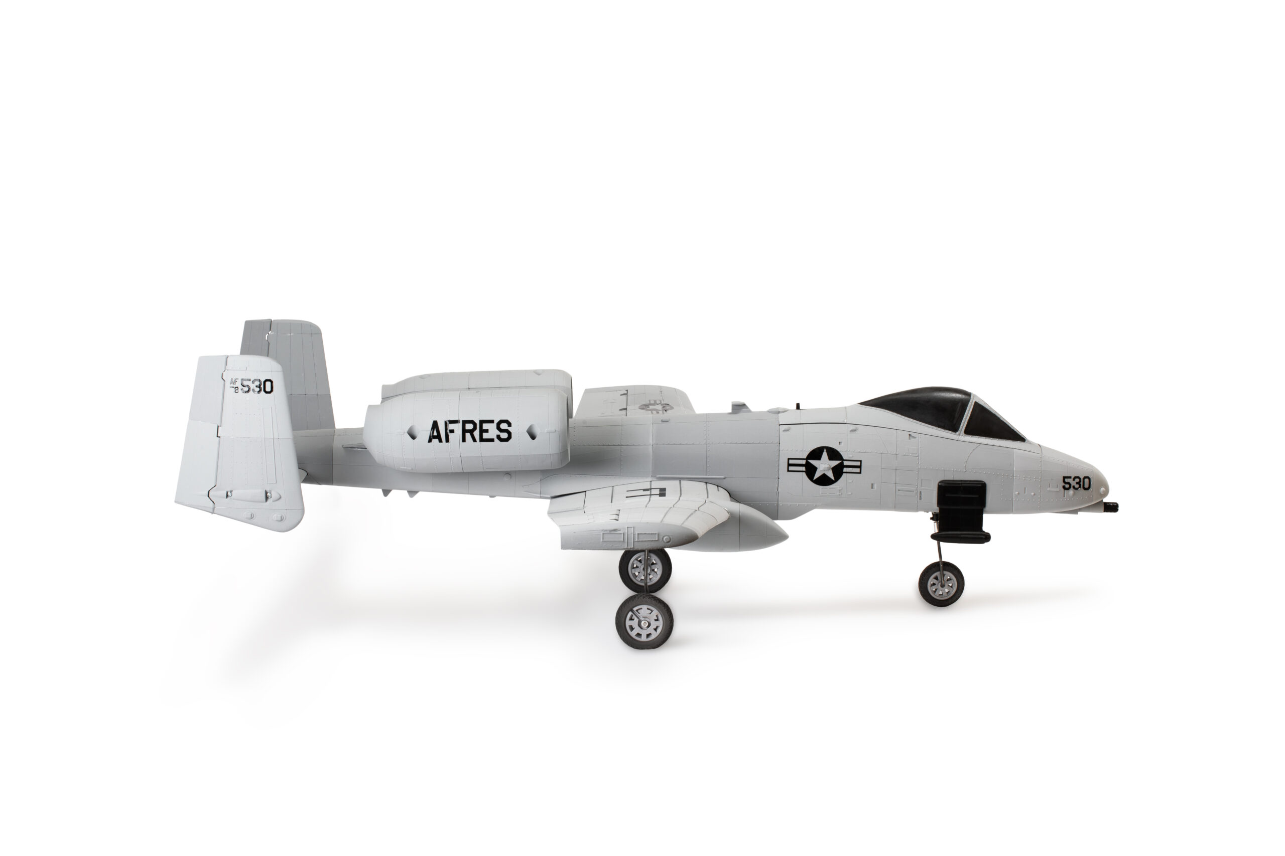

I am starting a build log but this plane has yet to be released by 3dLabPrint. There has been a few teasers on their FB group and on Instagram indicating a February release.
I am also entering this as one of the planes to build and fly in the Build-ruary challenge.
Although its still pending release I do have one part which was made available as a test in this article for printing on Bambu Lab printers.
I used those setting to print it on my P1P using PolyLight 1.0 LW-PLA but it did take almost 6hours. It came out really well and weighed in at 46g. This is a thick wing section so it looks like this will be a large plane.

My reaction when this plane released was to buy it immediately, especially with the 20% discount for existing customers but its a complex plane and so I decided to first check on what it would cost to build and my initial estimate is around $1000!. Now, I don't have any 6s batteries so at least 2 would be needed. Apart from 2 70mm EDFs with ESCs there are up to 13 servos and I would not want to rely on the really cheap ones. There are also retracts and again don't won't to rely on really cheap ones and end up with them collapsing on one of my hard landings.
And finally I have only built and flown one EDF plane before and haven't had much stick time on jets.
So I am going to hold off on this build, at least for the moment and attempt to finish and fly some of my other builds that are in various stages of construction.
