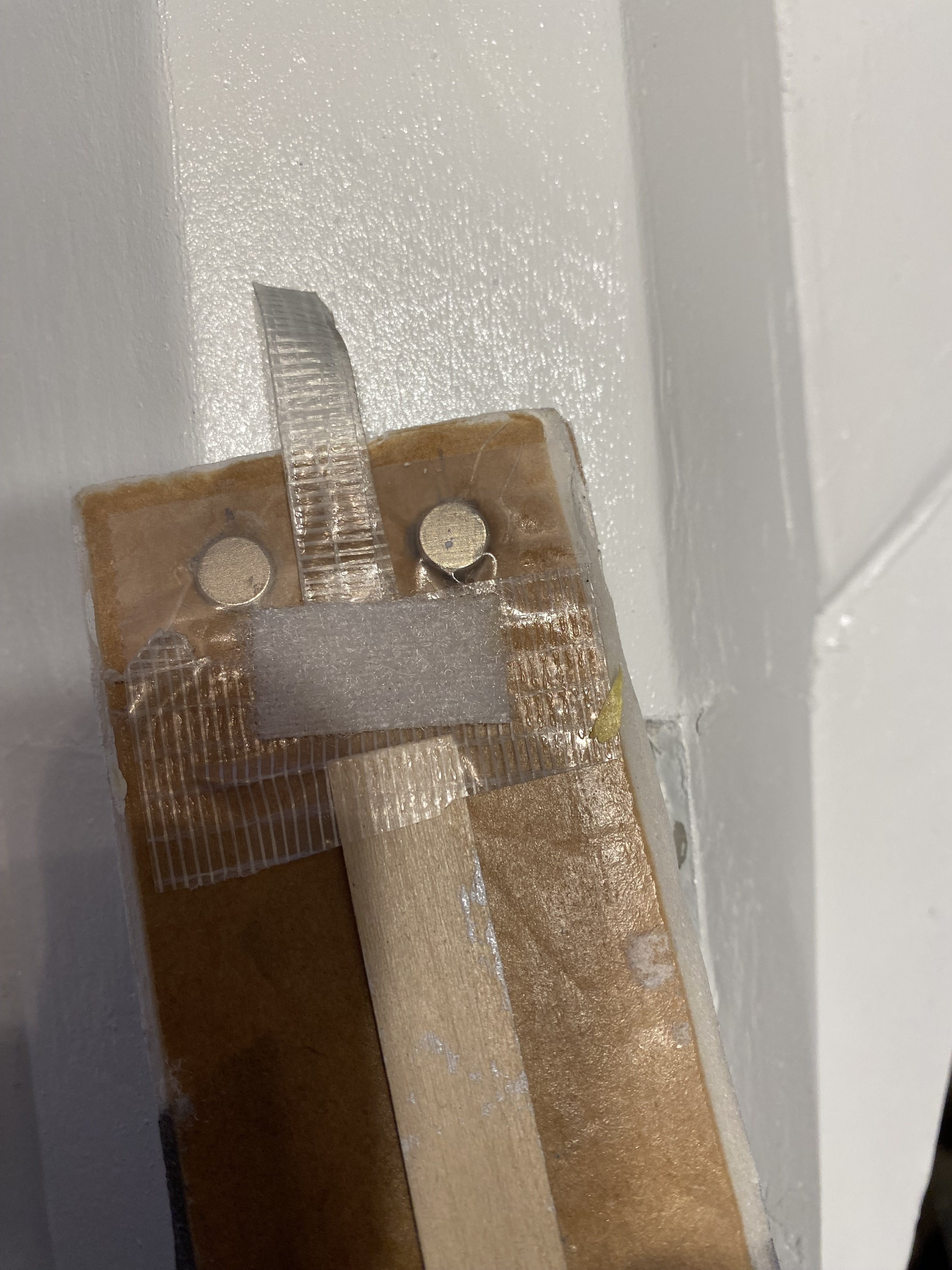

Took this F16 to the field again this week. Instead of hand launching we tried to use a dolly that I had made for another plane, but it didn't take off and ended up off the runway in the grass but fortunately no damage. The dolly is not designed for a swept wing and the nose of the F16 was pointing down a bit. Anyway, was able to hand launch it while Randy took it off but this time I took over on the trainer's buddy box once in the air. Randy took back the controls to land it and the only real issue was again the very short flight time. Now we did use up some battery in the dolly launch attempt so that may have contributed to it. I will do a bench test with a watt meter to see how much current is being drawn as maybe the 4s 3300mAh battery is just not enough.
The dolly
PS - also I had done this to keep the canopy on and although not very elegant it did work.
