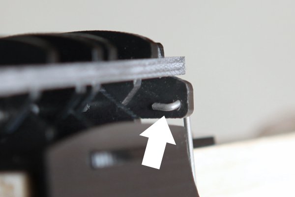

I just started rebuilding my tricopter from scratch. The only original components are the plates and bolts.
Andre: here is the amount of tilt I put on my yaw mechanism for 3 standard props.
EDIT: that looks like way more than I actually did. The angle is actually 6 degrees.
