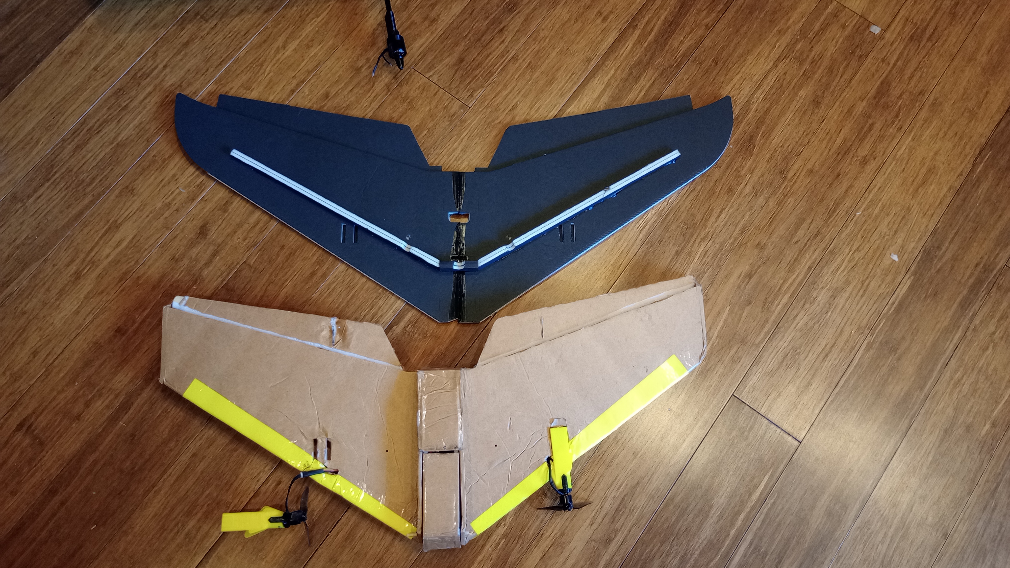

A little more detail on my build specs:
BetaFPV 1106 5000kv motors
HQProp 3x2.5x3 props
20A Spedix ESCs
Emax ES 9051 Digital servos
Matek PDB with 5v/12v BECs
Glacier ICE 3S 450mah 75c batteries with XT30
LemonRX 6 channel RX
FT kit built with Hot glue and no special lightening techniques whatsoever. (not in the slightest) (unless 3d printed motor pods are lighter...)
AUW with battery is 225g.
