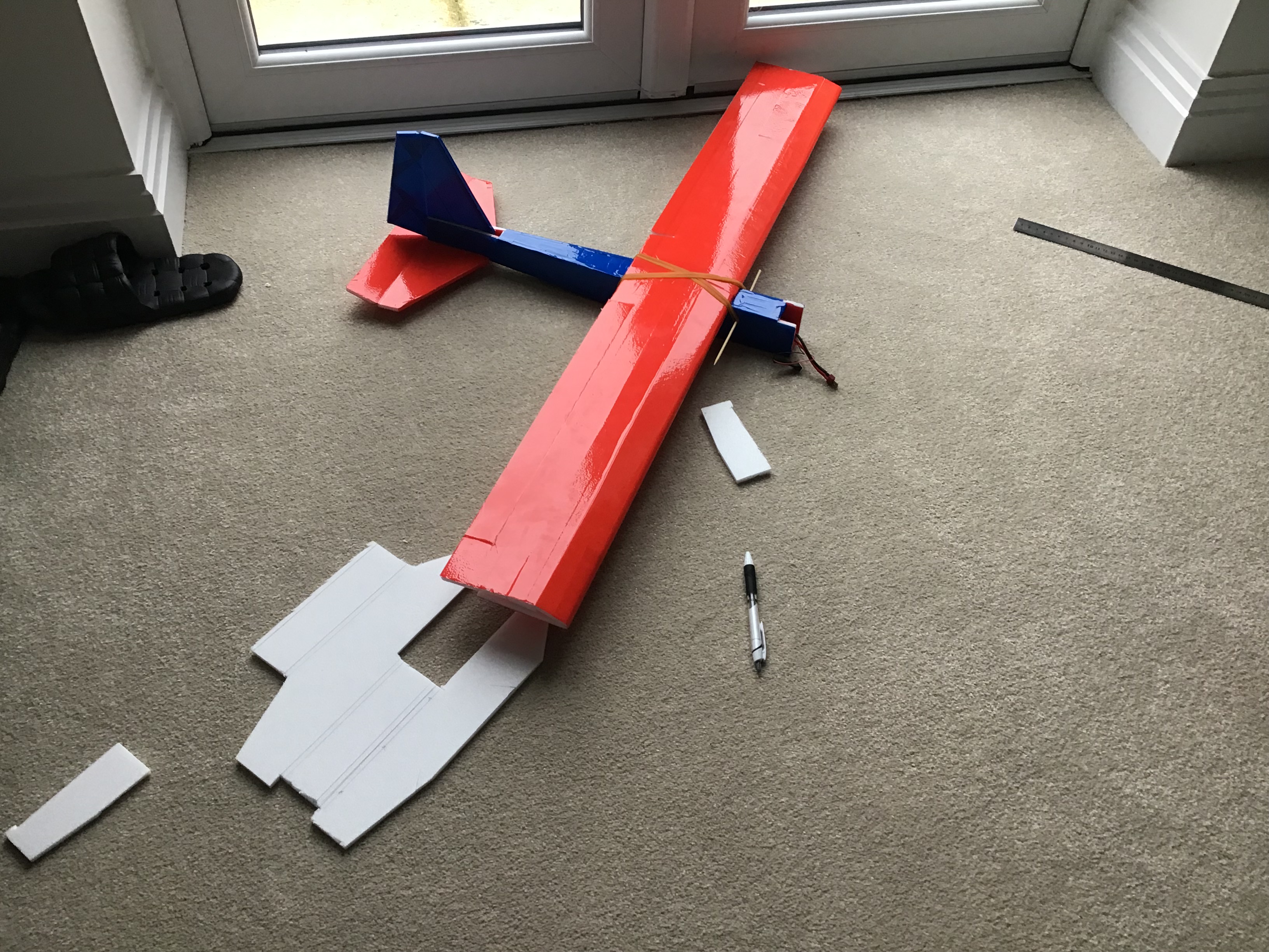

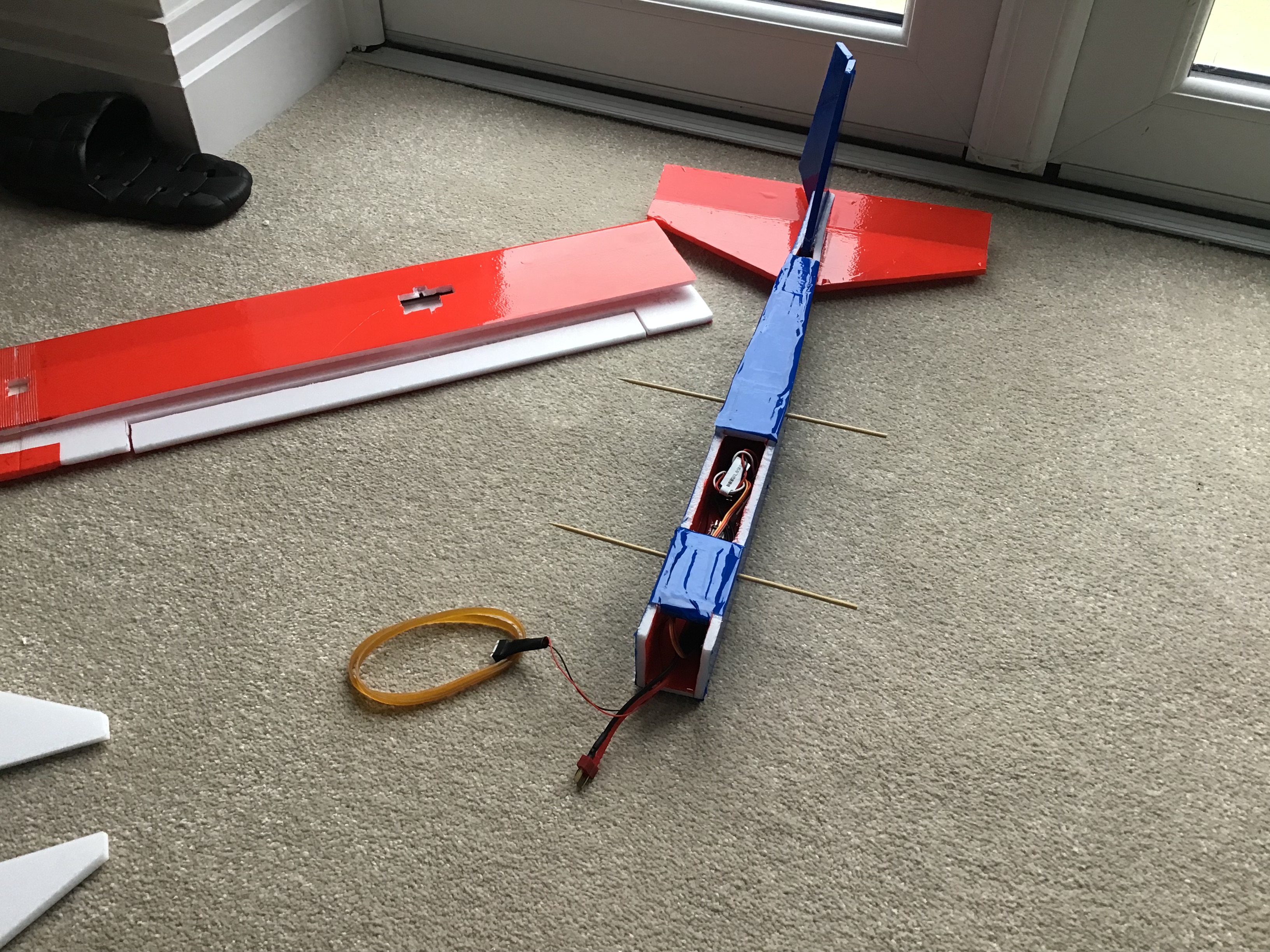

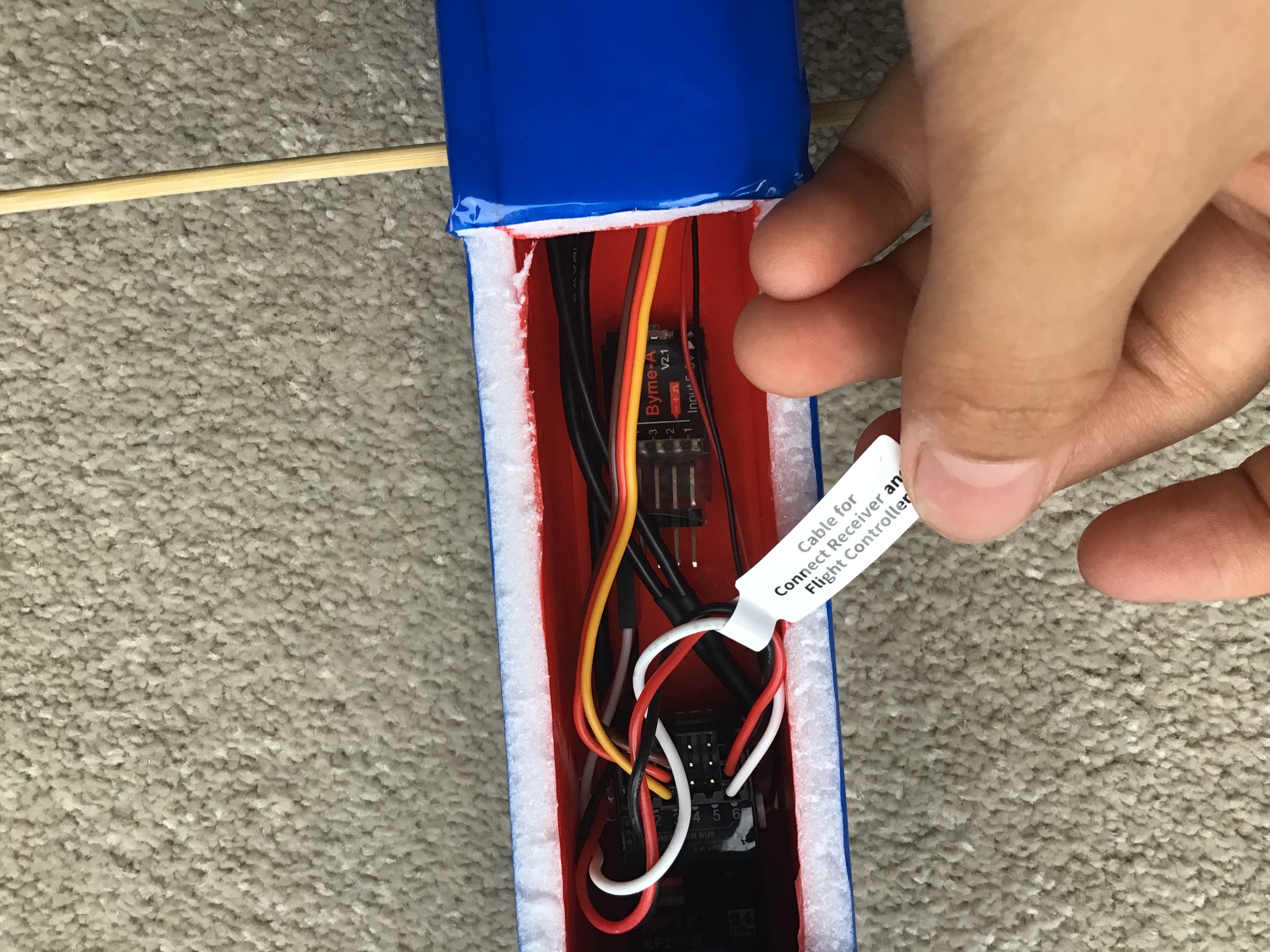

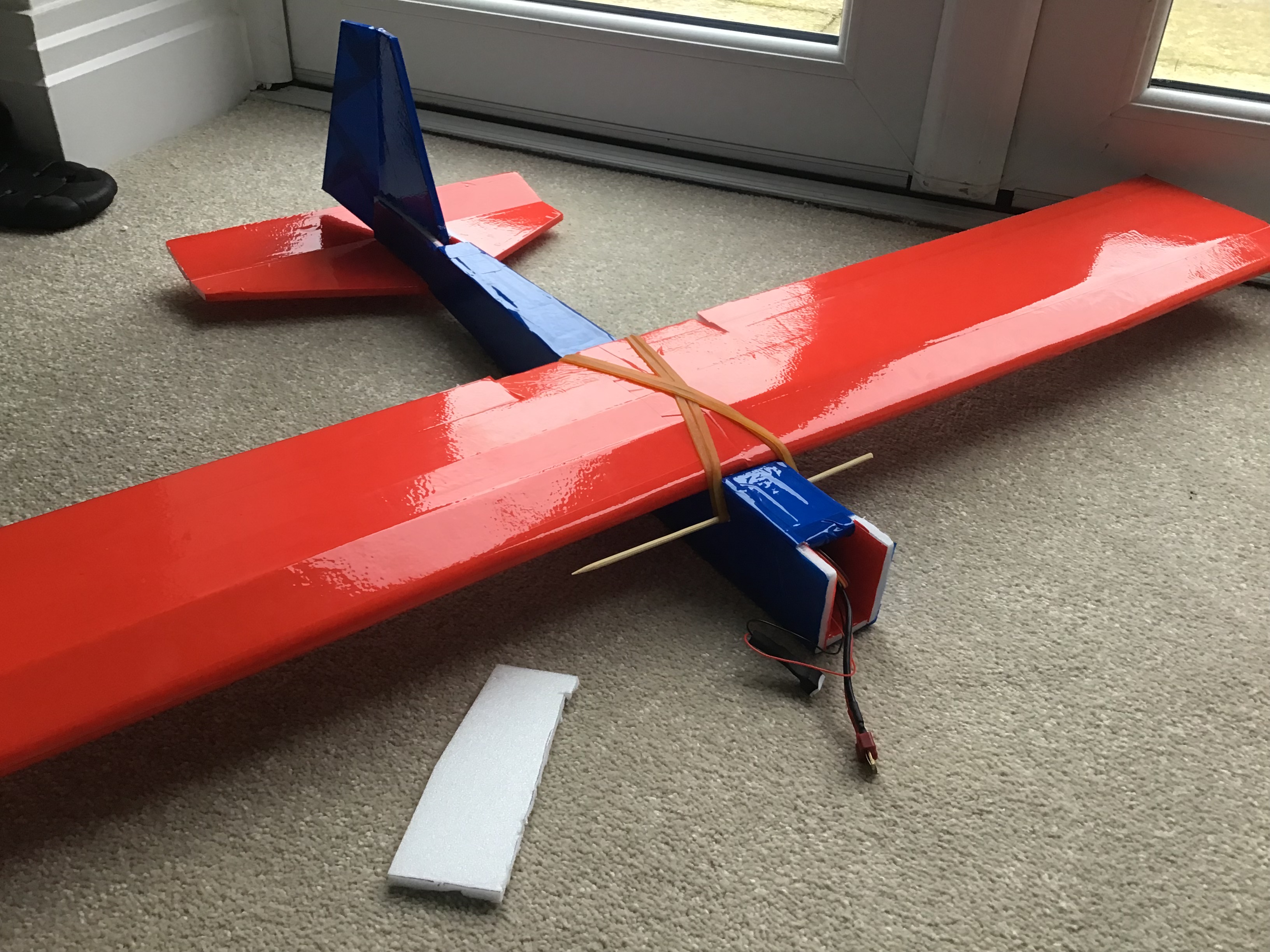

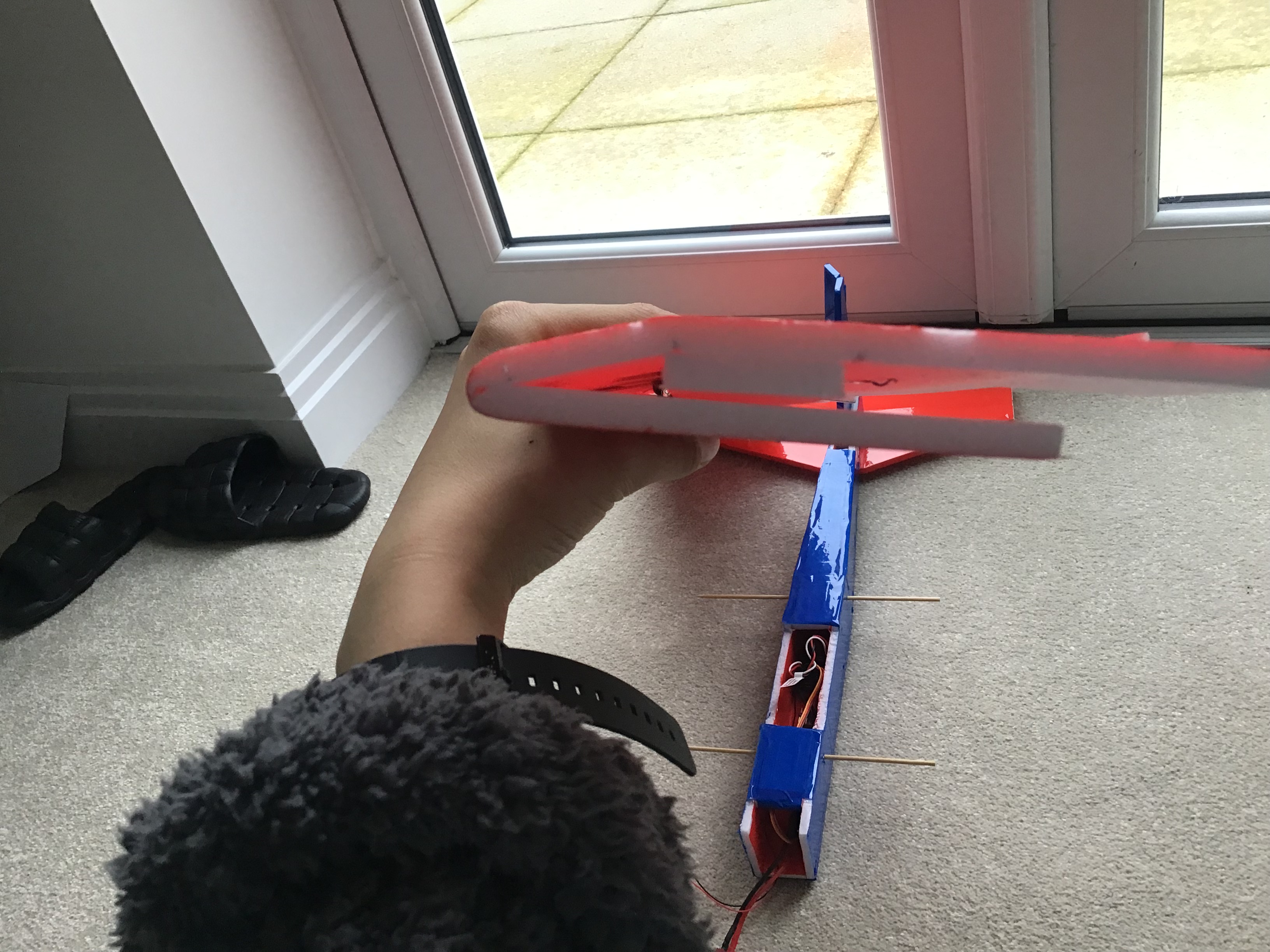

depron like polystyrene insulation, from uk b&q, this one is nice with tape covering and cytting and everything.
made a tiny trainer from the thing
