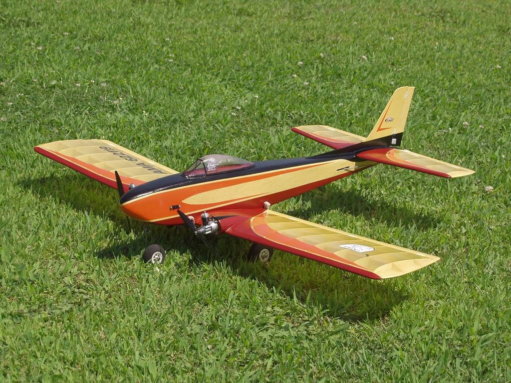

Was looking around at inspiration photos and ran across this Skylark variation ...
https://outerzone.co.uk/plan_details.asp?ID=1843
And even a 1s version! Nice covering scheme on this one too...
Hmm.... :unsure:

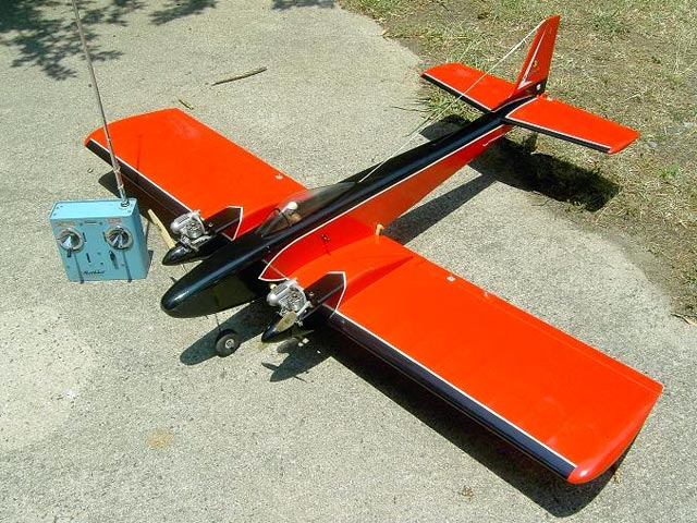

OMG a heathkit RC $ystem. I had one of those, once. Is this the midsize late 70's Falcon?
Goldberg did this 56" Twin Skylark in the mid-70's but I haven't been able to find a twin Falcon yet - if anyone finds one please share! :D

I LOVE twins and the twin version of the Skylark is on the plans. I just remember way back when that the local guys that built the twin said that all the twin added to the flying experience was weight and fuel consumption. Most converted back to single. That sucks because it looks good as a twin. I'll bet at this lighter weight and electric it'll make a much better twin.
Joe
The 049 one wasn't all that great because just getting 2 tanked 49's running at the same time was the first hurdle, didn't have remote tanked mods until 75 when they did Jerobee rc cars. They flew like an a Piper Aztec on one running: just enough power to crash.
A Falcon is just an inverted Skylark or vice versa. All the parts are mostly the same except for wing saddles.

My Dad flew a Twin Skylark 56 with two Veco 19s on it. It sounded wonderful when they were synced. He flew it through out the 80s until he sold it when he got out of the hobby. It was a great and stable plane.
