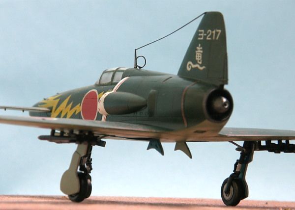

How do you all think I should do the vertical stabilizers for the shinden? It's going to be mini sized.
bwarz
not a full commitment at this time, but if I can I'd like to take a shot at a Vultee XP54 or XP68...
foamboard and oversized i'd say, then you can shave them down over time to see if they can be made more scale.
I’m mainly thinking about landing. It’s a bit small for good looking landing gear, and the vertical stabilizers hang down from the bottom of the wing:
Yes I see your point, you could embed a skewer or popsicle stick into the vertical stabs to strengthen them and then have wheels on the bottom. That would give you tail gear and then nose gear is just basic bent metal rod with a wheel on it which gives you tricycle landing gear so on landing you don't damage the rudders. I would say definitely aim to have the rudders a bit more above the wing and less below, I think a test model would help you find out what the best amount is for this, as in cut away at the bottom of the rudder until you can't do more and then just translate that ratio of rudder (vertical stab but that is longer to say) above wing to rudder below wing to your final design.
The problem with shortening the bottom of the rudder is that upon landing, the prop won’t clear.
