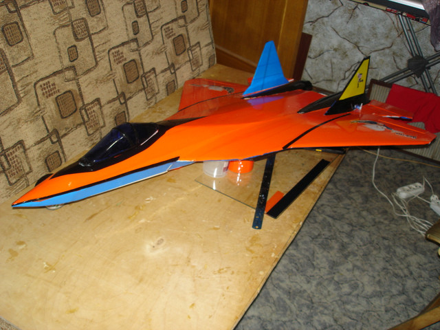

A package arrived with servomechanisms wire extensions, installed and sealed the top.I wrapped it with duct tape and an iron.
I'm a little disappointed- the model turned out to be heavy. The wing and top of the model would have to be sewn with foam 3mm thick.
The weight of the airframe is 520 grams, the weight of the battery is 180 grams, the planned weight of the regulator + motor is 100 grams.The planned flight weight is 850-900 grams.
Based on the planned flight weight, I am looking for a motor that I will order on aliexpress. I will seal the bottom after installing the motor and regulator . The battery will be inserted into the nose through a hatch in the lower part of the fuselage.

Oohf, I thought my plane was on the heavy size for its wingspan. 900g on, what is that, a 900mm wing span? It’s less than double the height of that sofa-back and I’m guessing the sofa back is only 500mm up from the seat. Hopefully that big curvy airfoil + blended body will supply enough lift to at least get slightly floaty. But inverted flight and high-alpha will definitely be tricky.
But otherwise, it looks really slick and with that glossy skin you’ve given it, I bet it will slice through the air at 90mph easily. Who knows, if you master it, the weight could be a bonus, it looks like it would handle a 20mph wind very well if flown right.
