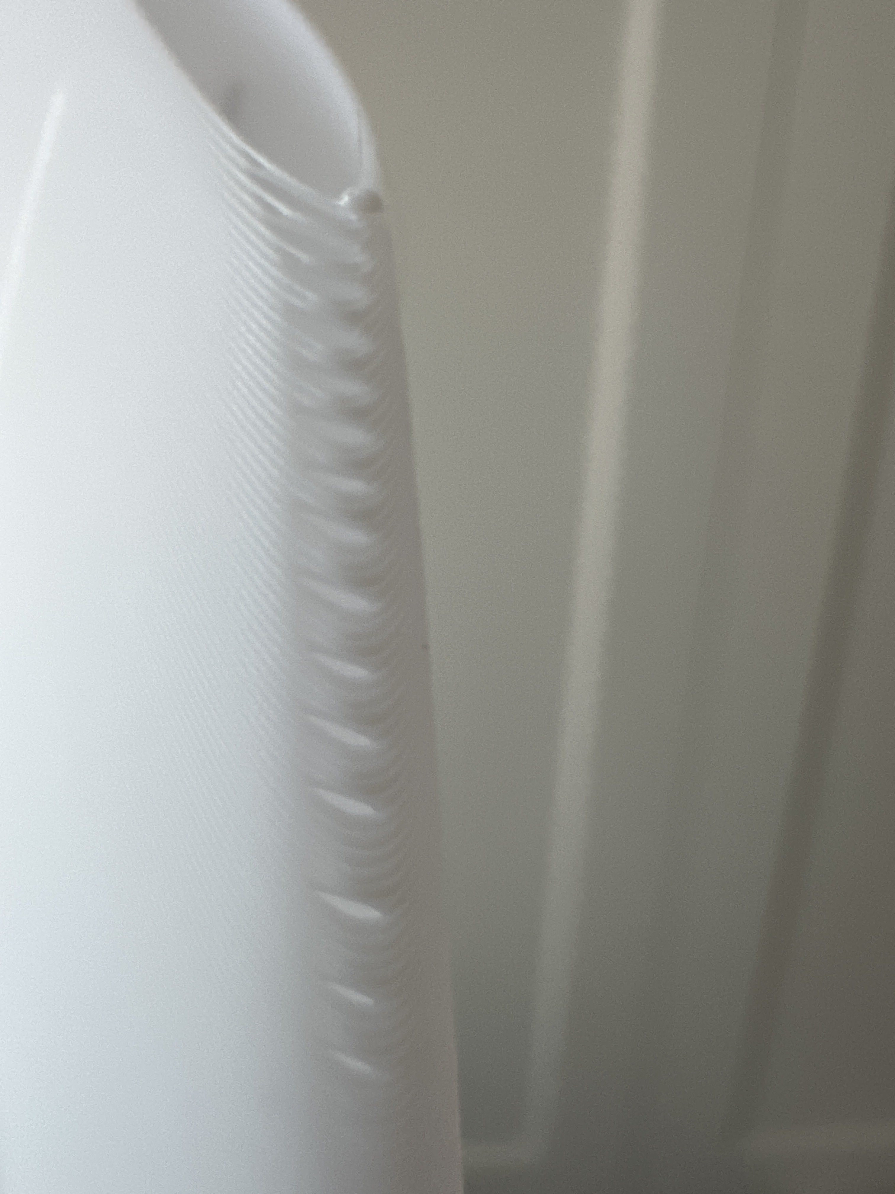

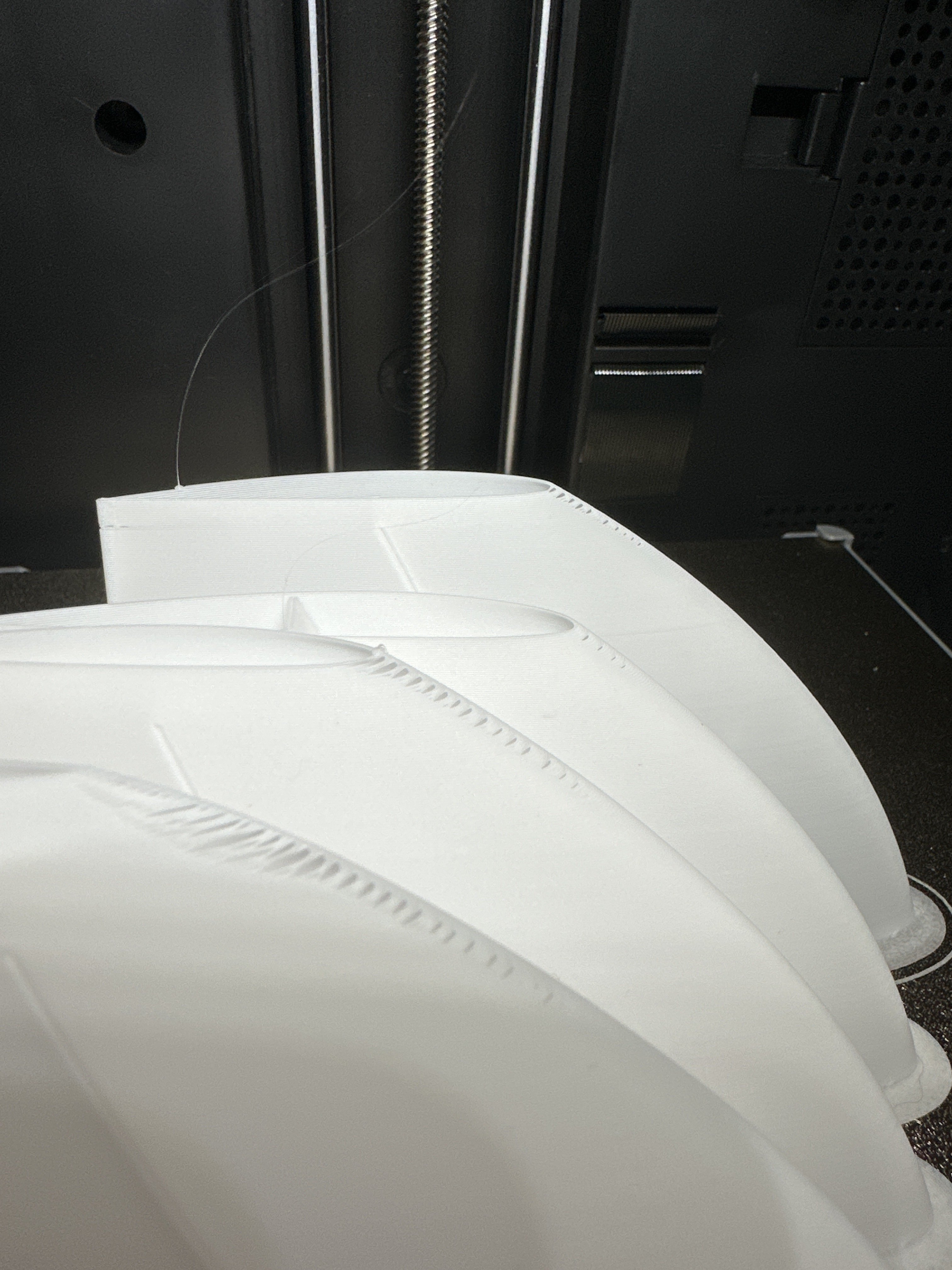

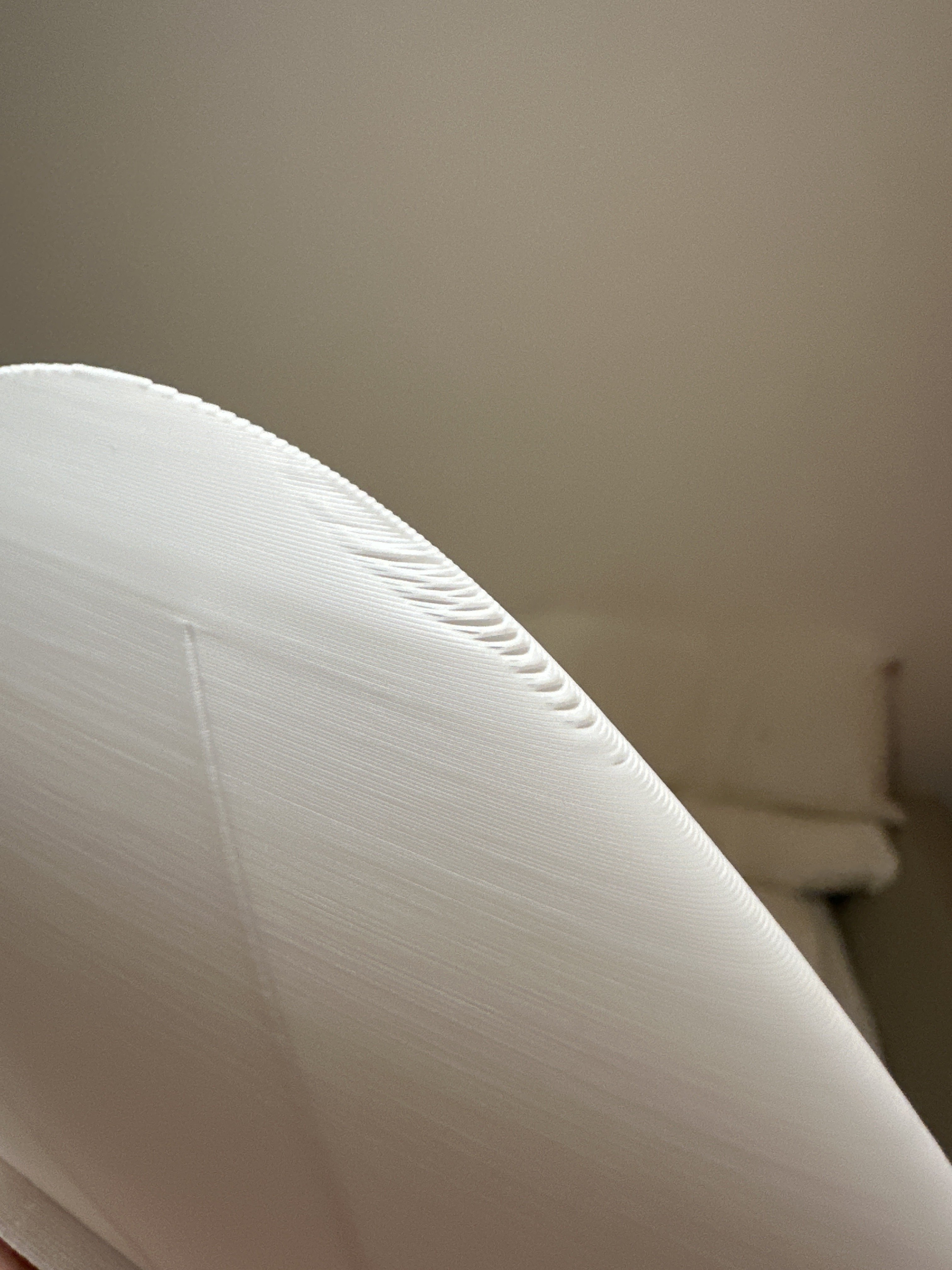

Hello everyone!
I’m new in 3D printing, just bought Flashforge Adventurer 5M to fulfill my dream - to build a RC plane. I use Orca Slicer and JAYO PLA. Everything is OK until the end of the wing, and than… Nothing helps. Variable temperature, Flow rate and so on give me the same trouble 🤔
Could you please help me?
