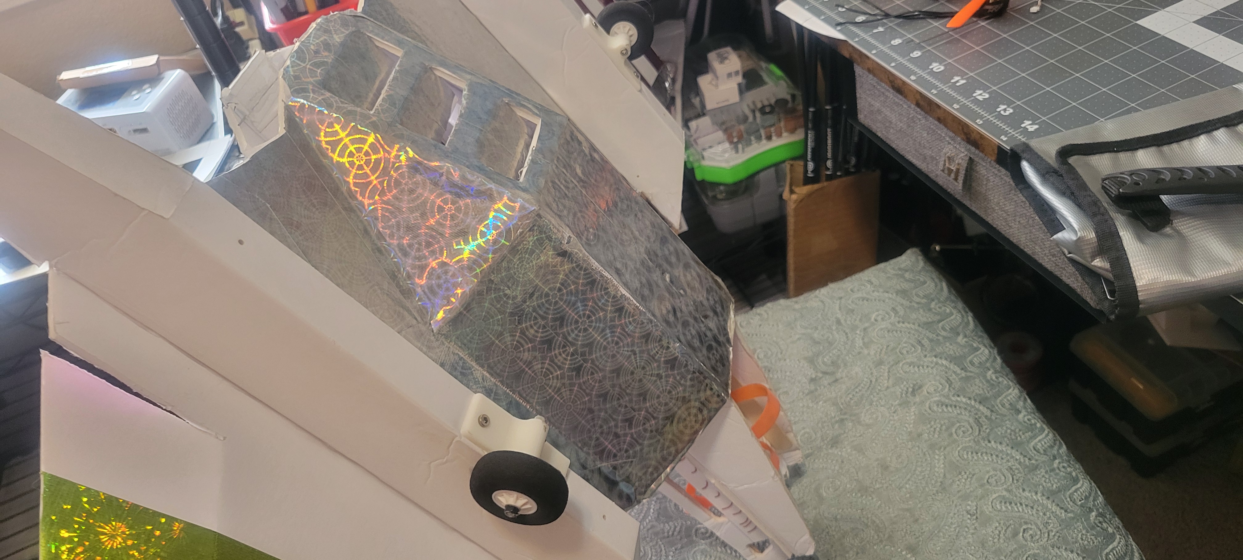

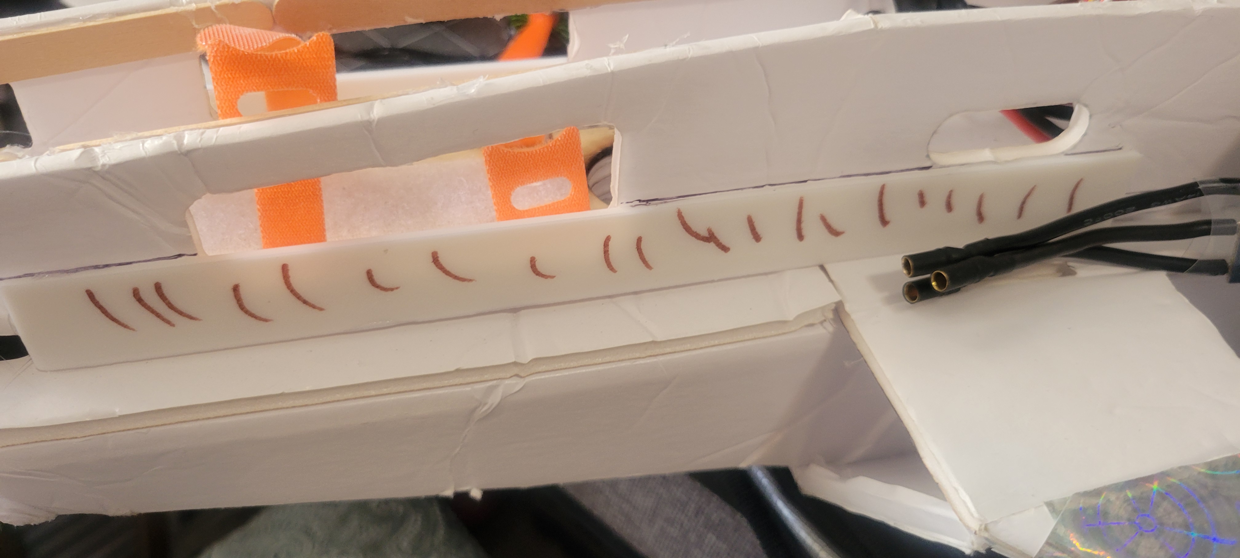

I am thinking of 3d printing some skids for landing to protect the belly and nose,
does anyone have any intel about if this will work or not?
RickHunter
Skids are definitely the way to go if you have a 3d printer. I do that on all my belly landing models. Quick and easy. I have 3d printed landing gear on my Boomin Flerken, but don't think they will work on the regular one. Also print that reinforcement I was talking about too. I'll post a couple pics. I marked the reinforcement part I printed with sharpie.
