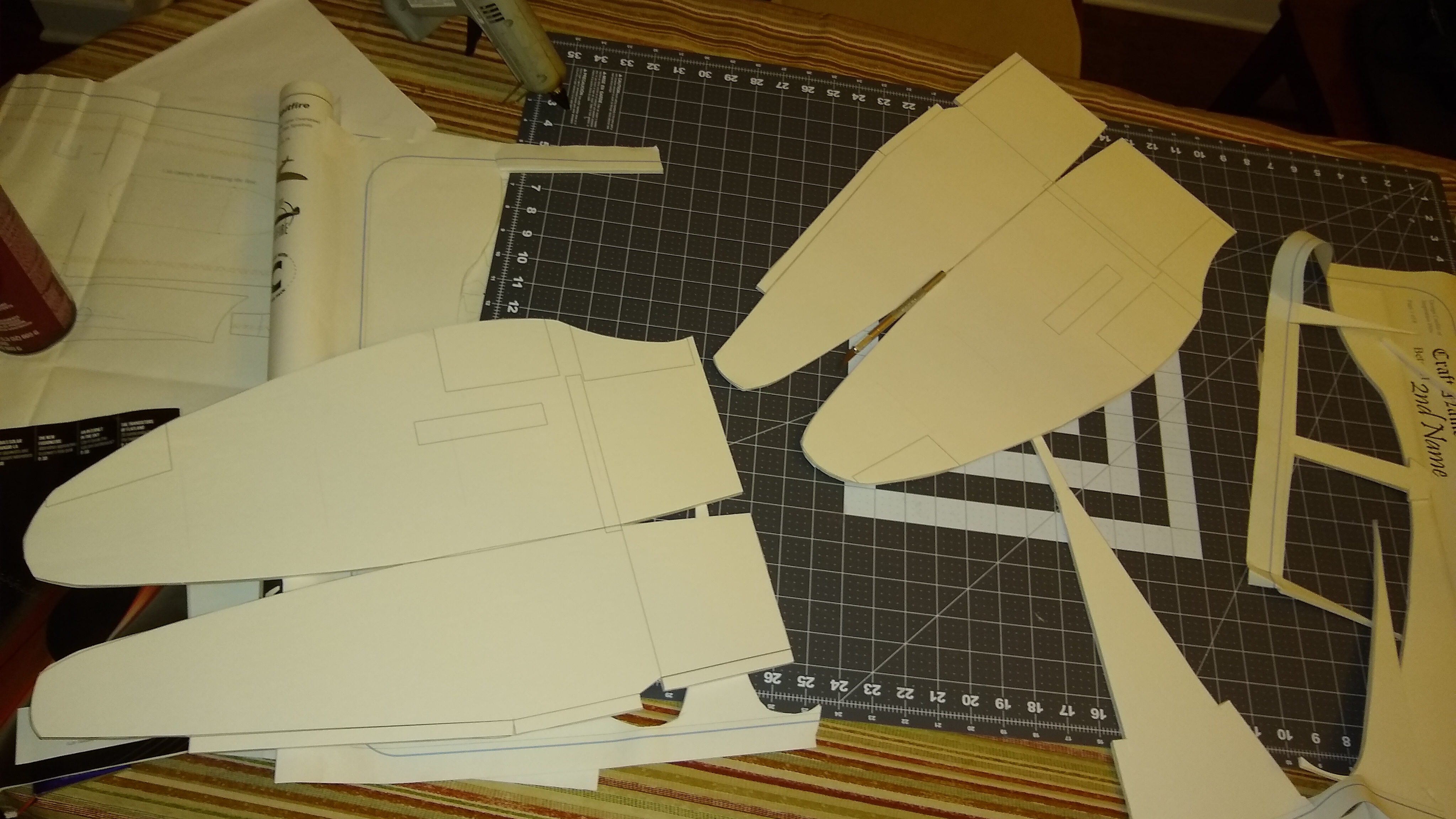

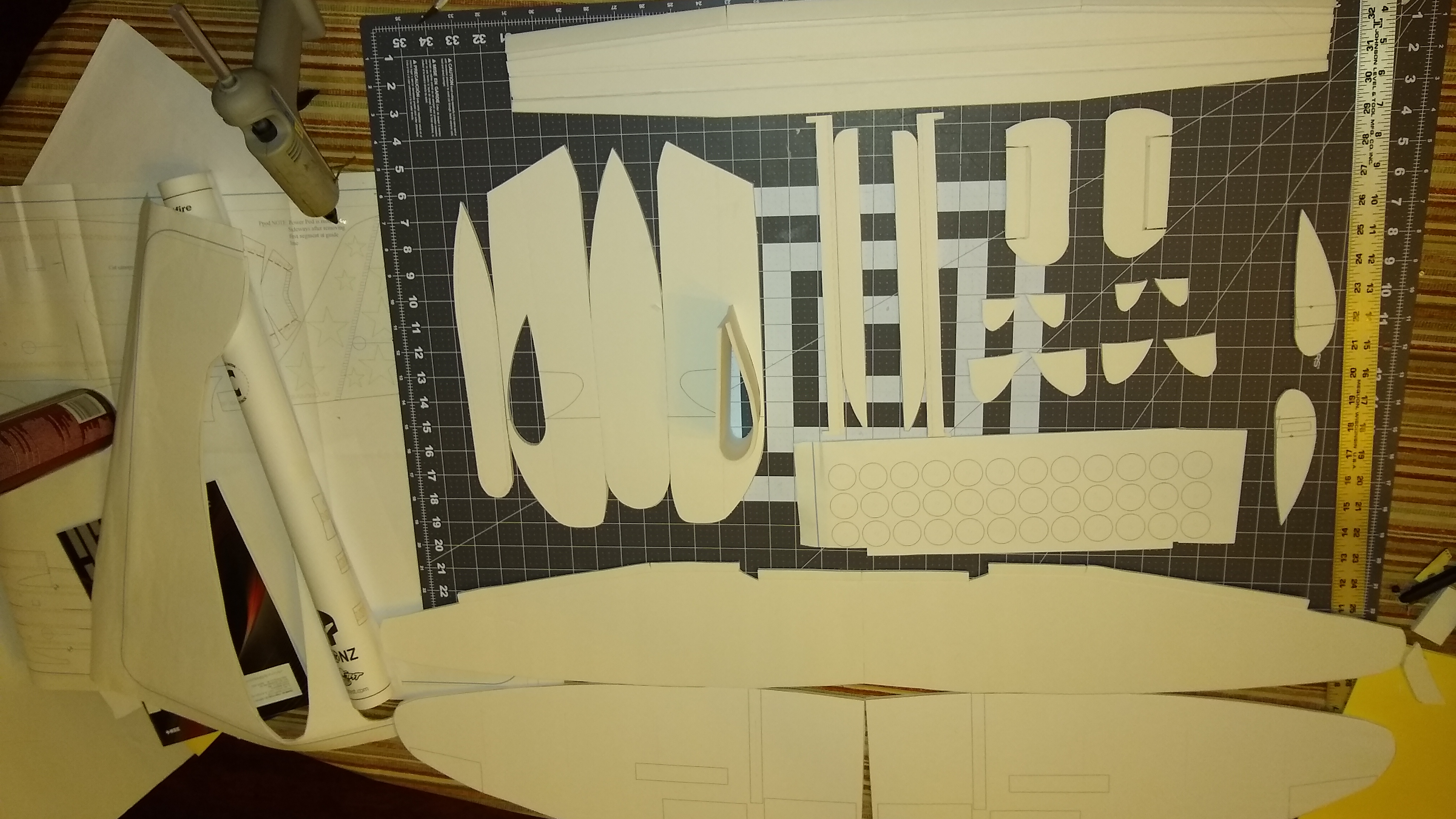

I am pulling the plans from the Flite Test Article. I have a 30mm edf I want to use, and I printed these out both 1/2 and full scale. I will build this with curved and ironed parts for a more true form.
2/3/2020
I mounted the plans and cut out the parts. (Unfortunately I may need to do something with the pod to fit the 30mm EDF.

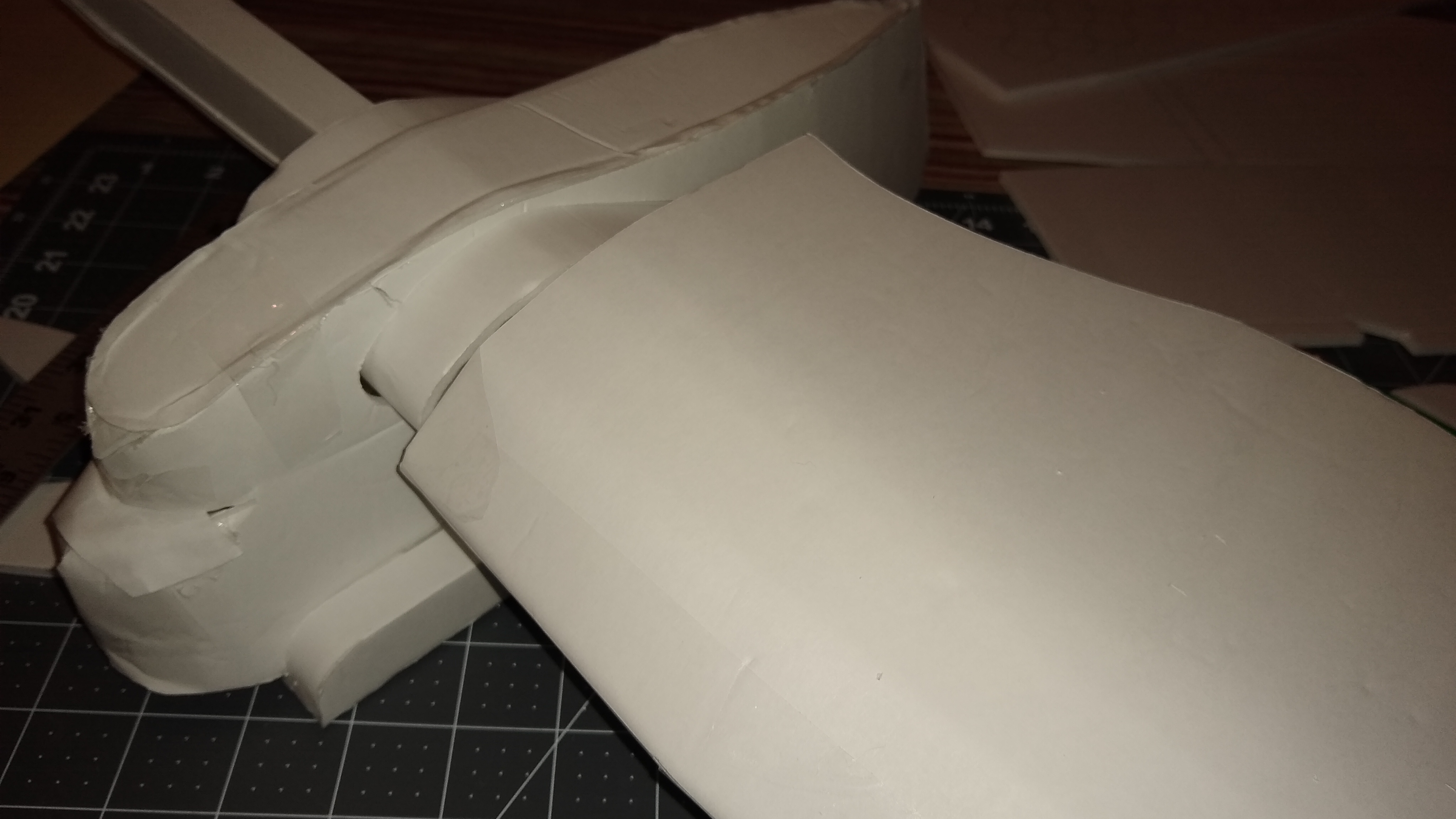

on Saturday 2/15/2020
then I started putting it together, and I have some design work to do
You can see the crack from box spar insertion. As this is a rough draft, the plan was to have the wings friction fit into the center section once I box the spar in, I will split it in the center, Then I will glue the spar into the wing.
