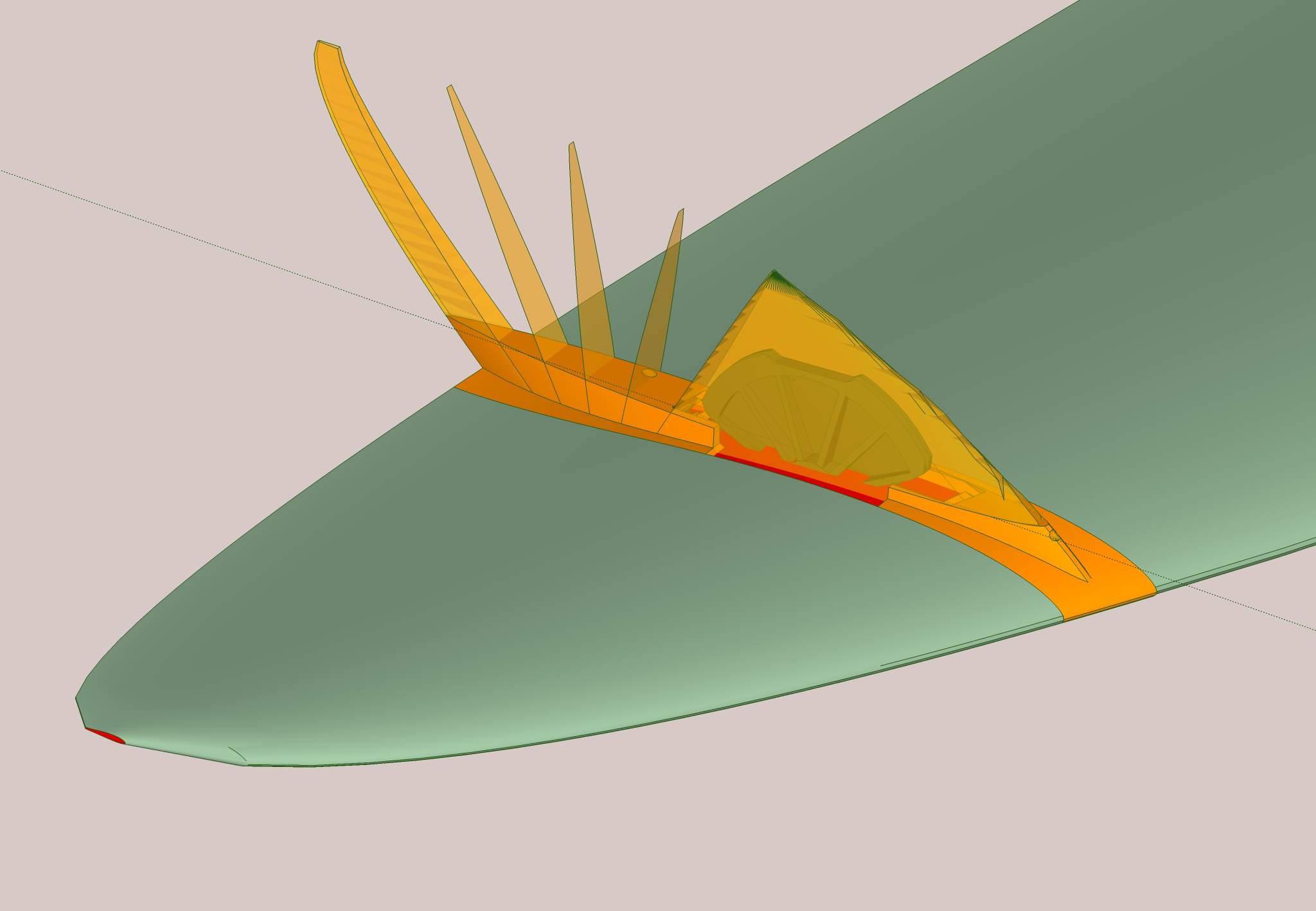

Boomerang is a flying wing, sailplane with the following design features (at this time):
I'm allowed to change my mind due to input from any of you willing to give me constructive criticism or from the inner voices that haunt me.
By all means... please share some of your wisdom.
Back to challenge...
- Minimize weight - As I'm spec'ing two sheets of DTFB, the skin weight will be around 200 mg. I haven't analyzed for spars yet.
- Maximize span - I doubt bigger is necessarily better, but I want it big... with the two sheets of DTFB, my initial span is 3m (~120in).

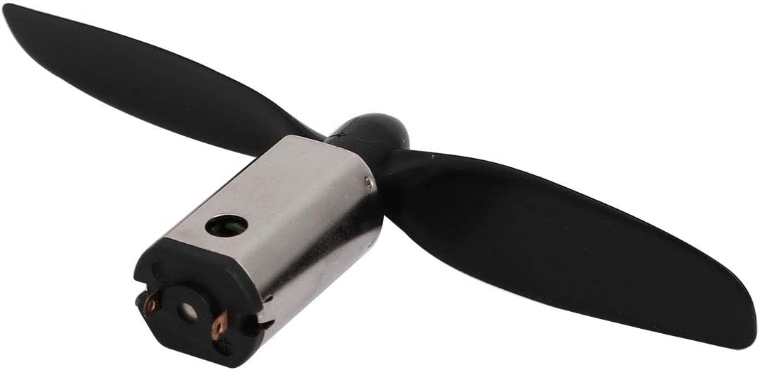

- Minimize power - Although the jury is still out, I'd like to see if I can do this with a 1S power system using the all-in-one micro boards with receiver, servos and brushed ESC.

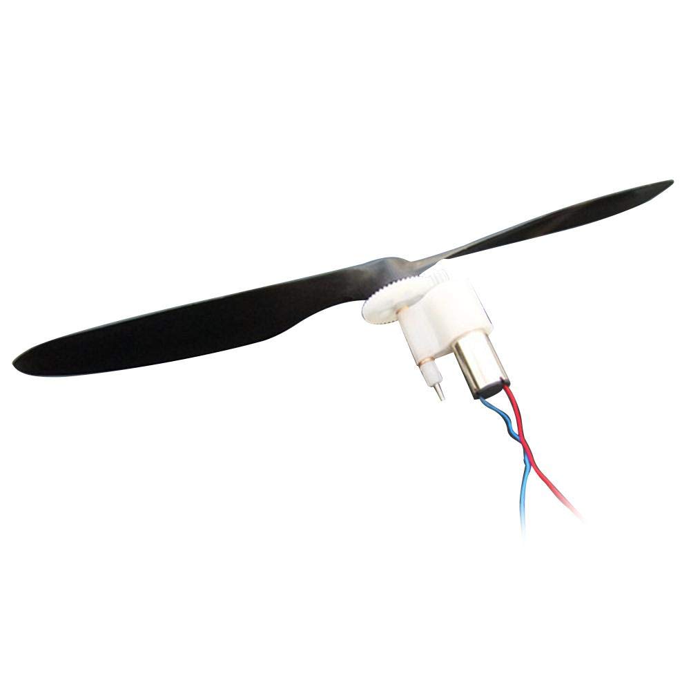

- Propeller - It will be a pusher design with folding propeller. Size TBD
