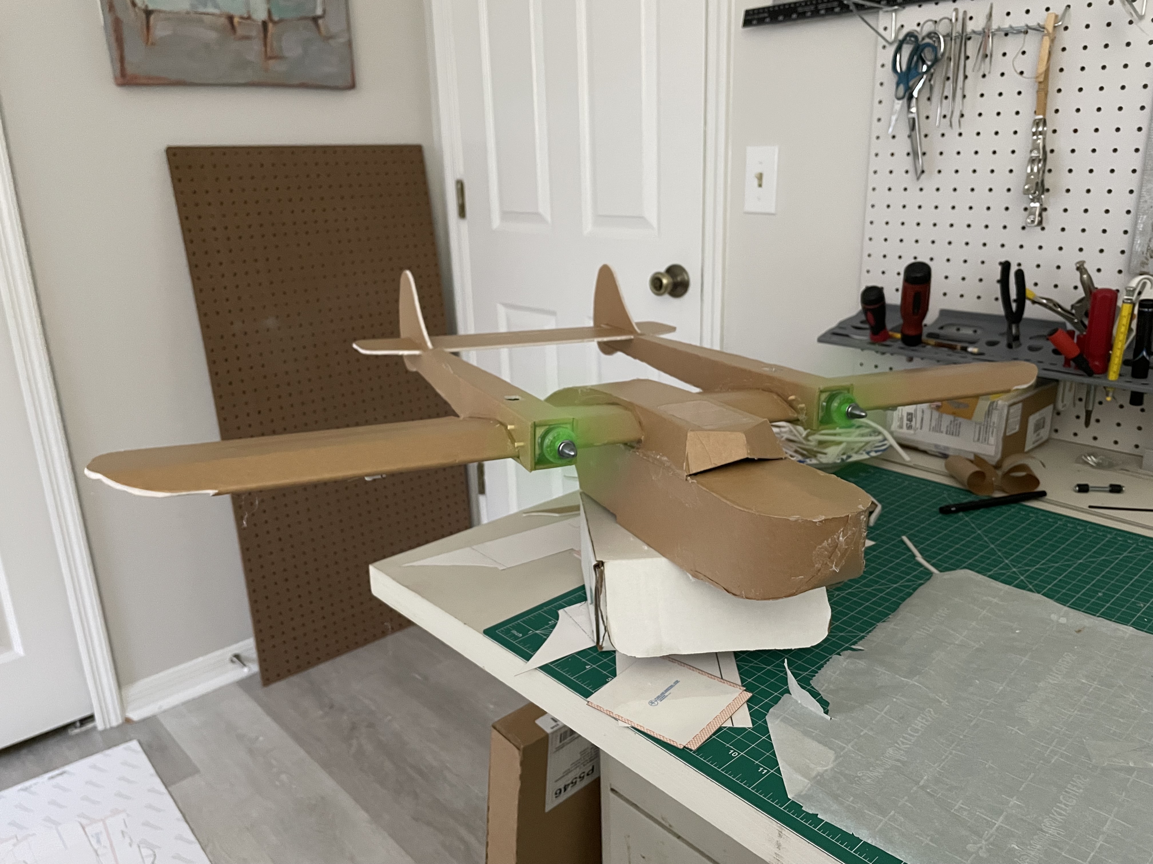

Trying to put the c pack 2205 2300kv motors on. The wires have some heat shrink at the base of the motor preventing me from slotting it through the holes in the mini firewall. I can drill new holes in the firewall to get it to fit, but has anyone ran into this issue? Could I leave the wires running over the top and conceal it with the cowling? What did you do at this step?

iceking1152
Obligatory progress pic for asking so many questions. The video glosses over making the power pod. Can someone post a pic of theirs? I figure the position of the firewall is critical to the thrust angle, so I’m not sure f it should line up with the bottom part of the u on the firewall, or sit above it?
You can file/sand/nip/grind the hole to make it larger. Also, a hair dryer can make the insulation on the wires a little more flexible. Be careful to not melt anything of course.
Horseman3381
Looking good!
For the powerpods, since this is a twin engine, there is no thrust angle built into the power pods, so don't need to worry about that. The pods should be same size of the firewall. If they are a bit off, I would do your best to either center it on the pod, or offset it to the bottom of the U. Either would be fine.

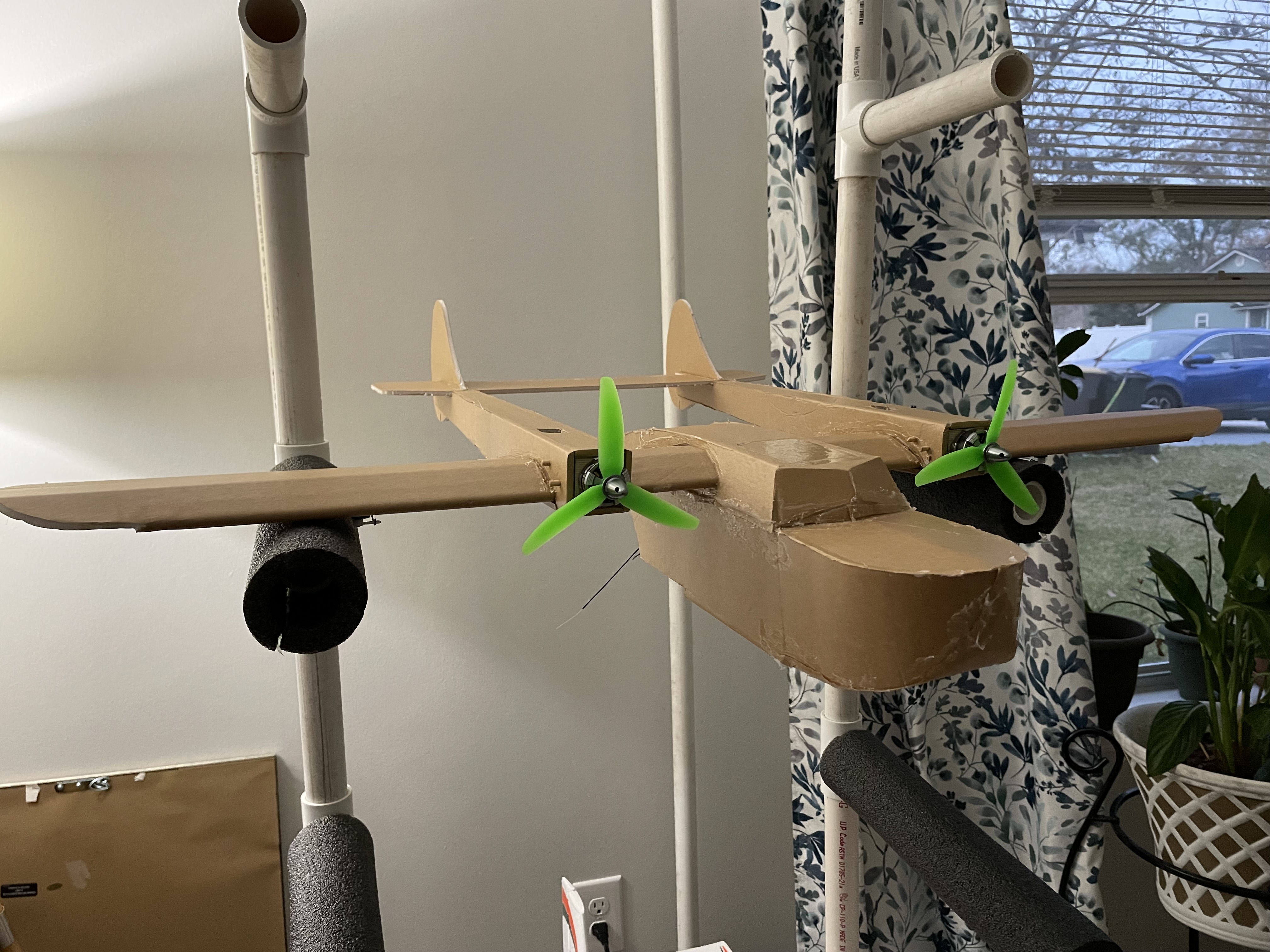

iceking1152
Maiden flight went well. A member from my club helped me trim it out and hand launch after the initial grass takeoff didn’t go. The video didn’t come out well, I accidentally had it in slow-motion. Thanks everyone for your help and suggestions for getting this built. I noticed off the bat that 100% rates were way too much, I felt comfortable around 75% and eventually added 20% expo. This is my first plane without any gyro whatsoever, and I managed to get it down undamaged in 2/2 flights today. I’m very happy with how it performed!
It's a sturdy plane. I bounced mine more than once without damage.
