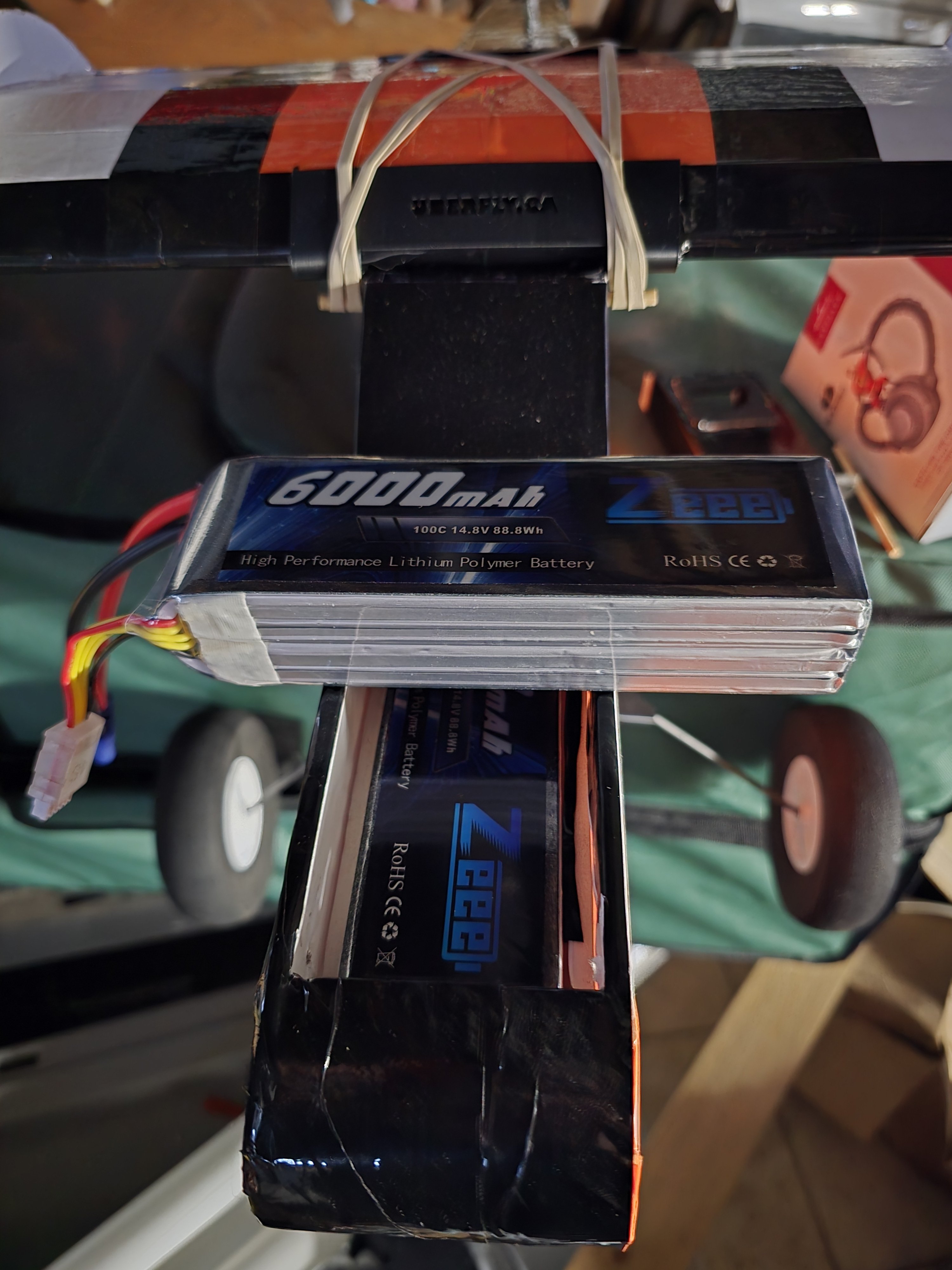

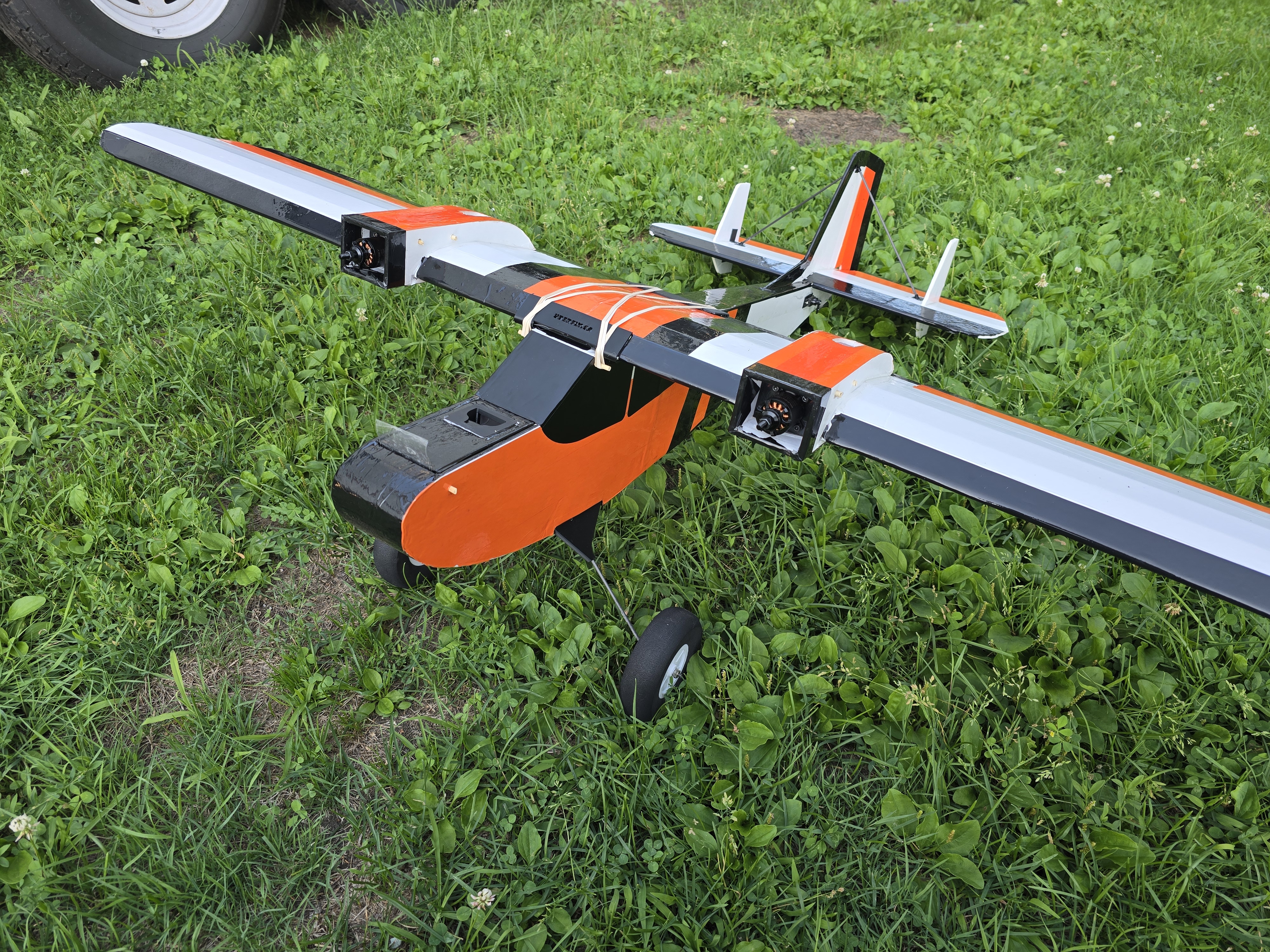

Hey folks how did y'all dial in the CG on this bird? Mine is an SBK and I have two 4s 2300 batteries as far forward as I can get and shes still tail heavy. Aside from some 3d printed very lightweight Sp0nz servo mounts in the fuselage its pretty much as it would be from the kit. I built mine as a twin engine and did put the servo in for the bomb bay. If the simple answer is that I gotta add more weight then does anybody have a recommendation for a big old brick of a battery? Might as well add a little flight time rather than dead weight. Heres another pic of my wing tape livery to catch your attention lol.
